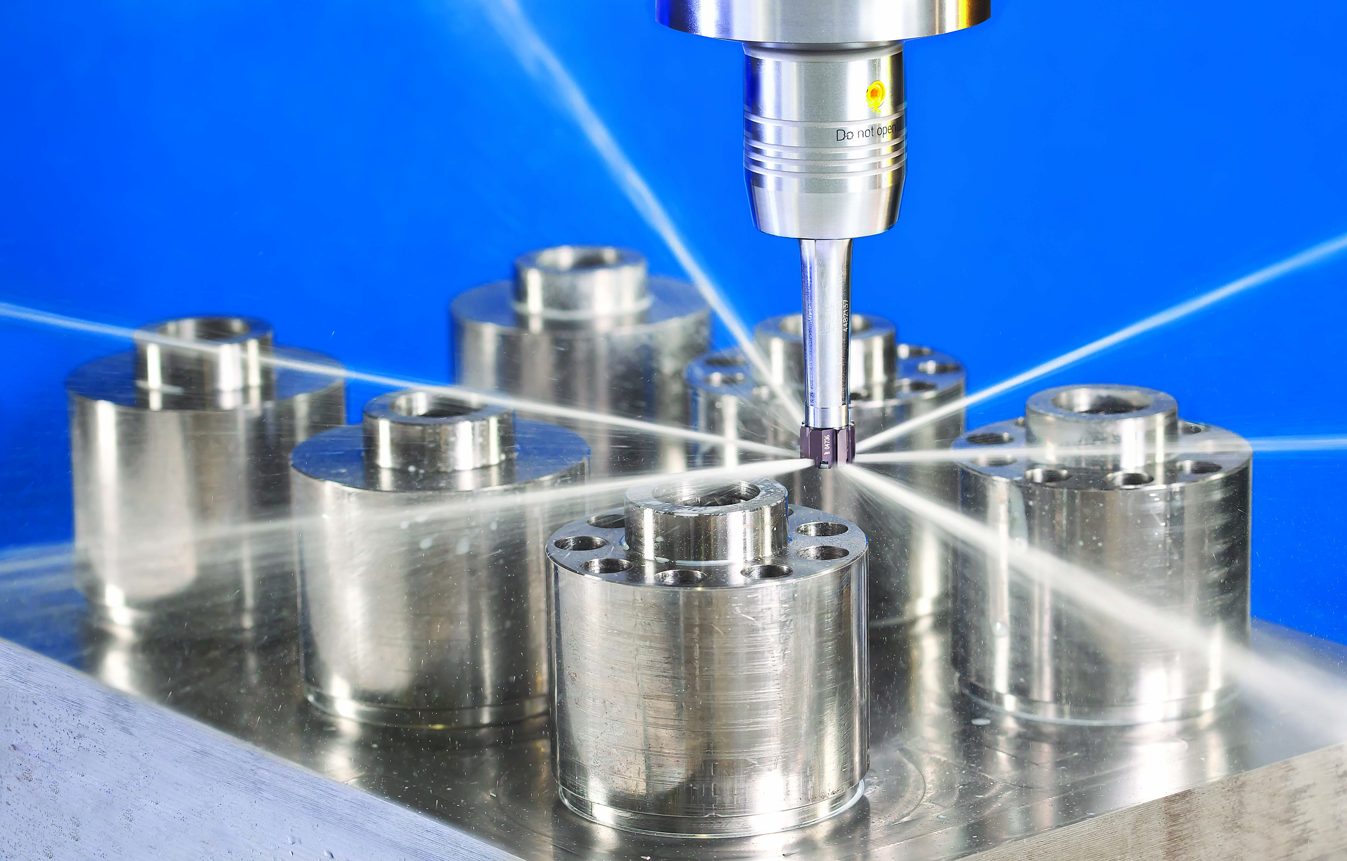

Bayo T-Ream offers interchangeable solid-carbide heads for high-speed reaming applications. A through-the-tool coolant system delivers lubrication directly to each cutting edge. Image courtesy of Iscar Metals
Basic Considerations
If reaming is necessary after all, he said a solid-carbide reamer usually can handle small-to-medium-size production runs. For higher-volume production, he recommends something like Iscar Metals’ Bayo T-Ream, a multiflute reamer consisting of a solid-carbide head mounted to a steel shank. Covering a range from 11.5 mm to 32 mm (0.453″ to 1.26″) in diameter, Bayo T-Ream offers the speeds of carbide rather than high-speed steel, he said, as well as good repeatability when the head is replaced.
“For medium-to-high-(volume) production runs,” Ewing said, “you get very fast metal removal rates for the reaming operation and also a very high-quality hole in many instances.”

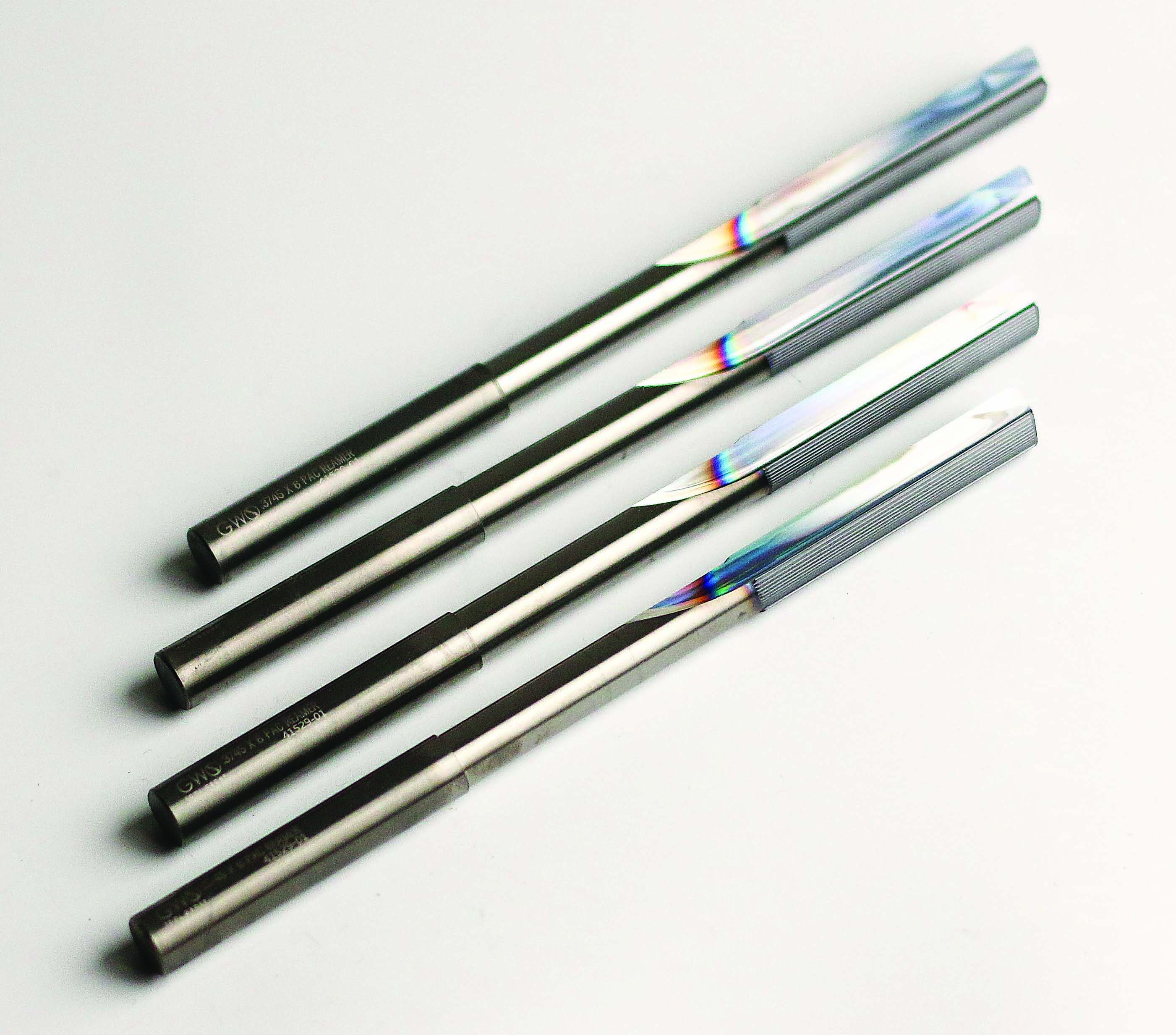

“We want to use as many flutes as possible because that helps with the finish,” said John Kiiffner, Northeast director of sales at GWS Tool Group in Tavares, Florida. “The more surface contact we have when reaming, the better.”
The number of flutes that a reamer can accommodate is based on its diameter. For example, he said GWS Tool Group might be able to put up to three flutes on a 2 mm (0.079″) dia. reamer, but the number could go up to 11 on a 20 mm (0.787″) dia. reamer. He said it’s typically a good practice to put an odd number of flutes on a reamer because this reduces its tendency to lobe a hole.
“With an odd number of flutes,” Kiiffner said, “you get a more precise round hole than if you use an even number.”

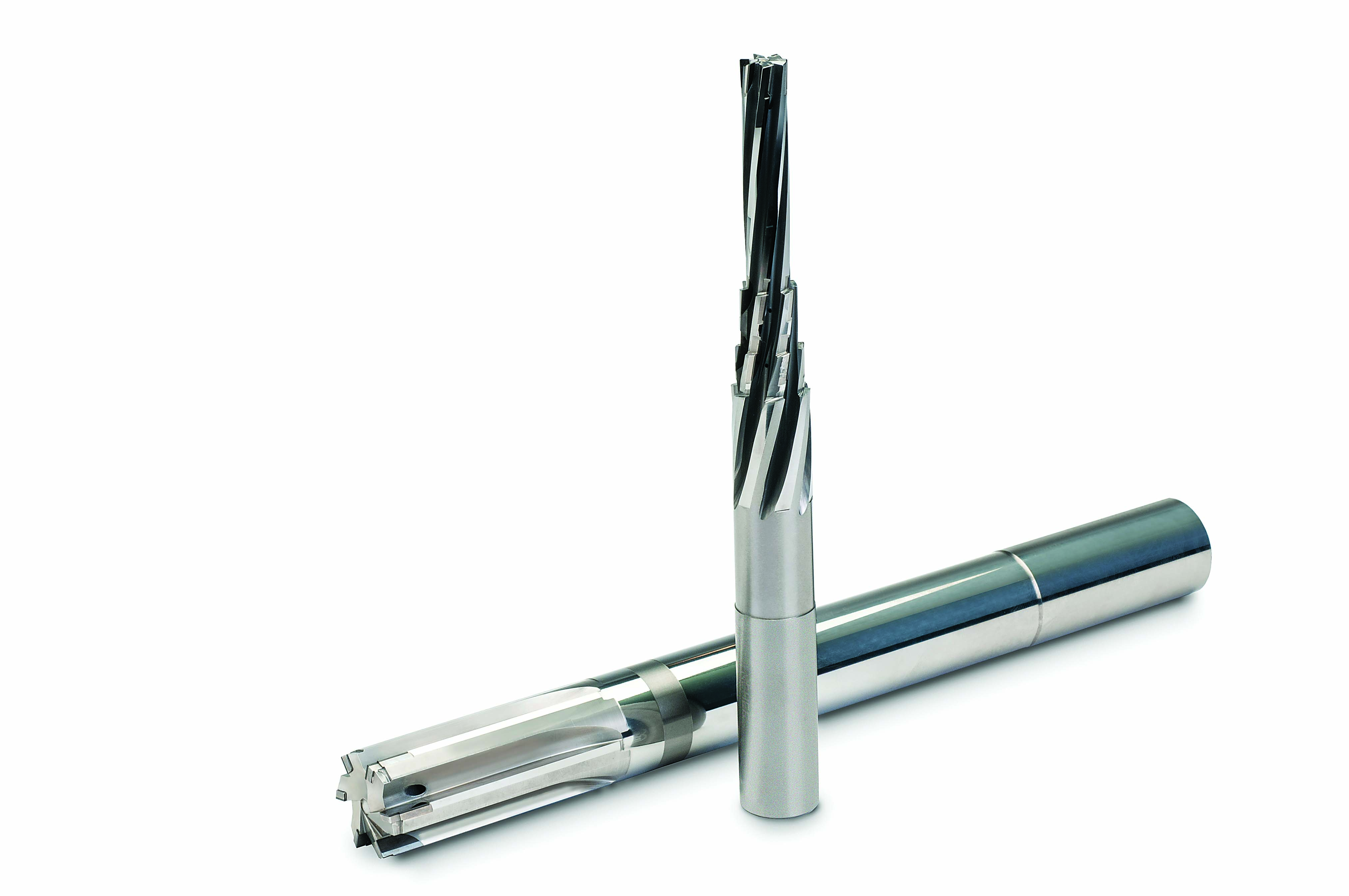

A replacement for chucking reamers, PAC reamers are designed to ensure straightness regardless of the pre-drilled hole while maintaining hole size and finish. Image courtesy of GWS Tool Group
In addition, custom reamers cost more than off-the-shelf options. But Dunneback said custom tools are more economical in the long run.
“Generally, because our tools are custom-built and we apply the proper coatings based on the materials used, they will (provide) more linear distance of cut than a standard reamer,” he said. “So they should be less expensive (overall) but with a little higher upfront cost.”

Although reaming technology hasn’t changed a lot in recent years, there have been developments that reaming tool users should be aware of. One is the increasing popularity of monoblock tools. Kiiffner said “monoblock” refers to the fact that the tools are built on the toolholder, so no clamping is involved.
“Typically,” he said, “when you clamp something, you are going to induce runout.”
So the purpose of creating a one-piece reaming tool is to minimize runout.
The downside, however, is that it’s “very costly” to make tools this way, Kiiffner said.
