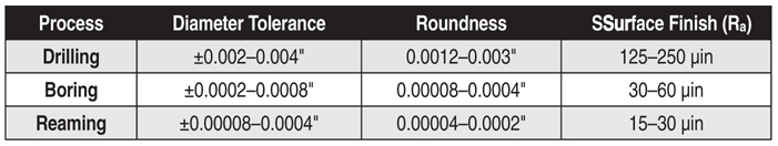

table of Process
Drilling is primarily a hole-making operation, not a sizing operation. Boring offers the best control over geometry and true position, with the ability to correct location errors. Reaming delivers the tightest size and surface finish but cannot correct location errors.
