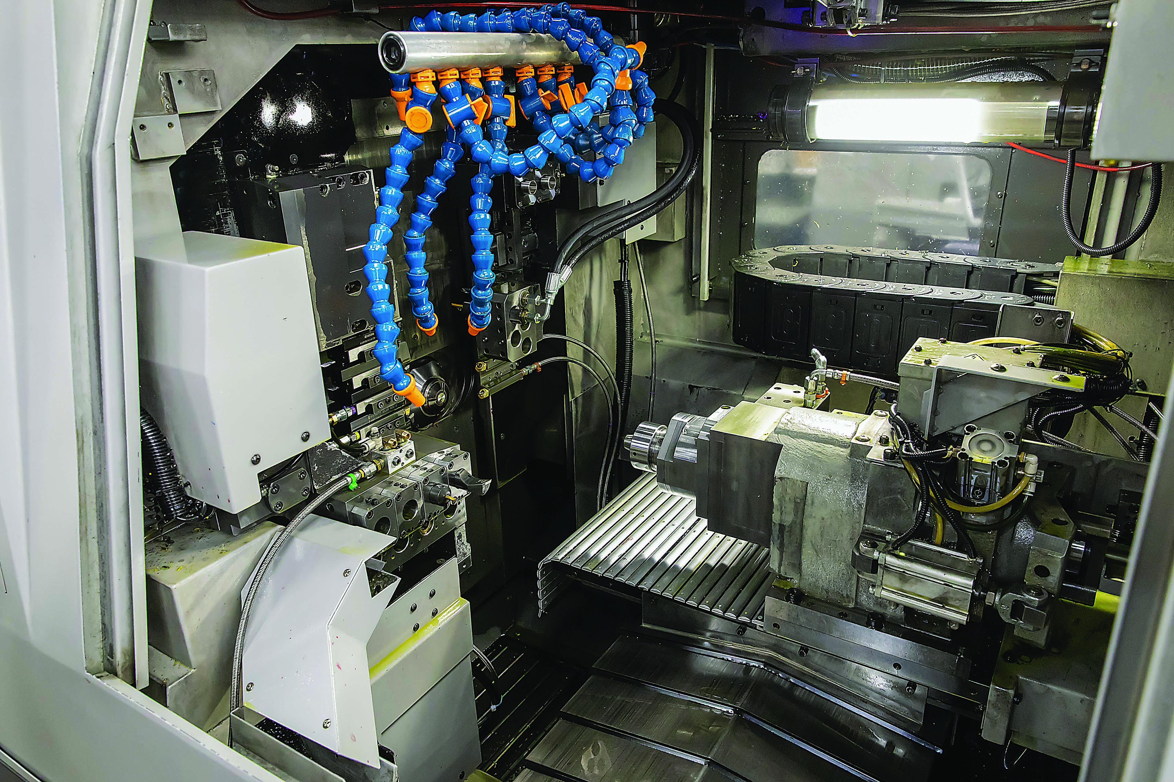

This Tsugami B0326-II machine tool is programmed with Esprit CAM software. Image courtesy of MacKay Manufacturing

These modified handles and adapters (left) were programmed with Esprit CAM software and machined on a Tsugami B0326-II machine tool. These L-tip parts (right), which are for a device used in endoscopic surgeries, also were programmed with Esprit and machined on a Tsugami B0326-II. Images courtesy of MacKay Manufacturing
“The Tsugami lathes allow us to meet the requirements for increased parts production,” Compton said. “Their relative ease of use and durability have given us the ability to meet growing demand.”
For example, MacKay makes a small L-tip part for an endoscopic surgery device. The company initially ran the part as a lathe blank, meaning that all the round features would be run before sending the part to the milling department to cut the L shape. The lathe blank ran for a minute and a half on a Tsugami BS20 and then for an additional five minutes on a mill.
In the years since taking on the project, MacKay has acquired new cutting tool technology and speeder heads. Combined with increased knowledge of what is possible on a Tsugami B0326-II CNC automatic lathe and in Esprit, the company felt confident enough in 2017 to make the part using only a B0326-II.
“We can now machine this part in under three minutes and make a far better part than we had previously,” Compton said. “We have since taken on two other parts in this part family and make them entirely on the lathe as well. We couldn’t have done this without Esprit and their technical support, nor could we have done this without the capability of the Tsugami lathe.”
