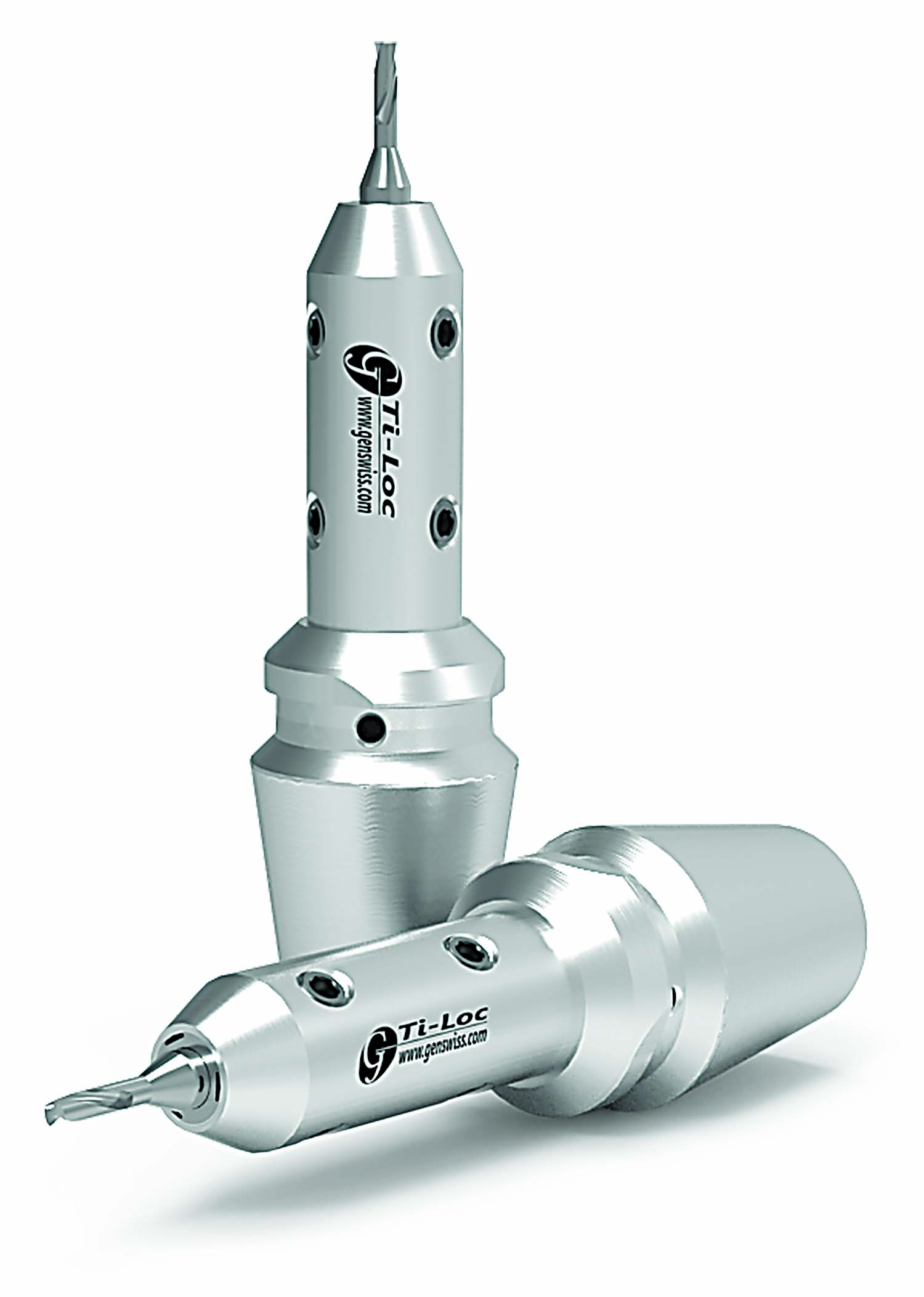

These Ti-Loc extensions make it easier to reach a part in tight clearance situations. Image courtesy of Genevieve Swiss Industries

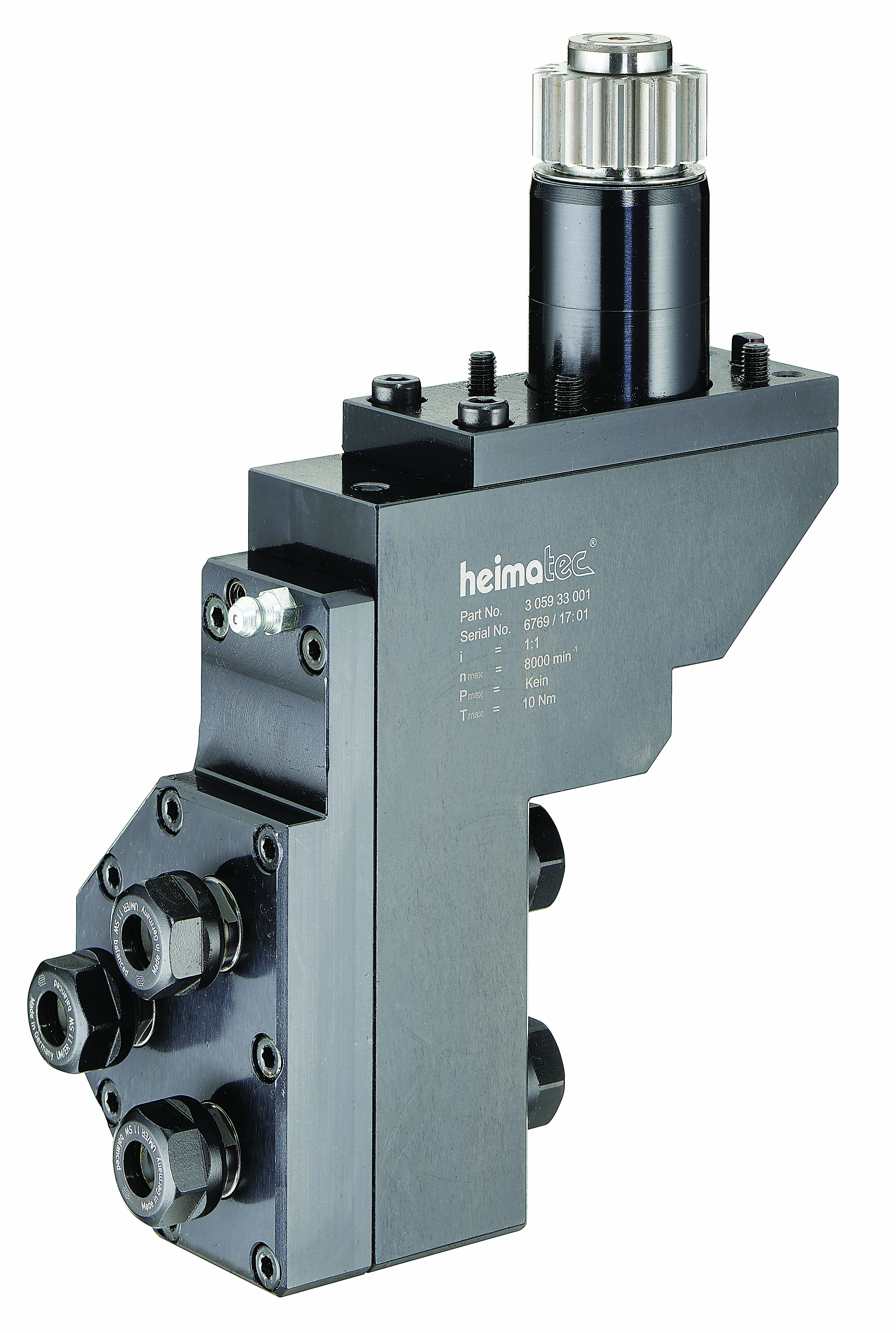

Although the company’s name has changed from Heimatec Inc. to Platinum Tooling Technologies, it remains the exclusive importer of Heimatec GmbH tooling in North America. Image courtesy of Platinum Tooling Technologies

With Swiss-style CNC lathes becoming more popular, Scott Laprade, applications and technical sales representative at Genevieve Swiss Industries Inc., Westfield, Massachusetts, pointed out that the number of tooling choices available to lathe owners is on the rise.
“For example, we’ve recently expanded our live tool offering with compact, planetary-geared drilling and milling attachments that offer much higher spindle speeds and consume less space in the machine’s working area,” he said. “With that, we offer a range of quick-change, ER-style Ti-Loc extensions that make it easier to reach the workpiece in tight clearance situations.”

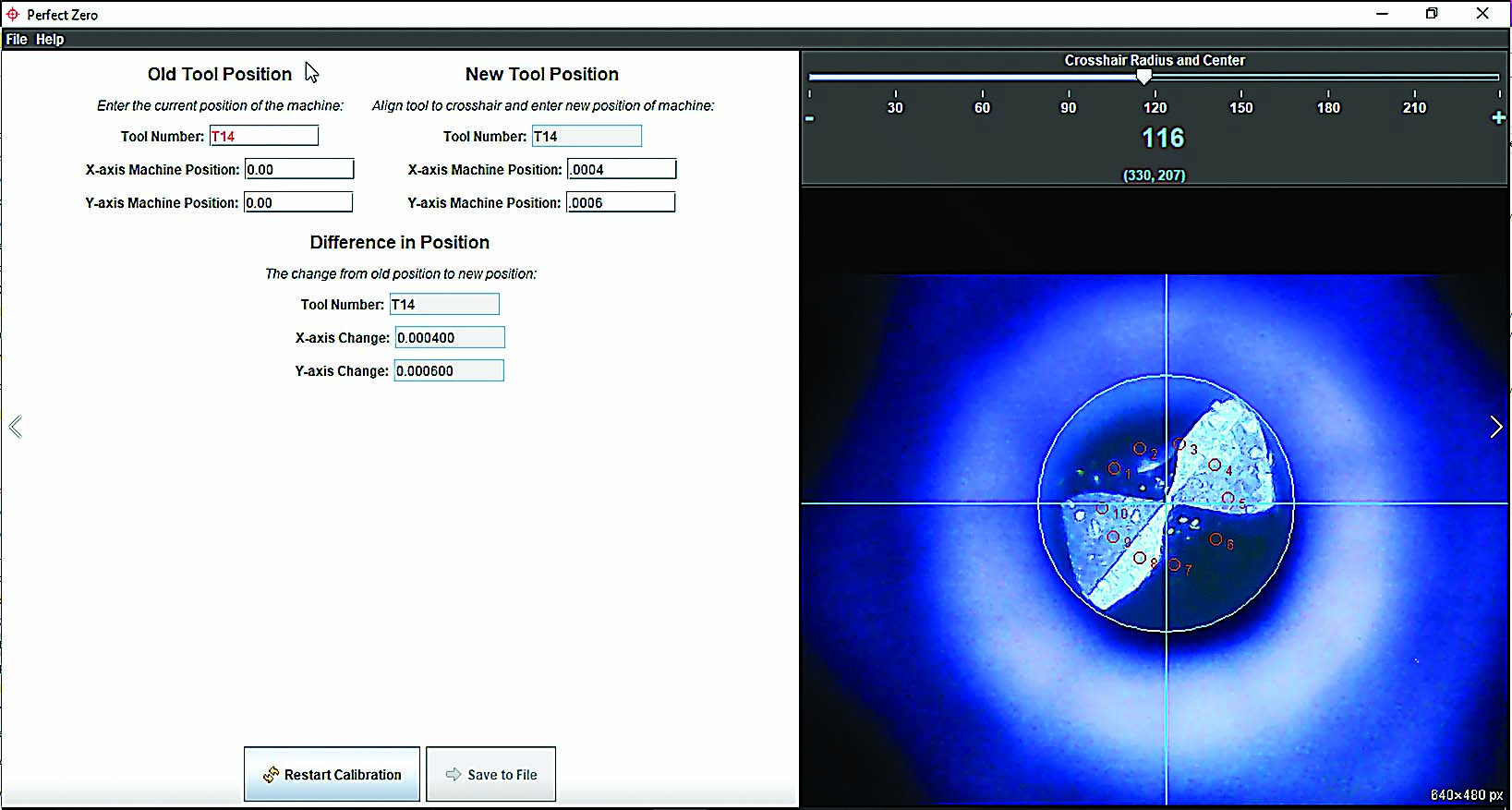

GenSwiss’ Perfect Zero system helps machine operators correct tool alignment problems. Image courtesy of Genevieve Swiss Industries
Getting tools exactly on center normally could be a challenge for Swiss machines, especially with tiny boring bars and drills, where even the slightest deviation from centerline can mean a broken tool. But Laprade said GenSwiss’ Perfect Zero alignment system solves this problem.
“The kit contains a laptop with pre-loaded software and a camera that goes in the guide bushing,” he said. “You call up a tool, align it with the camera’s crosshairs and instantly know how much misalignment is present. You can then make an offset to correct it or a mechanical adjustment if necessary. And for rotating tools, there’s a calibration process you can use to minimize runout or eccentricity.”

Platinum Tooling Technologies Inc., Prospect Heights, Illinois, is another Swiss-oriented tooling distributor. President Preben Hansen explained that he recently rebranded his company, Heimatec Inc., to expand his nearly decadelong exclusive relationship with Heimatec GmbH, Renchen, Germany. Heimatec GmbH’s live tooling line now includes live and static tools for Marubeni Citizen-Cincom machines, and Platinum Tooling Technologies also offers Swiss collets and guide bushings from Tecnicrafts Industries and IB spindle speeders from Suzuki Precion Co. Ltd.

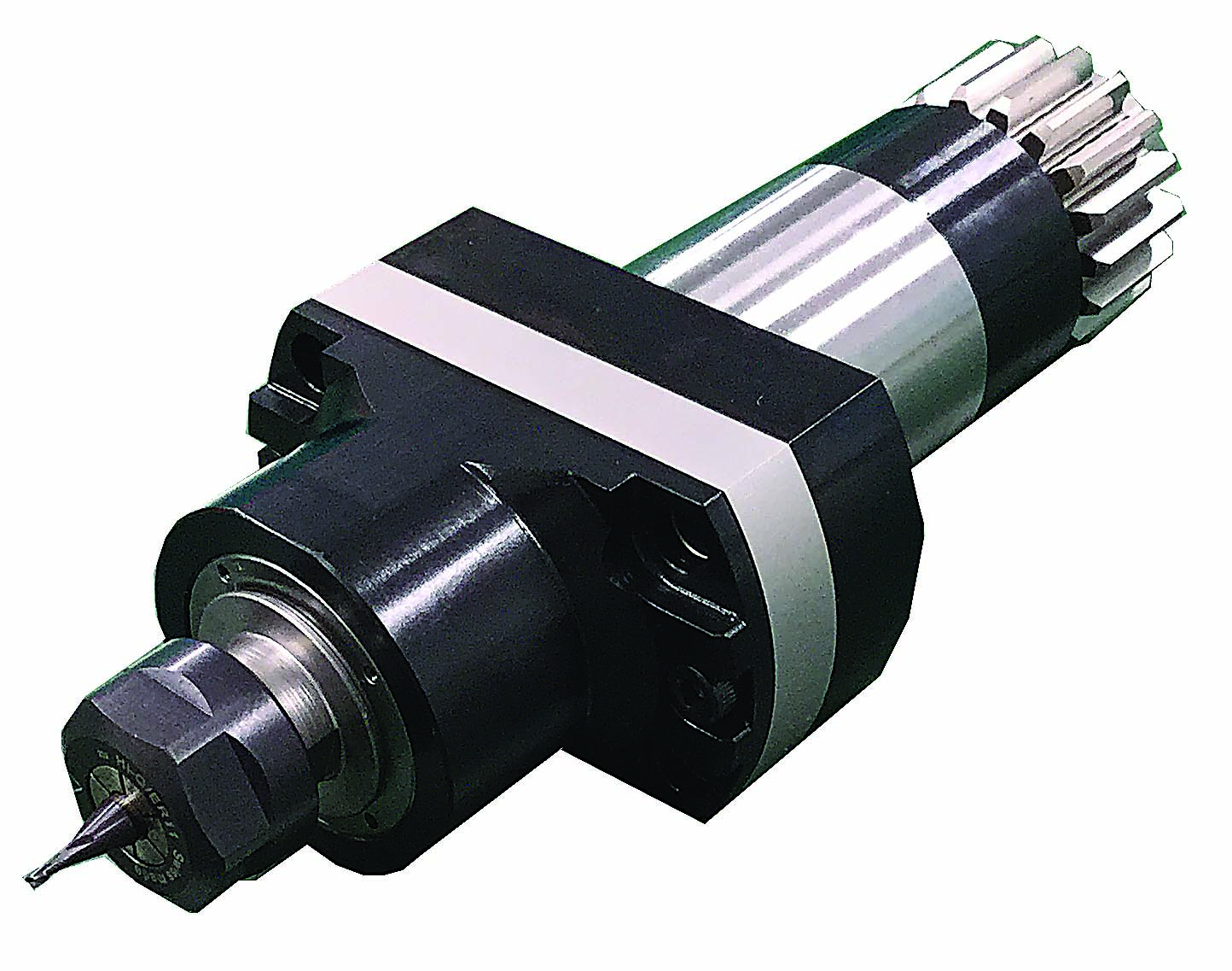

Speeder heads like the one shown provide the high rpm needed for small cutting tools. Image courtesy of Platinum Tooling Technologies
“Swiss shops use a lot of very small drills and endmills,” he said, “and the available driven tool speeds don’t always provide the rpm needed for tiny cutting tools.”
He suggests that shops keep a close eye on the cutting tool and whatever it machines, no matter whose logo sits on the live toolholder. Once surface finish begins to diminish or runout moves beyond a couple of tenths, he said, that’s a good indication it’s time to send out the live tool for a rebuild. If a shop waits too long, bearings could seize, possibly destroying an expensive piece of tooling.
