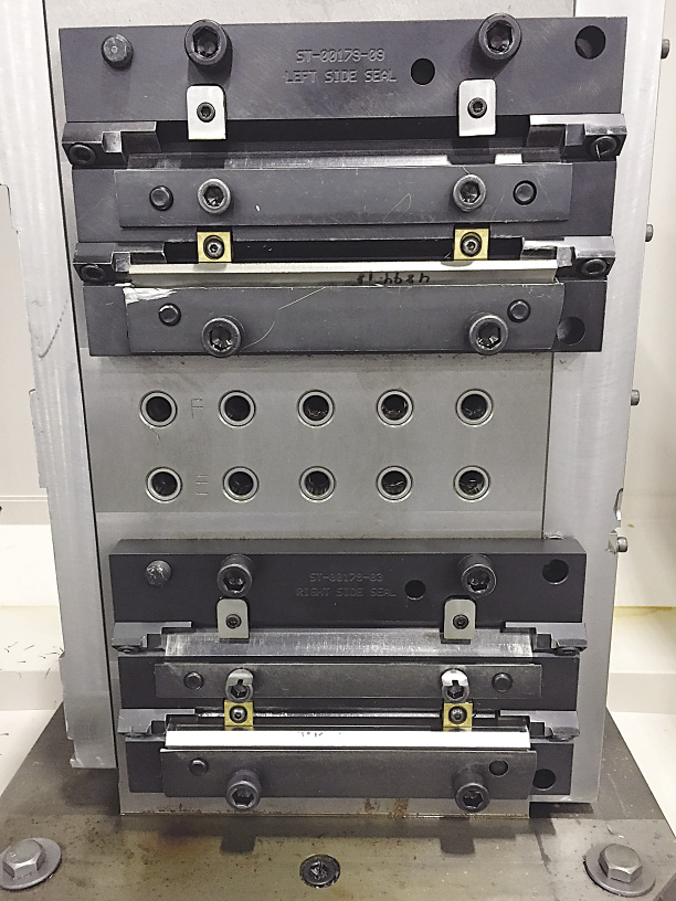

A tombstone on a horizontal machining center at Mitsubishi Hitachi Power Systems Americas' machine shop is an example of a fixture that can be used on all machining centers, including verticals, because it has a common locating pattern.
A tombstone on a horizontal machining center at Mitsubishi Hitachi Power Systems Americas’ machine shop is an example of a fixture that can be used on all machining centers, including verticals, because it has a common locating pattern.

As with tools, setting and aligning workholders is also a necessity. At Mitsubishi, we use tombstones for horizontal machining centers and plates for vertical machining centers with identical mounting holes evenly spaced in a grid pattern. All fixtures and other workholders have a matching pattern, and dowel pins are employed to align the workholder to the plate or tombstone.
This approach allows us to accurately place the fixture inside the machine and eliminates manual alignment of the workholder to the machine tool. In addition, it can eliminate the need to enter coordinate system values into the control.
When the fixture is accurately returned to the same place inside of the machine’s work envelope, it is possible to write a G-code program with the necessary values into the control’s memory. This can reduce setup time from hours to minutes.

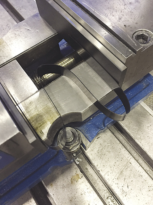

To keep parallels upright when opening a vise, a tool and die maker constructed a spring by bending a piece of banding steel into the pictured shape and placing it between the parallels.

I found my favorite time-saver at a small tool and die shop that employed a particularly experienced tool and die maker nicknamed Grandpa. Grandpa was milling several of the same items, so he was constantly taking them in and out of the mill vise. To keep his parallels upright when he opened the vise, he constructed a spring by bending a piece of banding steel into a Z-like shape and placing it between the parallels. While this may not be a true setup-reduction technique, it demonstrates a simple but effective way to save time.

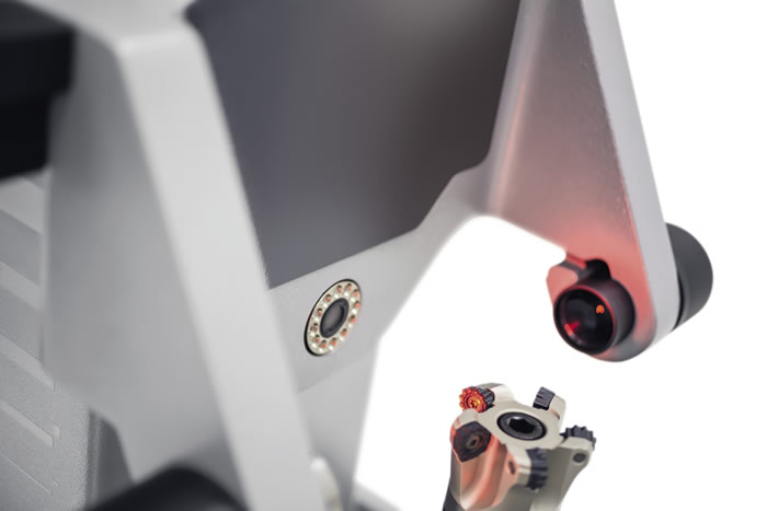

The benefits of offline presetting for CNC machining are clear. A tool presetter, such as the »venturion« from ZOLLER Inc., Ann Arbor, Mich., reduces setup time for an individual tool by 3 minutes, on average, and because tools are set offline, a presetter can increase production rates.
Tool presetters can be configured to meet the specific needs of various production processes. The measuring equipment is suitable for any CNC production application and for presetting any type of tool, even large, heavy ones. Tools can be set on a presetter located next to a machine tool on the shop floor or in the toolroom.
Reducing setup times frees up time for making chips
With a tool presetter, cutting tools are set and measured offline while the machine tool is producing parts.
With a tool presetter, cutting tools are set and measured offline while the machine tool is producing parts. Image courtesy Zoller Inc.
