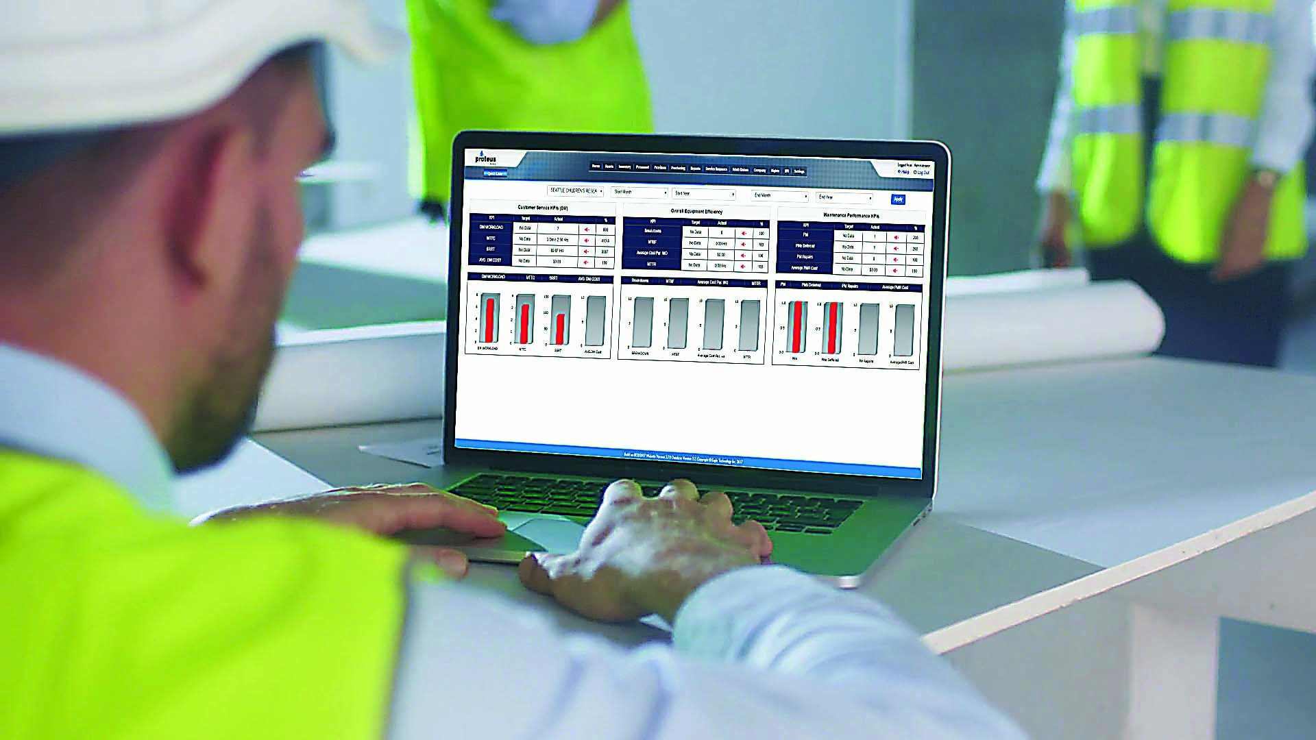

Ready access to key performance indicators helps maintenance employees make better decisions. Image courtesy of Eagle Technology.
