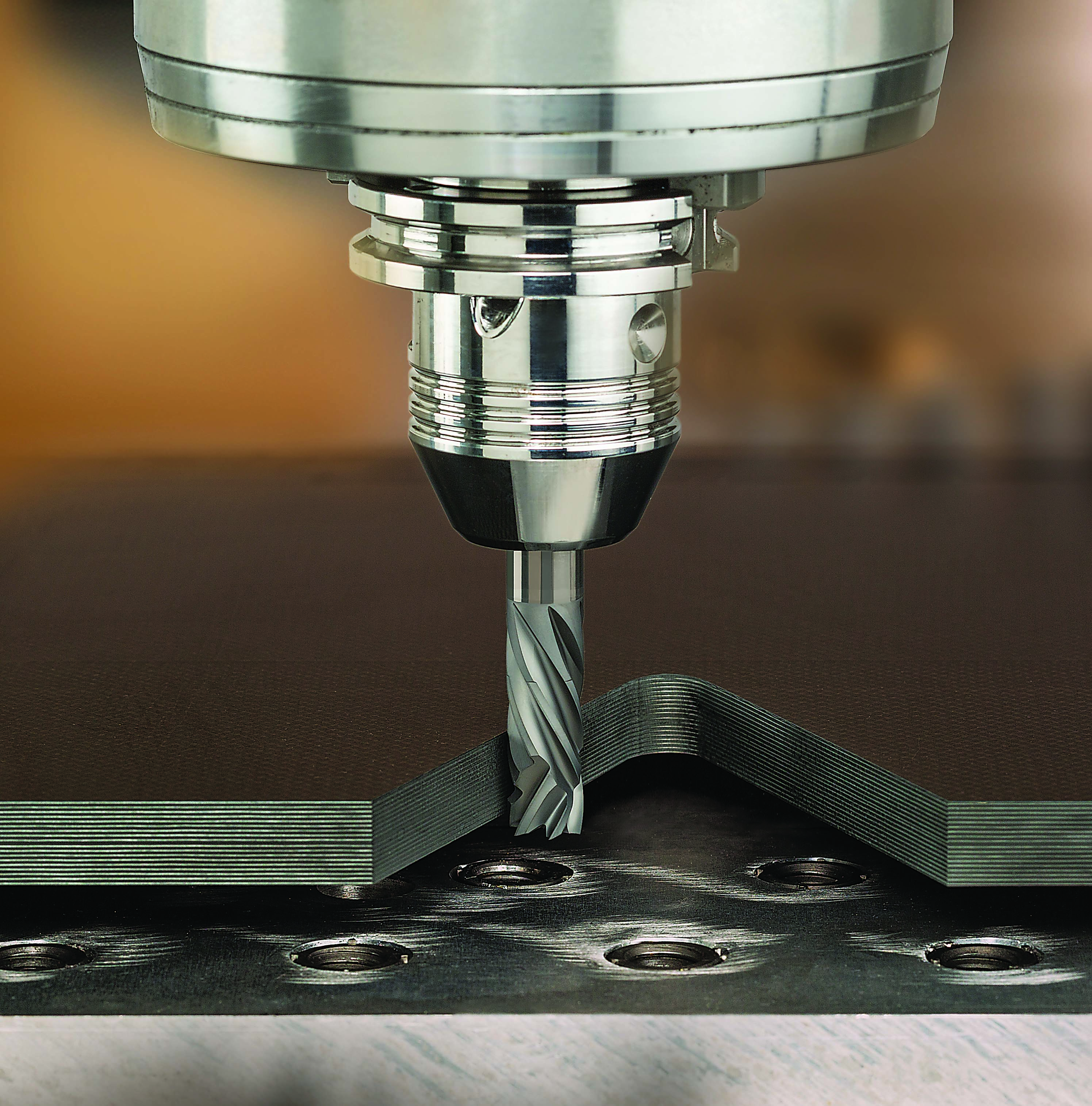

AMAMCO Tool’s Fix Cut diamond-coated carbide compression router cuts a composite workpiece. Image courtesy of AMAMCO Tool.
Unless carbide routing tools are coated with actual diamond, he added, it’s difficult to justify the expense to deposit a coating that doesn’t last. “Even the amorphous diamond or diamond-like-carbon coatings wear off pretty quickly in carbon fiber and most composite materials,” MacArthur said. End users, though, sometimes apply uncoated carbide tools for roughing when there’s a lack of rigidity that can cause a PCD or diamond-coated tool to chip, or they only have to cut a small quantity of parts.

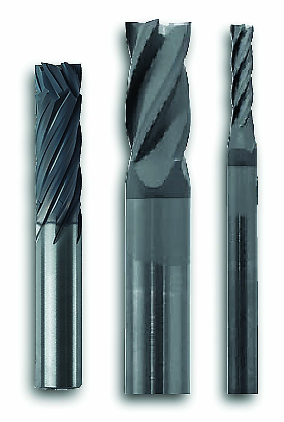

Examples of brazed “B-Bond” diamond routers for highly abrasive materials from Starlite Industries. Image courtesy of Starlite Industries.

Brazed vs. Plated
Starlite Industries Inc. also offers routers for composites, including diamond-plated “Magnicon Bond” and diamond-brazed “B-Bond” routers. Compared to the plated tool, the brazed tool provides more space between the diamond particles, which allows room for the low-melt resins often found in composites to dissipate, explained Jay Rosenbluth, the company’s manufacturing manager. “Generally speaking, diamond tools prefer harder materials rather than softer or low-melt materials.”
He added that the brazed router is also effective for cutting hard materials, such as ceramics and the fiber reinforcement in carbon-fiber composites, which is primarily polyester.
A brazed bond employs a high-temperature nickel alloy that fuses with the diamond to create a molecular bond, whereas a plated bond is a mechanical encapsulation of the diamond, Rosenbluth said. “When the heat builds up, the thermal coefficient of expansion is overcome by that molecular bond with the diamond.”

PCD is an effective tool material for cutting abrasive materials like composites. However, Andrew Gilpin, R&D/marketing manager for AMAMCO Tool, Duncan, S.C., recommends diamond-coated carbide tools for routing and trimming composites because toolmakers are limited in their ability to produce advanced geometries in PCD. He said the coating thickness ranges from 9µm to 12µm, which extends tool life without creating too much edge rounding and the threat of part delamination.

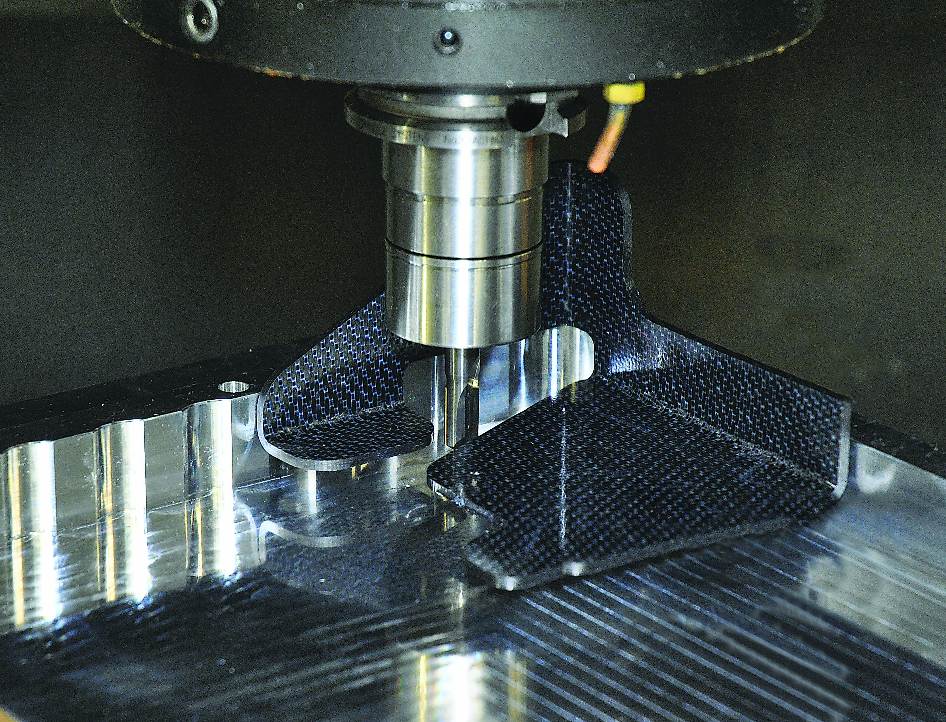

A PCD router from RobbJack machines a composite part. Image courtesy of RobbJack.

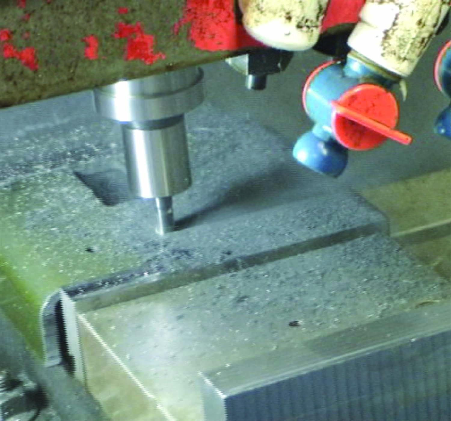

Applying liquid coolant is one option for reducing heat, but Rosenbluth said many of Starlite’s customers want to cut composites without lubrication to avoid the risk of the workpiece material absorbing any liquid. Therefore, he frequently recommends applying air as an effective coolant.
Gilpin agreed that routers can effectively dry-machine composites—as long there’s a method to manage the composite dust—but it’s not his first choice. “Heat is our enemy in this process. As long as you are not compromising the material through any type of fluid penetrating into the resin or the fibers themselves, we are going to recommend wet.”
Nonetheless, some OEMs dictate that no coolant can touch the composite material during the manufacturing process. “When they do that,” Gilpin said, “it is what it is.”
Rosenbluth emphasized that applying routers with sharp cutting edges is the best way to overcome heat without liquid lubrication.
Routing a composite part in one pass, rather than taking roughing and finishing cuts to minimize the number of linear inches a router spends in the material, is one way to extend tool life and sharpness, according to RobbJack’s MacArthur. This approach also shortens cycle times.

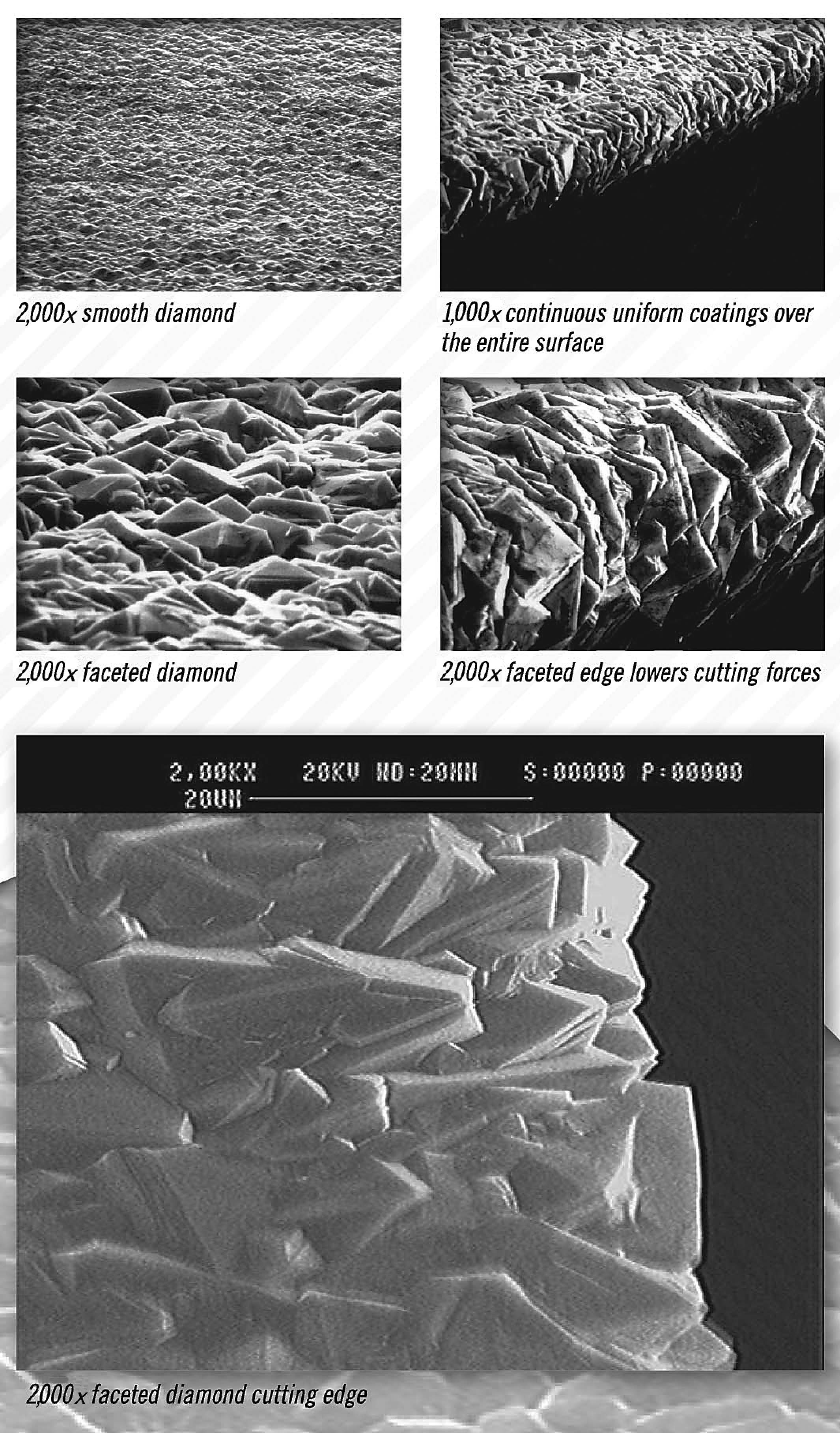

Magnified images of diamond coatings on cutting tools. Images courtesy of RobbJack.
“Once you start dulling the cutting edges or chipping the cutter or experiencing wear, you start adding a lot more friction and heat,” MacArthur said. “One key area of getting rid of the heat is to make sure that you’re maintaining a sharp tool as long as you can.”
