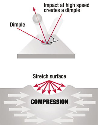

Cold working is the plastic deformation of metal, a process that takes place below the material’s recrystallization point (i.e., at room temperature) to improve strength and hardness while reducing ductility. Shot peening is a common type of cold working. It is done by directing balls, or shot, at a workpiece at speeds faster than a Top Fuel dragster crossing the finish line. The result is a series of overlapping dimples on the part surface, which induce residual compressive stresses in the metal.
Repeatedly striking metal surfaces in this manner enhances fatigue resistance, reducing the chance of cracking or stress corrosion in parts such as turbine discs, springs, gears, engine parts, landing gear and aircraft wheels.

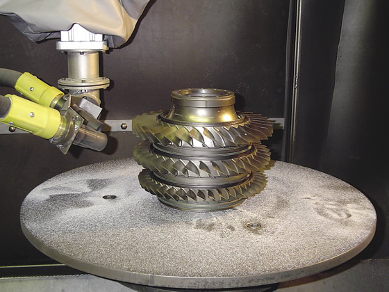

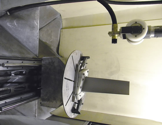

A thin metal workpiece is securely held on a rotary table prior to shot peening. Image courtesy Innovative Peening Systems.
Shot peening offers cost-effective way to make stronger metal products
Dan Dickey, owner of equipment provider Innovative Peening Systems, Norcross, Ga., said shot peening has evolved substantially over the past 20 years. “It used to be a matter of throwing a whole bunch of balls at the part in hopes that you strike it in all areas; the technology available today is much more motion-controlled. You decide where on the part you want to hit, then program that into the machine, and the nozzle directs the balls at the exact spot desired. You can strike it quick and be done with it.”
The move from carpet bombing to sniper shots makes shot peening far more cost-effective than in generations past. CNCs and robotic part handling reduce air and power consumption while greatly increasing throughput. “Shot peening is a complex process that requires precise shot delivery to be efficient,” Dickey said. “That’s because every part is different, with its own unique curves and features. This can have a dramatic effect on shot intensity and change the angle at which the shot strikes. If you’re hitting at a flat angle, for example, the shot just skips off and there’s not much of a dent, as opposed to hitting it at 90°, which is the best angle for penetration. So it’s important to always follow the contour of the part while keeping the nozzle perpendicular, adjusting the speed as you move into and out of internal corners. That’s the key to successful shot peening.”

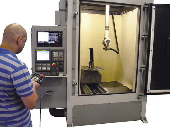

An operator performs a setup via teach mode on a CNC shot peening machine. Image courtesy Innovative Peening Systems.
Dickey said the lion’s share of his equipment is automated and typically has one 4-axis shot nozzle and 2-axis control of the workpiece. Despite having six axes to contend with, programming requires little more than driving the part and nozzle through the desired motions with the machine in teach mode, then allowing the CNC to repeat the pattern. After that, being successful with shot peening is largely a matter of monitoring media flow and air pressure.

In shot peening, small metal balls propelled at a high velocity create dimples on the surface of a metal workpiece. This generates compressive stresses and enhances metallurgical properties. Image courtesy Wheelabrator Group.

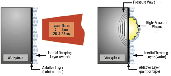

When traditional shot peening doesn’t fulfill the needs of the job, manufacturers turn to laser peening.
Dr. David Sokol, director of research at LSP Technologies Inc., Dublin, Ohio, said the technology uses a high-energy, pulsed laser beam to produce a compressive shock wave, which introduces plastic strain into a metal surface. This produces compressive residual stresses up to 5.0mm (0.197 “) deep, depending on the material and processing conditions.

Just like mechanical peening, laser peening increases fatigue life and strength in parts. The difference is depth. According to Sokol, shot peening penetration is limited to less than 0.025 ” (0.6 mm), whereas laser peening penetrates up to 10 times that amount, so it can be used in part locations where shot peening does not sufficiently relieve residual stresses to meet fatigue requirements. And because laser peening doesn’t rely on flying balls to do its work, it’s more accurate and repeatable and can often be applied to specific areas of a workpiece without the need for a mask. The process involves application of Nd:glass, YAG (yttrium aluminum garnet) or YLF (yttrium lithium fluoride) laser-emitting pulses 10 to 30 nanoseconds in length, with energy levels up to 50 joules—producing pressures up to roughly 1 million lbs./sq. in.—focused on a spot no larger than the diameter of a pencil. “LSP Techologies Inc. is working toward reducing the cost of laser peening by employing diode-pumped lasers that can operate at repetition rates up to 60 Hz,” Sokol said.
While a laser peens harder and faster than a steel ball can ever hope to, it does not heat the metal. For this reason, laser peened parts are strengthened without the cold working associated with shot peening, allowing parts to operate in high-temperature environments without risk of degradation.
Curtiss-Wright’s Dave Breuer said laser peening prevents fretting fatigue and foreign-object damage better than shot peening. “Think about the blades on a jet engine,” he said. “They’re prone to damage from rocks and other kinds of debris that can chip or ding those blades. In critical areas like this, you need a compressive layer that is deeper than the nick or the ding.”
Breuer said 90 percent of fatigue application problems can be solved with shot peening, which has been in use for nearly 50 years and is a well-controlled process that’s relatively inexpensive. But for the other 10 percent of parts, laser peening makes a huge difference. “You look at laser peening where shot peening doesn’t work. It’s expensive—maybe 10 times the cost of shot peening—so isn’t going to be used on a transmission gear that can be peened for a few bucks. But for folks who make critical rotating parts, such as jet engines or power generating turbines, where a thrown fan blade can make for a real bad day, spending the extra money makes sense.”
