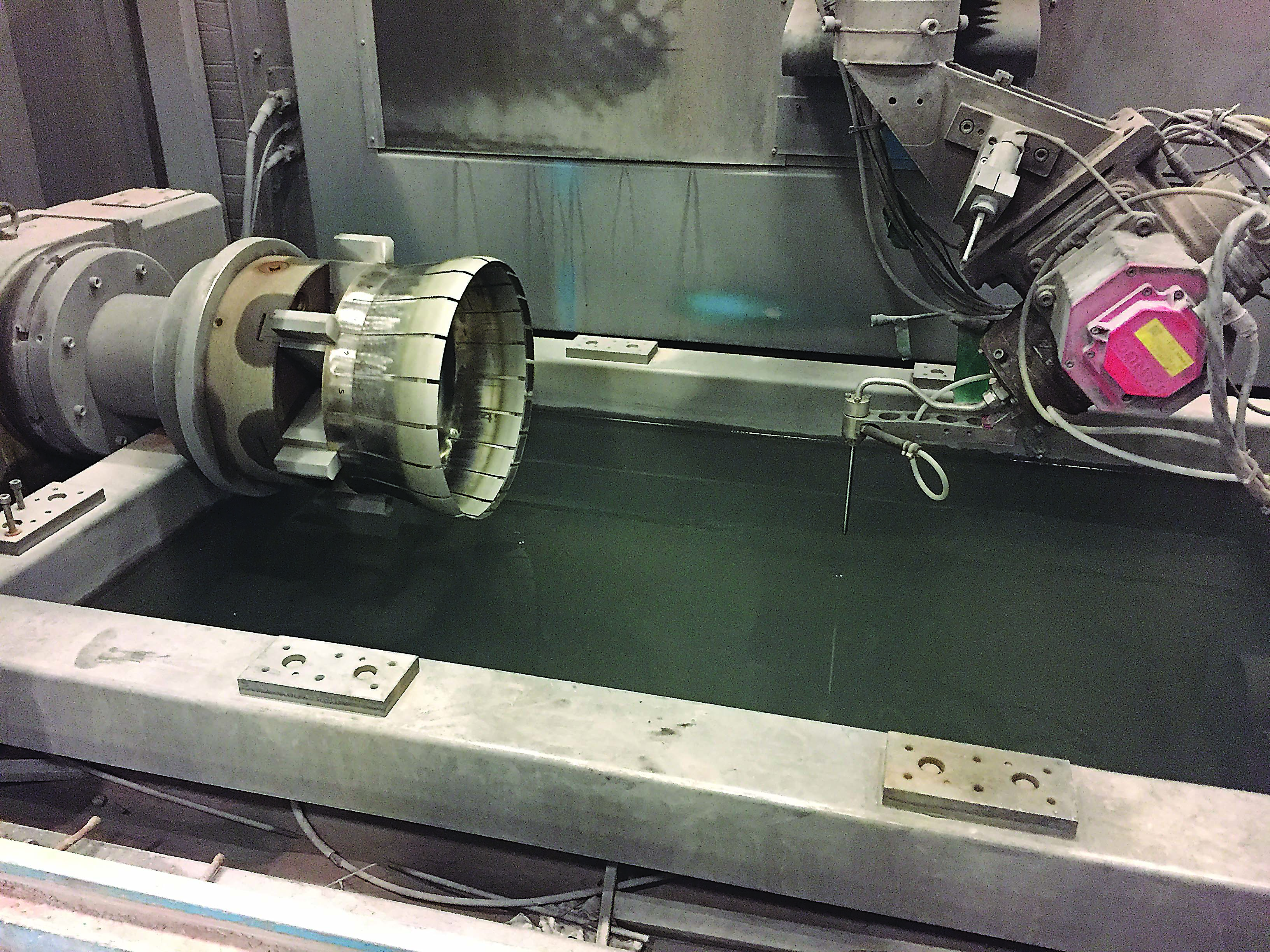

When we experience tearing or cracking of holes during the forming operations, we must change the order of operations so that holes are made after forming the part. Because we wanted to continue to utilize the waterjet process for these materials and mitigate issues when forming, we purchased a 5-axis waterjet that allows us to cut holes in parts that have been formed and welded together. The waterjet-holemaking process exerts less force on the workpiece than conventional drilling and facilitates use of workholding that is less complex and expensive than that needed for traditional machine tools.
Shop credits timing for successful holemaking operations
MHPS’ 5-axis waterjet exerts little pressure on parts, which makes fixturing flimsy sheet metal parts easy.

The waterjet lets the shop cut holes in parts that have been formed and welded together.
