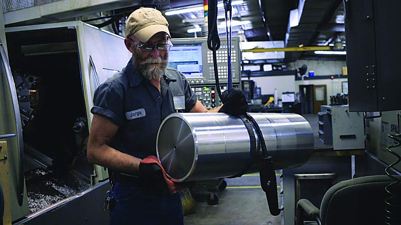

Machinist Jorge Diaz loads a workpiece into a turning center. Image courtesy of Heartland Enterprises

The company only rough-turns the age-hardened superalloy forgings before sending them to jet engine original equipment manufacturers for finishing in-house or by a subcontractor, Easterwood said. Nonetheless, tolerances can be fairly tight at ±0.0254 mm (±0.001″).
He said the process begins by removing the scale on the forgings, an interrupted turning process that breaks down inserts. Round ceramic inserts are the go-to tools because round is the strongest insert shape, but square and 55-degree inserts with four or six nose radiuses also are used, depending on the required part features. The inserts are uncoated.
“We will get the scale off using a slow surface footage, around 180 to 200 sfm (54.9 to 61 m/min.), a 0.1″ (2.54 mm) DOC and a 0.01 to 0.012 ipr (0.254 to 0.305 mmpr),” Easterwood said.
He said removing the scale typically requires several passes. In addition, each pass usually doesn’t cover the entire length of a workpiece. For example, the first pass might travel half the length of the part before an insert is indexed and cutting continues.
“It depends on what the forging looks like, how clean it is and everything like that,” Easterwood said. “Once the scale is off, it’s a lot easier cutting, with no interrupted cuts.”

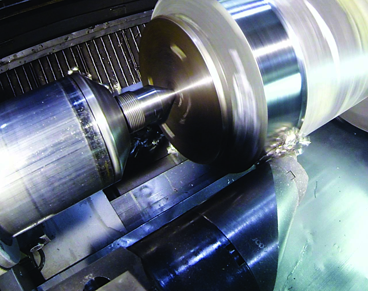

With the scale removed, he said Heartland Enterprises turns superalloys at a vigorous but slow cut to prevent the cutting tool from pushing off the material and to correctly produce the part dimensionally.

Because nickel-base superalloys tend to workharden, turning parameters must be controlled carefully to prevent too much heat from entering a workpiece and damaging the tool, Easterwood said.
In addition, workhardening causes the tool to be pushed off the workpiece. For example, push-off might cause a 152.4-mm-dia. workpiece to measure 152.91 mm (6.02″). In that scenario, he said the tool should not be offset 0.51 mm (0.02″), because the part will be turned to its specified dimension when the tool is run at the correct speed and feed.

A nickel-base superalloy is turned. Image courtesy of Heartland Enterprises
When a part measures more than 609.6 mm (24″) in diameter, he said the part generally goes on one of the company’s two Okuma 1SP-V100R vertical turning lathes, which can manage parts up to 1,066.8 mm in diameter and up to 609.6 mm long.
