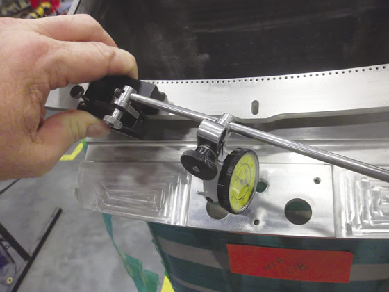

The author uses this surface gage—one of his favorite tools—to inspect a machined face for flatness.

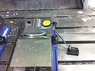

The second tool the master toolmaker told me to buy is a surface gage. I don’t often see surface gages in “young guy” toolboxes, which is unfortunate. In the world of CNC and CMM, many machinists and toolmakers no longer perform proper layout, which is the primary function of a surface gage. However, like test indicators, they have limitless uses. I have used them to prove the flatness of machined surfaces and paired one with an indicator to measure part height on a surface grinder chuck. You can hold the V-groove against a shaft and verify concentricity to a bearing race, and, by resting the pins against the edge of a mill table, you can align long parts or vise jaws without having to crank the mill handles. It is also possible to check the alignment of machine ways with a surface gage and an indicator.

The same surface gage is also suitable for inspecting the parallelism of two machined faces.

Demonstrating the tool’s versatility, a surface gage can also check the alignment of a part relative to the machine table.
