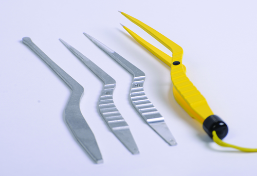

In their 26 years, Homeyer Precision Manufacturing has taken on some of the most demanding industries and jobs. Perhaps the most precise yet is among today’s production lineup at the company’s 63,000 sq. ft., Marthasville, Mo., shop—bipolar, aluminum-based forceps used by neurosurgeons performing brain surgeries.
The forceps must meet exacting standards, and the machining setup had to maintain consistent precision through production runs in the thousands.

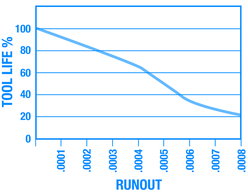

As the product gained popularity, demand from the customer grew, and so did the strain on Homeyer’s production. The setup at the time required increased monitoring after about the first 1,800 parts were produced. Because of runout, the endmill would lose its integrity and produce junk parts from part 2,200 to part 2,400, which required frequent tool changes by the operator and hampered productivity.

Forceps shown, from left to right, in raw form to finished final product. All images courtesy BIG Kaiser.
Chart shows tool life compared to runout.

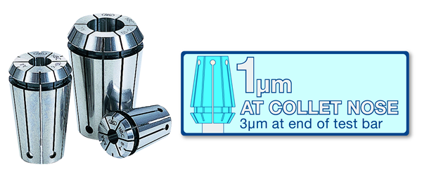

Mega New Baby Chucks from BIG Kaiser. Click here for a video showing the chucks in action.

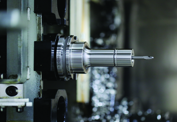

The tool holder in the magazine.

When he returned home, Homeyer invited Blaser Swisslube and BIG Kaiser’s U.S.-based vice president of sales and engineering, Jack Burley, to the Homeyer shop to discuss the medical cell that produces the forceps. After examining the setups, Burley immediately thought of his BIG Daishowa product line and the new Mega New Baby collet chuck.
What he found was the setup on the Okuma Space Center MB-5000H horizontal machining center was sound, and a Blaser coolant tailored to Homeyer’s needs. Burley was confident the holder’s BIG-PLUS dual-contact system and AA-grade New Baby collet with guaranteed TIR of less than 3µm at 4 times the diameter would improve performance of the 1/8” solid-carbide, 2-flute endmill used to machine most of the critical features on the forceps and boost productivity, economic efficiency and machining quality.
They ran a few tests with the new setup and the results were dramatic. The new holder and coolant improved tool life by 300 percent, allowing production to go unmonitored without interruption for a much longer period of time. Instead of having to keep an eye on the job at part 1,800, there was no deterioration in finish until after more than 7,000 parts were produced.
