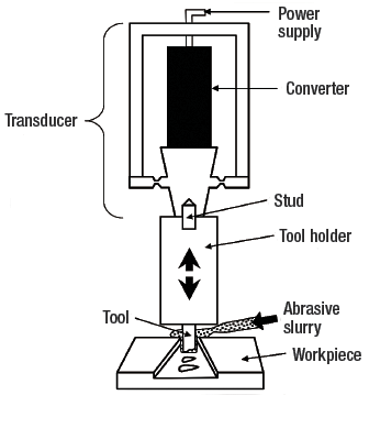

Ultrasonic machining (USM) goes back more than 50 years, but there are relatively few practitioners today. Bullen Inc. is an exception. In the USM process used by the Eaton, Ohio-based contract manufacturer, a low-frequency electrical signal is sent to a transducer, which converts the electrical energy into mechanical motion. This high-frequency, low-amplitude vibratory motion is acoustically transmitted to a custom tool, typically made from steel, which experiences linear oscillation. Tool motion is usually less than 0.002″ (0.508mm) at a rate of about 20 kHz.

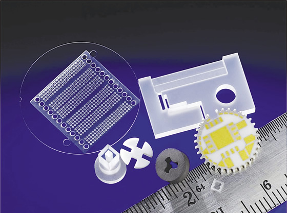

Ultrasonic machining can cut glass, sapphire, engineered ceramics, silicon carbide, quartz, single-crystal materials, PCD, ferrite, graphite, glassy carbon, composites and piezoceramics, among other materials.
While the tool moves, a slurry flows between it and the workpiece. The slurry consists of abrasive grains suspended in water or a chemical solution. Abrasives include diamond, alumina, boron carbide and silicon carbide, with the abrasive chosen dependent on the hardness of the workpiece material. The harder the workpiece, the harder the abrasive, noted Greg Fitch, a business unit manager at Bullen.

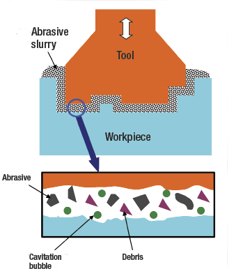

That’s because the abrasive grains, not the tool, contact the workpiece during USM. As the tool oscillates, it hammers the grains into the workpiece, abrading it and eventually leaving a precise reverse image of the tool shape.
Low force is applied to the grains, causing microscopic fracturing of the workpiece that removes material. The amount of force applied depends on the tool or application. Small abrasive grains, for example, are accelerated at many thousands of “g” forces. The result, Fitch said, is significantly less subsurface damage compared to conventional machining alternatives, such as EDMing or drilling with a PCD tool. This, in turn, reduces the likelihood of workpiece fractures that might lead to device failure. Also, USM is nonthermal, eliminating the risk of heat-related damage that can occur when laser machining.

In an ultrasonic machine tool (above), high-frequency, low-amplitude energy is transmitted to the tool assembly. A constant stream of abrasive slurry passes between the tool and workpiece (below). The vibrating tool, combined with the abrasive slurry, uniformly abrades the material, leaving a precise reverse image of the tool shape in the workpiece.

Common USM applications include semiconductors, MEMS devices and microfluidic components. When using USM, a number of small parts can be fixtured together in an array and machined simultaneously.
Bullen mainly USMs through-hole arrays in glass constraint wafers for MEMS pressure sensors. Machining large numbers of through-holes simultaneously is significantly less expensive on a per-die basis than conventional step-and-repeat processes, according to the company.
