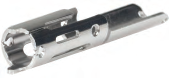

Machining metal can achieve tighter tolerances and finer surface finishes than other metalworking processes, but that level of precision comes with a cost. Aragon Surgical Inc., a Palo Alto, Calif.-based medical device firm, discovered that fact when having a job shop machine a stainless steel jaw housing for a laparoscopic surgical device from a solid, circular workpiece. In addition to wanting to reduce its cost per part, Aragon Surgical was having problems getting a sufficient number of parts, according to Brandon Loudermilk, the company’s senior R&D engineer.
At a trade show, Aragon Surgical made initial contact with Connecticut Spring & Stamping, Farmington, Conn., and discussed stamping most of the part’s features. “Our expertise is not machining from solid stock,” said Steve Dicke, vice president of sales and marketing for CSS. “It’s taking a part that is fully machined [and instead] stamping the basic part features to reduce costs and then machining the critical features.” He noted that CSS has seven machining centers and is buying two more.

Courtesy of CSS
Aragon Surgical reduced its cost for this stainless steel jaw housing for a laparoscopic surgical device by having Connecticut Spring & Stamping stamp most of the part’s features and machine only the critical ones instead of machining the part from a solid, circular workpiece.

Compared to $40 for a fully machined part, the initial run at CSS was 20 to 30 percent cheaper and 50 to 60 percent less after Aragon Surgical finished paying for the tooling costs, Loudermilk estimated.
Although the tolerances for the previously machined features were ±0.001″, the tolerances are ±0.002″ for the stamped noncritical features, ±0.002″ for the milled critical slot dimensions and ±0.001″ for the machined critical hole dimensions. Nonetheless, the part is fully functional.
CSS performs 5-axis milling of the parts after stamping using a rotary head on a CNC machine. “We take the part in the barrel shape, put it onto an arbor and rotate the part in different directions, putting all the slots, holes and necessary geometry on it,” Dicke said.
