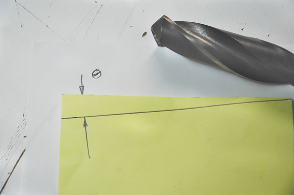

Ch06.Fig049.Lipton.DSC_7541.tif
A slip of paper can be used to measure and indicate the back clearance, or relief, angle on a drill bit.

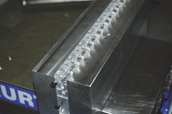

Ch06.Fig074.Lipton.DSC_2300.tif
A cutoff piece or O-ring cord stock provides the right amount of squeeze and friction to securely hold multiple parts.

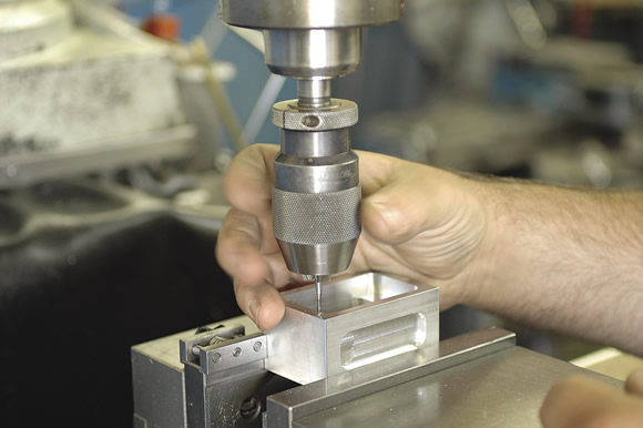

Ch06.Fig064.Lipton.DSC_0091.tif
You can use a drill chuck as a hand tapping guide if you leave the collet loose.

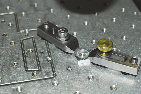

Ch06.Fig076.Lipton.DSC_2863.tif
Strap clamps hold a small part on a subplate.
• A simple way to measure the back clearance, or relief, angle of a hand-ground drill bit is to use a little slip of paper. Wind the paper around the cylindrical part of the drill body and mark the point where the corner meets the edge of the paper. The angle formed by these points is the clearance angle.

• You can use a drill chuck as a hand tapping guide if you leave the collet loose. Don’t forget to lift it up before you move to the next hole.

• Use some soft aluminum filler rod to help secure multiple parts. The soft, round wire squeezes down and makes up for the small differences in part width. This trick works best on hard parts, such as ones made of stainless steel, that require a fair amount of clamping pressure. Vertically position the soft wire for multiple stacked parts.
• Using a standard dovetail O-ring groove cut into a soft jaw face is another great trick for securely holding multiple parts. A cutoff piece or O-ring cord stock provides the right amount of squeeze and friction to hold the parts. You can also use different O-ring materials for different types of part holding.
• One of the best things I ever made was a 6 “×6 ” subplate with small strap clamps for holding small parts. You can also screw a parallel or a sheet metal V-plate to the subplate as a fence when you are making multiple parts.
