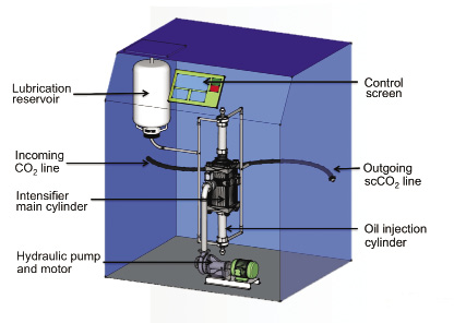

Components of the supercritical CO2 system from Fusion Coolant. Image courtesy Fusion Coolant Systems.
When it comes to CO2, any pressure higher than 1,200 psi (82.7 bar) is considered supercritical, Darr noted. The typical operating pressure for the system is from 1,500 to 2,500 psi (103.4 to 172.4 bar), and dialing up the pressure increases the heat-removal capability. The operating temperature of the scCO2 as it travels through the machine tool spindle or externally to the tool is 31.1° C (88° F). At the freezing point, or point of expansion, upon exiting the tool, the CO2 is about -78° C (-108° F).
Because the coolant flow must be restricted to achieve the supercritical pressure, Darr noted the 1mm (0.039″) coolant ports on standard cutting tools are too large for the scCO2 system. “We are operating in the range of 150µm to 250µm,” he said. “We have several large toolmakers making tools for us; notably, Seco has been involved with several tests. They are building a suite of tools for various medical applications.”
