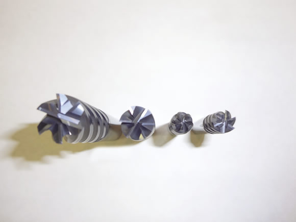

To enhance efficiency when cutting medical-grade cobalt chrome, the Columbia City, Ind.-based toolmaker developed the Ortho-Cut “CC” series of endmills. Oak View Tool also makes CC specials, such as keyway, form and dovetail cutters. “The series is designed for cobalt chrome and those types of tough materials that workharden and tear up a typical tool,” Dahms said.
Because cobalt chrome can workharden, CC tools have an edge prep combined with an effective shear angle, Dahms explained. “It’s so tough of a material, you have to hit it with the best of both worlds.”
DSC00038.tif
Courtesy of Oak View Tool
Oak View Tool designed its Ortho-Cut “CC” series endmills for machining medical-grade cobalt chrome. They are available with corner radii for added rigidity or for matching the size of the part feature.
The endmills also have unequal index geometry to minimize vibration and corresponding chatter. They have a carbide substrate with at least 10 percent cobalt to enhance tool toughness. The tools can be coated with aluminum titanium nitride or ordered uncoated if the orthopedic company has not yet validated the toolmaker’s coating, Dahms noted. He added that the coating, however, can extend tool life at least 30 percent. “The substrate, coating, geometry and edge prep are key,” he said. “If you’ve got those four things figured out, you can make the tools work really well.”

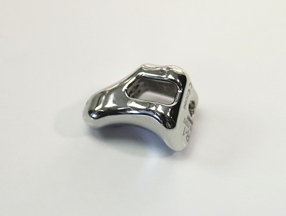

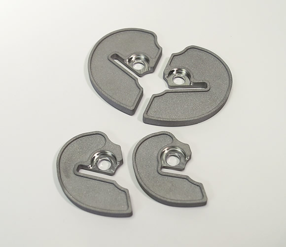

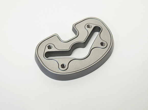

Oberg Medical produces an array of cobalt-chrome medical parts. From top to bottom: tibial augments used in knee replacements, a full tibial augment primarily used in total knee-revision surgery, and a trapezium implant used in the hand to replace the joint that controls thumb movement.
Oberg machines cobalt-chrome bar stock and castings and one challenge the company faces is securely holding the castings during machining. The near-net shapes have complex contours and typically there is no flat surface to grasp, Hoffman explained. As a result, the company spends a good deal of time designing and building fixtures to enable rigid workholding.

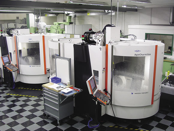

Oberg Medical uses high-speed machines from GF AgieCharmilles to produce some of its cobalt-chrome medical parts.
“We do light step-overs with full-flute depths to try to buzz the material off quickly,” Dahms said. “It gets the surface footage back up to where the heat is right for the coating. Also, we get a high enough feed rate to make parts fast enough, so everybody is excited.”
In addition, Dahms promotes using the full-flute length when machining cobalt chrome, and noted Oak View Tool designed the CC series tools to handle that type of cutting. “A lot of people do surfacing where they’ll use Z-level depths to remove material,” he said. “We want to get in and out quickly, because every time you use a Z-level depth, you’re putting more heat into the part and getting workhardening.”

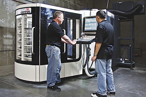

The DMG Sauer 20 ultrasonic machine with a robot loader at Core3dcentres has a Siemens Sinumerik 840D sl CNC. The CNC recognizes the workpiece pallet, which is coded by patient name to reportedly eliminate error.
The next step is translation of the digital impression to a RenShape mold, using conventional machine tools. Usually, the required structures are simultaneously designed, and then the mold with coping is sent to the DMG Sauer ultrasonic dental machine for preparation of the final structures. This is where Core3dcentres processes advanced and expensive substrates, such as cobalt chrome, ceramics, lithium disilicate and zirconia.
Tim McKimson, the company’s worldwide director of engineering, explained that the decision to cut ultrasonically rather than use other techniques was relatively easy, given the inherent wear conditions and high cost of conventional cutting tools. In the ultrasonic process, a combination of electrolysis and fluid lubrication act in concert to create an ionic attraction of particles, removing material in a predictable and accurate way, without the mechanical stress implicit in conventional machining.
“The process is more or less a grinding process,” said Dr. Uli Sutor, senior account manager for DMG Vertriebs und Service GmbH Deckel Maho Gildemeister, Pfronten, Germany. He added that the ultrasonic tools move 2µm to 4µm about 50,000 times a second and only remove material that’s sintered or harder than 62 HRC. “It is not possible in material like titanium.”
Blanks of material are loaded into the ultrasonic machine’s 66-position feeder station and delivered to the work zone by a Motoman robotic arm with Schunk pressure grippers.
