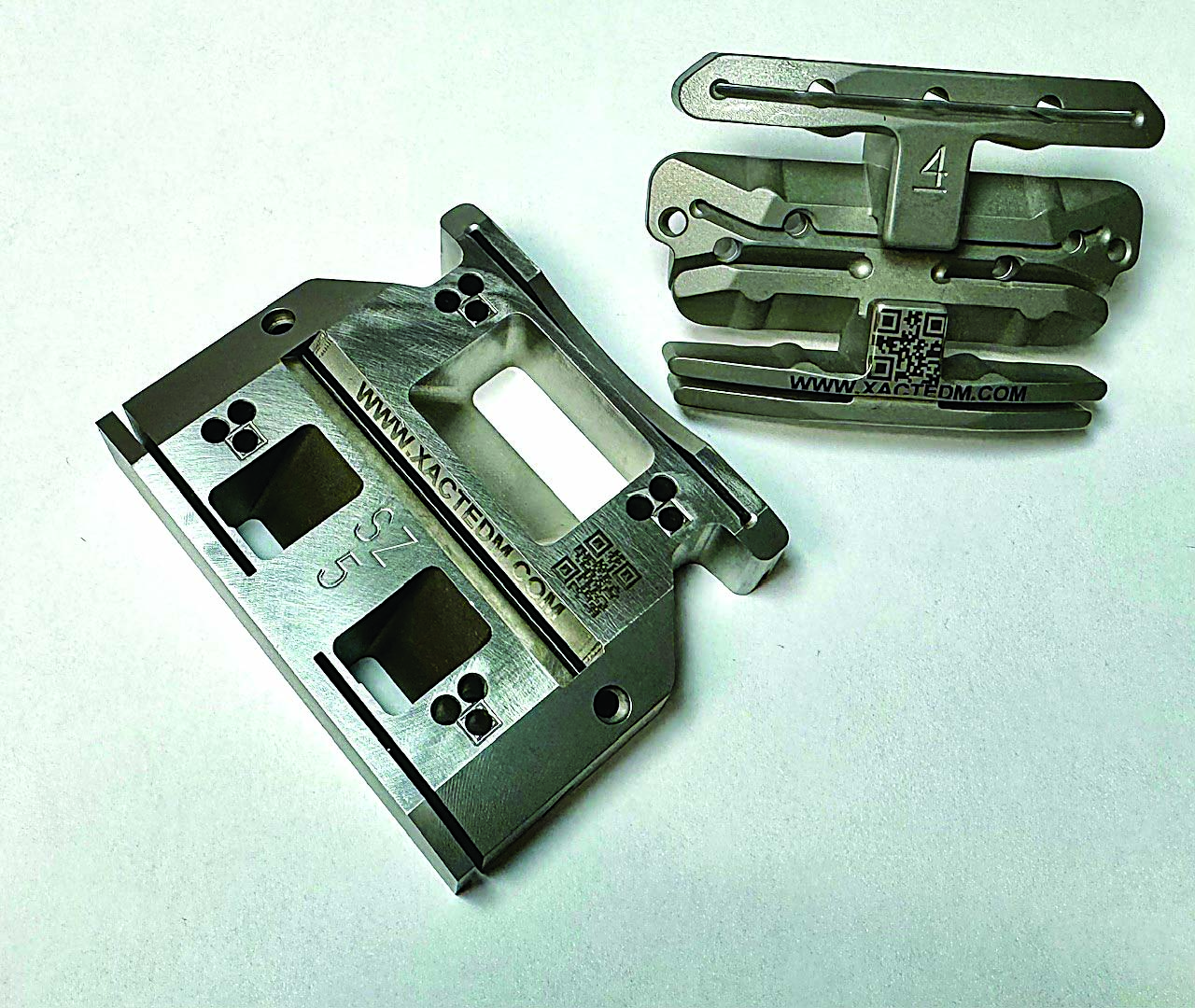

Xact Wire EDM
Xact Wire EDM’s customers include many medical companies that may require laser part marking as a secondary process to its wire and small-hole EDMing services. Image courtesy of Xact Wire EDM

Xact Wire EDM Corp. in Waukesha, Wisconsin, was started in 1984 to provide wire EDM and small-hole EDM services to customers across the U.S. A second facility was added in 1994 in Cary, Illinois. Both locations began offering laser marking services as a value-added service to complement the wire and small-hole EDM services, said Michael Raasch, business development. Xact’s customers include many medical companies that may require laser part marking as a secondary process to wire EDMing.
“Some of our projects include such items as identification with bar codes, QR codes, logos, serial numbers, patent numbers, date codes and more,” Raasch said.
Each of the company’s locations has a Zetalase fiber laser marking machine with a rotary device for 360° marking and a Minilase XL20 fiber laser marking machine.
The medical components that Xact has machined include tibial cut guides, resection cut blocks, laparoscopic graspers and forceps, bone plates, surgical needles, and alignment guides. The workpiece materials are metal because they need to be conductive for
EDMing and include titanium, medical-grade stainless, platinum, tungsten and Nitinol. “We’re set up primarily to do laser marking on metal and not plastic. Those types of jobs we would ‘no quote.'”

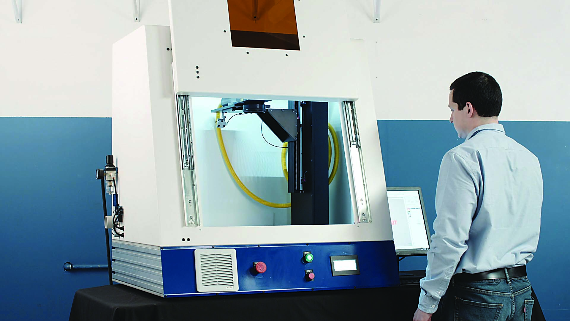

GT Schmidt
GT Schmidt’s GeoMARK Pro laser marking machine can achieve a wide range of depths in metal and plastic parts. Image courtesy of GT Schmidt

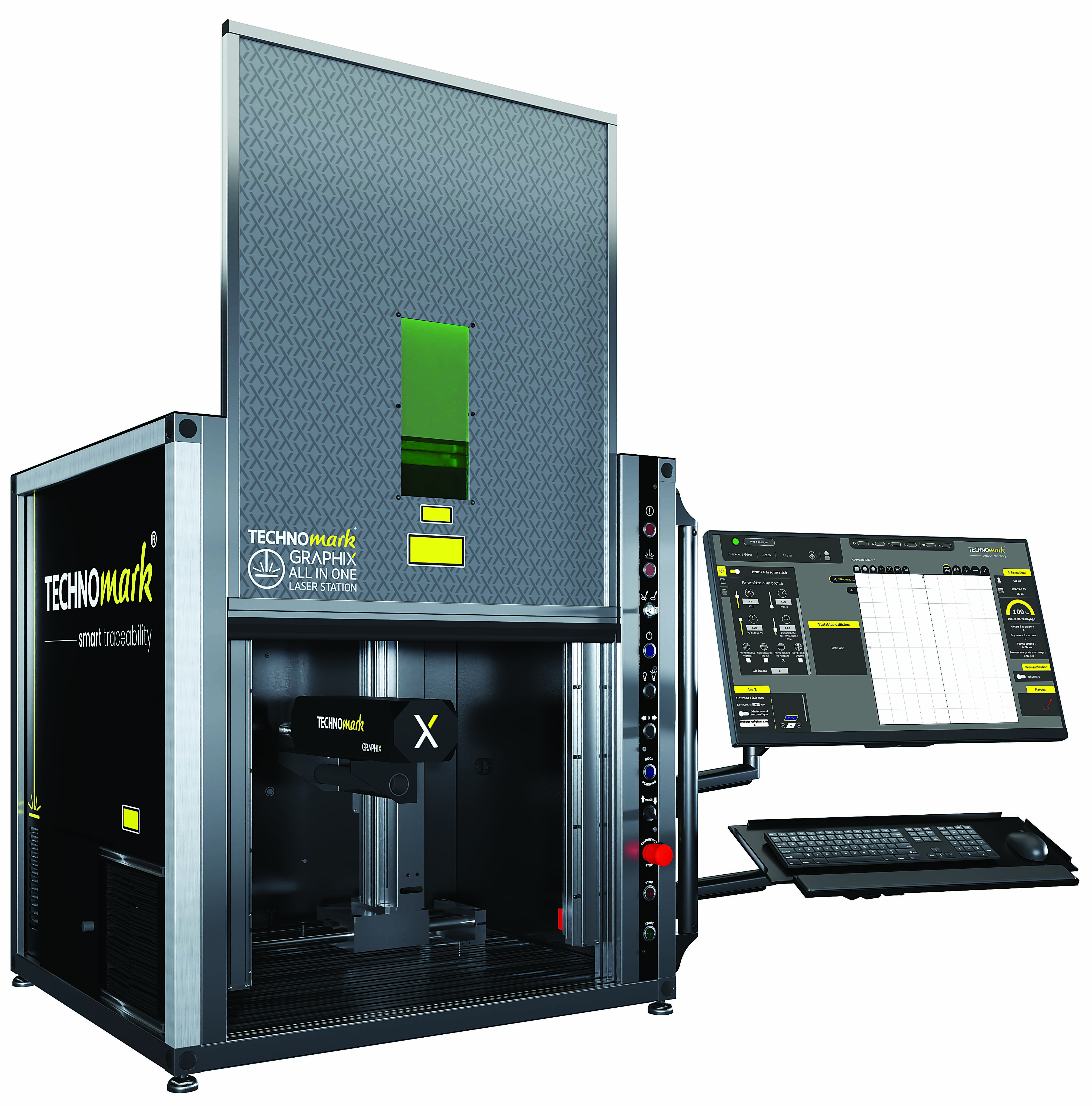

Technomark
The new Graphix Plus all-in-one laser marking station from Technomark provides easy access to parts, and features a motorized door, on-board camera and intuitive software. Image courtesy of Technomark
Other types of markings include general, annealing, ablating and deep engraving, the company reports. General marking is the most common, with its ease of programming and creation of extremely durable marks. As previously noted, annealing is used when no visible surface disruption is required. The material is heated by the laser beam to create a dark or burned mark that’s smooth to the touch. Because no physical disruptions occur so the surface does not present any holes or cavities that could retain bacteria, this method is often used to mark surgical tools and implants. Ablating removes some of the surface coating to reveal the underlying material and creates different levels of contrast between the mark and unaffected areas. In addition, deep engraving generally employs a high-powered fiber laser to mark various materials, including rubber and metal. The depth is a function of the laser’s power, speed and repetition rate, or how many pulses per second.
Fayolle said Technomark’s Graphix laser marking system is targeted for low-volume, high-matrix jobs because of its adaptability and flexibility. The system comes standard with two F-theta lens options for a customized marking area size, the ability to mark pieces with dimensions up to 500 mm × 500 mm × 400 mm (19.68″ × 19.68″ × 15.75″), and an integrated PC with keyboard, mouse and monitor.
One available option is the rotating axis accessory to mark parts with a variety of shapes, which is also suitable for dot peening. “With a rotating axis,” she said, “you can mark on the generator, and you can also mark on the circumference of the parts.”
To integrate laser marking technology into an automated production environment, Technomark offers the Graphix Inline machine. In addition, the company introduced the Graphix Plus all-in-one marking station with a motorized door, on-board camera and intuitive software. The company-developed software enables an ergonomic interface with two operating modes: one for creation of marking files with simplified settings for novice users or advanced settings for experts, and one for production with variable filing and preconfigured files marking to optimize productivity and reduce the risk of errors. “Our machine can make the settings for you with the very easy-to-use software,” Fayolle said.
