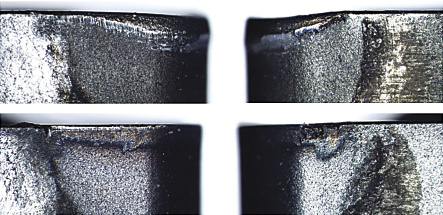

Magia_tool_life_NEXUS.tif
Courtesy of Techniks
A comparison of tool life for the Nexus CMMG 120408 NN MG10 insert (bottom two) vs. another toolmaker’s brand (top two) after wet machining 42CRMo4 at a cutting speed of 660 sfm, a feed of 0.020 ipm and a 0.079 ” DOC for 22.0 minutes (Nexus) and 11.5 minutes (other brand).
