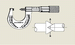

■ One is a screw thread micrometer, which differs from a regular micrometer in having a cone-shaped spindle and a mating anvil. These fit over threads and measure a thread’s major diameter less the depth of one thread. This method works well for threading operations because the work does not have to be removed from the lathe to take the measurement.
