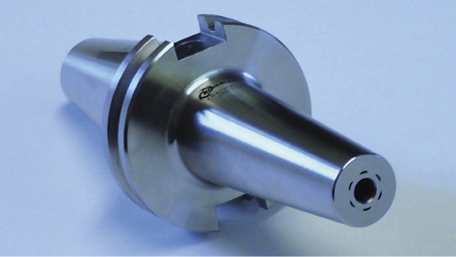

The KoolBlast Thermalfit through-coolant toolholder from Advanced Industries features D-shaped orifices and the company's PressureMax design, which together minimize turbulence as coolant contacts the cutting tool. Image courtesy Advanced Industries.
The KoolBlast Thermalfit through-coolant toolholder from Advanced Industries features D-shaped orifices and the company’s PressureMax design, which together minimize turbulence as coolant contacts the cutting tool. Image courtesy Advanced Industries.

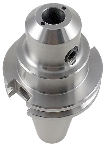

Pioneer through-coolant toolholders come with two orifices standard. The company will EDM additional holes for a charge. Image courtesy Pioneer.

Pioneer N.A. does things a little differently. It will EDM through-coolant holes into any of the toolholders it inventories.
“We put in two holes standard, but we charge $20 per additional hole, so if a customer has enough coolant volume coming through the machine to support it, we can put in more,” said Lee Flick of Pioneer, Elk Grove Village, Ill. “We’ve done as many as 12 holes in a holder for one of our customers.”

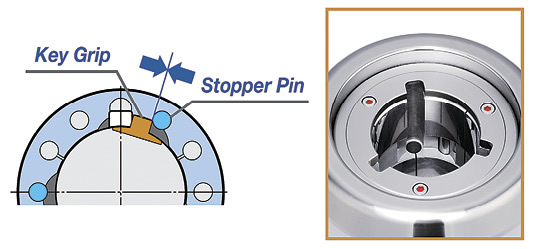

The Mega Perfect Grip holder from BIG KAISER is designed for applications involving superalloys. It incorporates a key grip that locks the Weldon flat of a cutting tool into place. Three slots in the bore where the key can slide down provide holes for the higher volume of coolant needed to machine such materials. Image courtesy BIG KAISER.

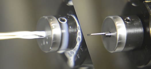

Similar to placing your thumb over the end of a garden hose, the design of a through-coolant toolholder can help increase the pressure of the coolant hitting the cutting surface.
“If your area for delivering coolant is reduced, the laws of physics dictate that the force at which the liquid leaves the holder will be greater,” said Haimer’s Strauchen. “So somebody who has limited coolant pressure of only about 150 to 300 psi can maintain proper cooling without diffusion at high speeds (up to 18,000 rpm), where they would otherwise need 600 to 750 psi to maintain proper cooling.”
Designing an effective through-coolant toolholder requires an understanding of the “vortex effect.” As the tool rotates at higher and higher speeds, it whips up a vortex of air, which creates a barrier that can prevent coolant from reaching the tool/workpiece interface.
Toolholder companies have developed a number of creative ways to try to overcome the vortex effect and ensure that coolant meets its mark at higher speeds. The standard design uses round holes situated about 1mm (0.039″) from the tool shank, requiring the coolant spray to “travel” a bit before it touches the shank.
KoolBlast developed a unique D-shaped orifice design for its new Thermalfit through-coolant toolholders, along with patented internal passageways that pressurize the coolant before releasing it. “With our new design, coolant exits at a specific angle and location so that it hits the tool in a way that maximizes the velocity while fighting through the turbulence from the centrifugal force that prevents it from reaching the cutter,” Beckington said.

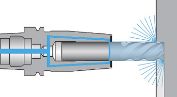

Haimer's Cool Flash toolholder system was designed to direct coolant to a tool's surface with no air gap. Coolant collects in a chamber in the holder then is distributed evenly over the entire circumference of the tool shank. Images courtesy Haimer.
Haimer’s Cool Flash toolholder system was designed to direct coolant to a tool’s surface with no air gap. Coolant collects in a chamber in the holder then is distributed evenly over the entire circumference of the tool shank. Images courtesy Haimer.Through-coolant toolholders: efficient, economical
Similarly, Haimer designed its circular Cool Jet bores to run at 3° angles so that as coolant exits the toolholder, it is aimed directly at the cutting edge. “But even so, when you rotate fast enough, the separation still makes it easier to atomize,” Strauchen said.
This led the company to upgrade its design to one that would deliver the coolant directly to the tool shank with no air gap. “What makes our Cool Flash system unique is that the coolant exits through small perpendicular slits located around the internal diameter of the toolholder,” Strauchen explained. “This not only helps coolant reach the shank, because it’s being directed straight onto it, but by taking advantage of surface tension and centrifugal forces, the coolant is actually being spun up the shank of the tool. So, centrifugal forces are working for us instead of against us.”

Choosing a through-coolant toolholder depends a lot on the application. For example, BIG KAISER’s Mega Perfect Grip toolholder was designed specifically for milling heat-resistant superalloys.
“There’s so much axial force when the cutting tool engages with these materials, it tries to physically pull the cutting tool out,” Miller said, “and the forces can get so high that even with very strong clamping forces, they can slip.”
To counteract these strong forces, the Mega Perfect incorporates a key grip that locks the Weldon flat of a cutting tool into place. In addition, the three slots in the bore where the key can slide down provide holes for the higher volume of coolant delivery needed for these types of applications.

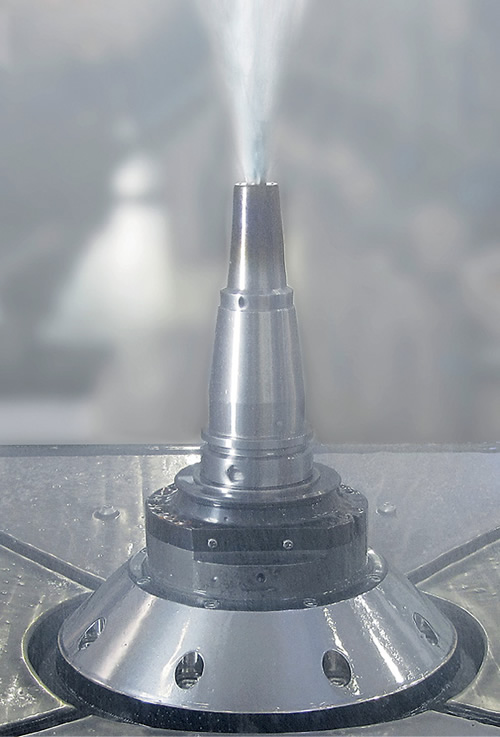

Scientific Cutting Tools' Coolant Ring Technology toolholder provides a 360° coolant delivery pattern. Image courtesy Scientific Cutting Tools.
Scientific Cutting Tools’ Coolant Ring Technology toolholder provides a 360° coolant delivery pattern. Image courtesy Scientific Cutting Tools.
Toolholders that supply a cool blast
There’s more than one way to direct coolant onto a tool’s cutting edges using through-coolant toolholders.
One method is Coolant Ring Technology toolholders from Scientific Cutting Tools Inc., Simi Valley, Calif., which reportedly enhance coolant penetration, such as into a bore. In that scenario with a conventional through-coolant holder, coolant hits the face of the part and splashes back. The CRT holder, on the other hand, delivers coolant all the way around a tool instead of one quadrant of the tool, so wherever there is space to get into the bore, coolant is there. The result, said Scientific, is a 75 percent higher level of coolant penetration.
By effectively delivering coolant to the cutting tip, SCT stated that the tip will only be a couple of degrees warmer than the coolant temperature. But if there is not an ample supply of coolant to the tip, the tool can get hot enough to negatively impact the carbide binder and deformation of the carbide can occur. Also, heat can cause a part to thermally expand and make it difficult to hold a tight tolerance.
