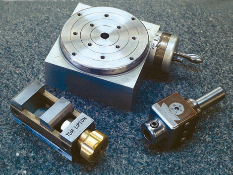

A selection of Thursday night projects.
The shop allowed its employees to work on small personal projects using the company’s facilities and resources.
