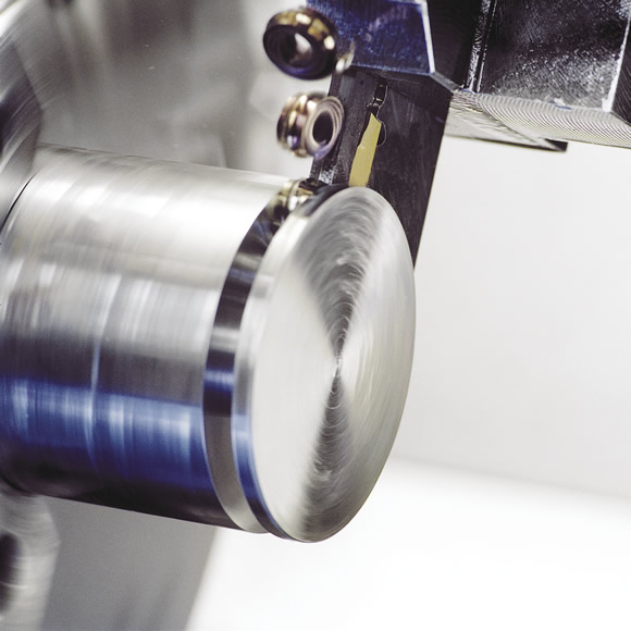

A cutoff operation is suitable for removing various portions of a workpiece.

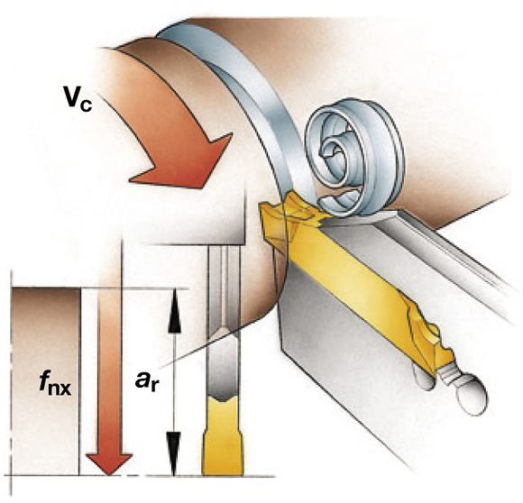

The main cutting data and tool definitions when parting and grooving are: a) Cutting speed (vc) is the surface speed at the cutting edge; b) Spindle speed (n) is measured in rpm; c) Straight, radial feed toward the center of the workpiece (fnx), and d) Radial DOC capability of the tool (ar) is the distance from the OD to the center, or bottom, of the groove when parting.
