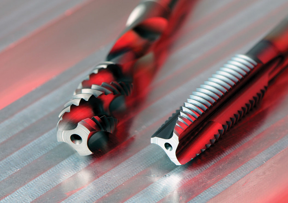

High-performance taps have geometric features to boost their capabilities. One feature is a larger core to strengthen and stabilize the tool, Mintrone noted. Another is a thread relief that’s designed to reduce contact between the flanks of the thread lands and the workpiece, preventing the chip from getting between the workpiece and the cut tap.
“It usually depends on the pitch of the tool, but we’re talking about like 0.02 mm. It sounds like it’s not much, but it is,” he said. “We can’t go too large with the relief because we want to make sure the tool keeps its self-guidance ability.”
The helix also plays a significant role, and the angle depends on the application. “When it’s a long chipping material, we usually go with a 25° up to a 45° helix to ensure good chip evacuation,” Mintrone said. “When it’s short chipping materials like cast iron or bronze, we usually go with a straight-fluted tool or maybe up to a 15° helix.”
For OSG’s A-Tap cut taps, the helix is 45° at the chamfer and transitions to 15° toward the shank. Putek described the A-Tap as the toolmaker’s go-to cut tap and “our best option on the market” for threading steel, stainless steel, cast iron and aluminum, As the helix transitions to 15°, the flute space widens to enhance chip evacuation compared to a constant 45° helix where there is more physical distance to disengage chips from the top.
“The 45° helix at the chamfer helps you increase the rake angle up front towards the chamfer, and that’s going to make it very easy for the chip to start working its way up the flute,” he said. “Then as we get farther and farther back, we want to get those chips away from the flute, and the flute space on our A-Tap actually widens towards the back.”

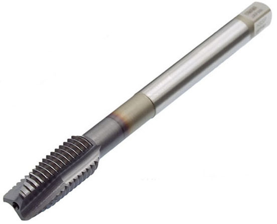

Another high-performance option is the ZELX taps from YMW Taps USA in Santa Ana, California, which are manufactured by Yamawa Manufacturing Co. Ltd. in Japan. The series includes the ZELX SS taps for stainless steel and other materials, ZELX NI taps for cobalt and nickel-and iron-base exotic materials, as well as stainless, mold and tool steels harder than 30 HRC, ZELX TI taps for titanium alloys, and ZELX AL for zinc die cast aluminum, wrought aluminum, silicon die cast, copper and magnesium.
Based on over 100 years of research and development into threading tools, YMW has set the optimal rake angle for each of the many materials, Helfer said. “The lower rake angle would be for the hardened materials like nickel-base alloys. The higher rake angle is for softer materials. “The ZELX SS is what we call our bread-and-butter tap designed for stainless and below,” Helfer added. “It will do low-to high-carbon steels, cold-rolled steels all the way up to 304 and some soft A286.”
The ZELX SS and AL taps are made with a custom blended high vanadium HSS and the ZELX NI and TI taps are made with powdered metal HSS. “We do make some carbide taps but they are mostly straight-fluted taps,” he said.
Helfer pointed out that the TI taps have a large OD and pitch diameter relief. “Titanium alloys have a memory to it, so when the tap backs out it will shrink back down, and we solved that by putting those reliefs on there.”

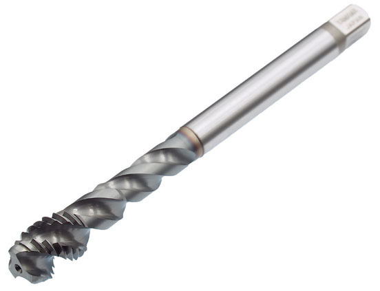

YAMAWA’s latest tap offering is the Z-PRO series, which has an extended length to make it easier to evacuate chips and feed coolant, according to Helfer. It makes the chips come out in a wide fan, so they are not tangling up on the taps — a benefit that’s increasing in demand as many manufacturers are introducing high-performance machining centers and promoting automation to improve production efficiency.
“Adoption of the Z-PRO series, which prevents chip related problems and enables stable, continuous machining, is rapidly expanding,” Helfer said.
The Z-PRO includes VUSP spiral-fluted taps and VUPO spiral-pointed taps, which come standard with a TiCN coating, he said. “We can make the best recommendations to customers according to what their application is.”

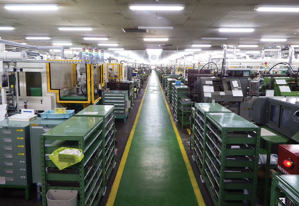

Yamawa builds its own thread grinding machines to make taps, Helfer added. “This is because taps for tapping highly reliable screw threads require even higher precision, and our machine tool manufacturing department can carry out maintenance at the appropriate timing to constantly keep the high precision of our thread grinding machines so that we can continue to produce these high-precision taps stably.”
Ultimately, a high-performance tap is not necessarily designed to last longer or thread faster than a conventional tool; it is meant to produce reliable screw threads. “We try to sell taps for the high precision internal threads by price per hole and not price per tool,” Helfer said.
