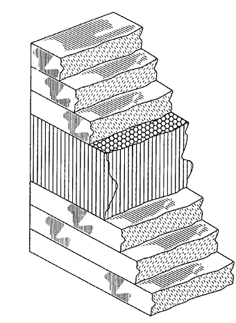

1. Composites. Deburring composite materials tops the list. Some composites are comprised of two metals while others, such as electrical circuit boards, may have layers of different plastics, ceramics and metals. Aircraft materials like carbon fiber-aluminum combinations have significantly enhanced strength-to-weight ratios, but part edges must meet strict requirements, for obvious safety reasons.
The free edges (top and bottom exposed surfaces) of composite laminates are especially susceptible to cracking, higher stress, delamination, water absorption, ongoing fraying and chemical attack, all of which negatively impact product life or performance. Deburring can cause, prevent or improve any of these issues.
Because each material in a composite requires a different “treatment” to generate acceptable edges and surfaces, the best process to improve one material’s quality characteristics may worsen others.
Deburring composite materials is particularly challenging. Photo credit: U.S. Patent and Trademark Office
Courtesy of U.S. Patent and Trademark Office
Deburring composite materials, such as this one with seven component layers, is particularly challenging.
But there is another, more subjective issue: What determines an edge when machining different layers of material? People generally think an edge is what they see on the outer surface, but in composites, every transition from one layer to another can be an edge. Thus, a product may have many internal edges, and each may be critical to product performance.
To help minimize burrs and finish edges when deburring composites, understand the material properties in the composite and what the real customer quality criteria are—at each interface. Although several may meet the minimum requirements, pick the best machining/finishing process.
Apply the best cutters, which will require working with toolmakers to tap into their knowledge base. Also, use optimal cutting conditions and keep the layers tightly together.

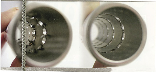

2. Intersecting holes. Intersecting holes have a 3D edge configuration, and the burr thickness and height changes at each point on the intersection. This means a deburring process based on a consistent burr size may not work well.
In addition to swivel hand tools, examples of deburring tools for intersecting holes include Cogsdill Tool Product Inc.’s Smooth Edge Deburring Tool, J.W. Done’s Orbitool and Brush Research Manufacturing Co. Inc.’s Flex-Hone. Thermal deburring is also highly effective on deburring intersecting holes in many metal parts, even ones with relatively small holes. If intersections have to be smoothly finished, electrochemical deburring and Kennametal Inc.’s Extrude Hone abrasive flow machining provide high-quality edges for almost any configuration. On large holes, abrasive-filled rubber or paper bullet shapes are quick and effective.
The Flex-Hone from Brush Research Manufacturing is one tool that's effective for deburring cross-holes. Photo credit: Brush Research Manufacturing
Courtesy of Brush Research Manufacturing
The Flex-Hone from Brush Research Manufacturing is one tool that’s effective for deburring cross-holes. A surface prior to treatment with the Flex-Hone (left) and after treatment (right).
The challenge becomes much more acute when the holes are smaller than ⅛ ” (3.175mm) in diameter and deeper than 10 times diameter because most tools or processes cannot reach into those configurations. One example of difficult-to-deburr, deep intersecting holes is found in engine crankshafts, because removing all burrs typically must be done in 4 seconds or less, as noted earlier. The rate of deburring makes it challenging.

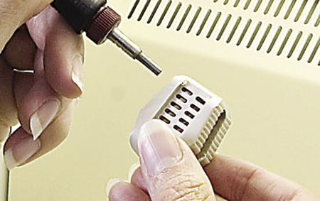

5. Polyether ether ketone. PEEK is one of those materials used by the medical and aerospace industries for various reasons, including strength, inertness and, for medical parts, biocompatibility. But machining PEEK often leaves a feather-thin burr that many manufacturers find difficult to remove without affecting surface finish, size, color and other part requirements.
Patrick Byrne, sales and marketing manager for Comco Inc., Burbank, Calif., a manufacturer of miniature abrasive blasters, explained that while it is difficult to safely deburr PEEK with small knives, a micron-sized soft abrasive directed at high velocity on the target deburrs without damaging intricate part geometries and finishes. Cryogenic tumbling also works for removing external burrs on some PEEK parts.
When deburring PEEK parts, a micron-sized soft abrasive directed at high velocity on the target deburrs without damaging intricate part geometries and finishes. Courtesy of Comco.
Courtesy of Comco

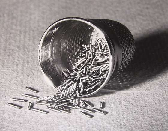

9. Micro mechanical components. It’s always been a challenge to make microparts—such as gears, extremely thin levers and escapement plates—that have burr-free edges at 30× magnification and smooth edge radii that do not exceed 0.001 ” (0.025mm). Today, the requirements call for even smaller and thinner parts, in quantities from a handful to millions and in an array of materials not previously imagined. The minute part size, microscopic tolerances, extreme criticalness of edges and challenge of machining advanced titanium alloys, shape-memory alloys and other newer metals and plastics further complicate edge finishing of microparts.
Chemical deburring, electropolishing, centrifugal barrel tumbling and manual deburring are suitable for many of these parts, but sometimes the only solution is to prevent burr formation in the most difficult-to-deburr areas. The microstamping industry is probably the best example of this burr-free approach, but those who laser machine parts have also developed solutions, such as using picosecond and femtosecond lasers that leave no burrs on many materials. The leaders in micromolding have similarly spent a lot of experimental time to examine fluid flow and minimize flashing on microparts. While lasers may be able to quickly burn the flash, handling the parts to better orientate the flash takes time and money that can be better applied elsewhere.

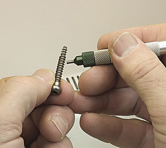

10. Microscale medical parts. The medical field is another challenging area for deburring, but, surprisingly, the use of lasers followed by electropolishing has successfully removed laser debris, which is technically molten metal, from stent edges. Other medical components that go into the body, such as bone screws, plates, heart-assist devices and items to suppress pain, have to be free of burrs to prevent metal particles from getting into the blood stream and entering the heart and irritating or cutting adjacent tissue. The edges left after deburring, like the rest of the product, must be surgically clean. Because the products or the edges may only be slightly larger than the diameter of a human hair, magnification is required to determine if burrs are present.
Components that go into the body, such as this bone screw, must be free of burrs to prevent metal particles from entering the blood stream. Courtesy of Comco.
Courtesy of Comco
In addition, the microscopic operating tools have stringent edge requirements. Surgical instruments must have sharp, burr-free edges. This requires extreme edge finishing on minute edges and, again, a surface that’s free of bacteria and other pathogens.
