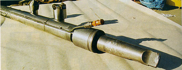

After some brainstorming and scrounging around the shop, Schuster came up with a new plan: Devise a tool/toolholder system that would be long enough to machine the bore in one pass. The tool portion of the system was a 2.25″-dia., HSS ballnose endmill. The toolholder was an old Beaver Rapid quick-change holder with a No. 5 Morse taper (Figure 2).
Tough Bores
Figure 2: Using an old Beaver Rapid toolholder, PSC built its own extended holder to machine the bore in one pass.
PSC turned a 26″-long piece of heat-treated 4140 steel until its diameter was 2.50″—roughly 0.002″ to 0.003″ larger than the holder’s inner diameter. The shop heated the holder and inserted the bar into it. Then PSC drilled and reamed two setscrew holes at the boring end of the bar and tightened the endmill in place with setscrews.
The first pass with the “new” boring system went nowhere. Almost as soon as the lathe fed the endmill into the bore, it burned up. Schuster discovered that coolant discharged from the turret fitting was not reaching the cutting zone and, therefore, was not dissipating heat.
He decided to mill a slot the length of the holder and solder a standard automobile brake-line tube into it. This delivered ample coolant to the cutting edge, but the next endmill bored just 4″ before failing.
A harder cutting edge seemed to be the answer. Schuster thought that a facemill with carbide inserts might do the trick. But he couldn’t find a standard facemill/insert combination that would fit the bore. And a custom tool would take weeks—well past the scheduled delivery date for the caster rolls.
Then a PSC machinist volunteered to become a weekend toolmaker. Using a commercial indexable facemill as a guide, he fashioned a tool on the Bridgeport milling machine at his home. It accepted three 3/4″-dia., button-shaped, TiN-coated carbide inserts (Figure 3). Though not overly sophisticated, the tool worked.
Tough Bores
Figure 3: One of PSC’s machinists made a facemill that allows boring to the correct diameter in a single pass.
Running at a speed of 120 sfm and a feed rate of 0.020 ipr, the tool completed a 12″-long bore in a single pass. Problems associated with heat buildup, however, required the operator to index the inserts after each pass. So the speed was dropped to 70 sfm and the feed was increased to 0.038 ipr. At these parameters, the tool completed three to five parts before indexing was necessary.
Schuster refined the process further. He had a second facemill made, allowing inserts to be changed offline. Also, operators now bore the first 1″ of the hole with a standard boring bar. This provides the same advantage as a spot drill: minimizing deflection from the centerline. A third refinement was to add a steady rest, which provides extra support for the part.
The only drawback to the tool is the 1/4″ socket-head cap screws used to hold the inserts. Coolant pushes chips into the screws, causing them to wear rapidly. While the screws must be replaced as frequently as the inserts, the tool is still very cost-effective. It bores at 3 to 5 ipm and averages six pieces per hour.
Schuster estimated that his total nonperishable investment was about $500. That small outlay let PSC go from losing a lot of money per part to making a little. But, more importantly, it allowed the company to meet the needs of a valuable customer.

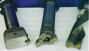

The company considered ID-grinding the three 8″-deep bores, but decided it would be too expensive. So it opted for a combination of standard tools made by KPT Kaiser Precision Tooling Inc., Elk Grove Village, Ill. (Figure 5).
Tough Bores
Figure 5: Schmiede solved its boring problem by using a combination of standard tools.
Schmiede starts by drilling the parallel holes with a 2.5″-dia. indexable drill fitted with TN-15-grade inserts made from C-6 carbide. The inserts have three coatings: titanium carbide on the substrate, a middle layer of aluminum oxide and a top layer of TiN. The drill is run at a speed of 500 sfm and a feed of 0.005 ipr.
At this point in the production process, the holes are parallel but do not overlap. Next, a set of three modular, twin-cutter boring-head tools rough-bore the parallel holes. Each tool removes 0.50″ of stock, widening each hole’s diameter to 4.075″. During this phase, the interrupted cuttting begins as the boring head starts to break through the wall of material that separates the two holes.
Jack Burley, product manager for KPT, explained that the two inserts in each boring head are offset 0.010″ from one another. This technique, called “step cutting,” increases the metal-removal rate, results in the production of thinner chips and requires less spindle horsepower than using a single insert.
The boring-head inserts are a TNP-11 grade made from C-7 carbide. Titanium carbonitride is bonded to the substrate, followed by a layer of Al2O3 and an outer coating of TiN. The first pass is made at a speed of 500 sfm and a feed of 0.007 ipr. For the next two passes, the feed remains the same while the spindle speed drops to 538 and 470 rpm, respectively.
The next step is to drill the cross hole with the 2.50″-dia. indexable drill. The cross hole is then rough-bored in three passes to a 4.075″ diameter, in the same manner as the parallel bores.
The finish diameter of all the bores is 4.0906″ (±0.0002″). The remaining 0.0156″ of stock is removed using a KPT high-precision boring head. It is equipped with a micro-adjustment feature, allowing the diameter to be changed in 0.0005″ increments without dial indicators or special presetters. A cermet insert makes the finishing pass at a speed of 670 sfm and a feed of 0.004 ipr.
The combination of boring tools lets Schmiede meet the finish requirement of 20 rms without grinding.
