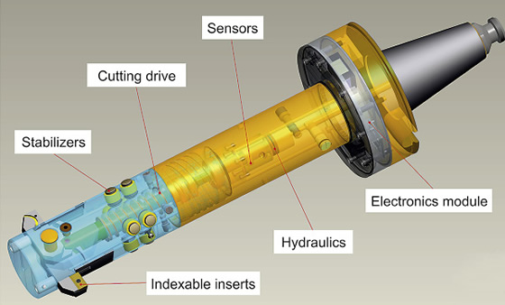

Therefore, GFE developed a prototype mechatronic cutting tool for these applications, which uses bidirectional telemetry to gather information about tool status during cutting. (Mechatronics incorporates mechanical and electronics engineering concepts.) “The use of mechatronic tools with integrated sensor-monitored actuators can help reduce the amount of work required when back counterboring and back spotfacing on large machining centers while retaining high levels of process dependability,” Aschenbach said.
Depending on the application, he noted a mechatronic tool can use magnetic Hall and eddy current sensors, optical sensors such as cameras and lasers, and other sensors to monitor and influence the machining process, but they have no direct influence on the tool. For example, two Hall sensor integrated circuits can monitor the end positions of a hydraulic cutting drive, or piston, which tilts the cutting edges. Coolant actuates the piston, causing the insert holders to pivot outward, and the tool can be guided axially back through the pilot bore after the coolant is turned off, causing the insert holders to pivot inward.

3-D%20model.tif
Courtesy of GFE
A 3-D model of the prototype mechatronic cutting tool for back spotfacing and back counterboring.
The data is transmitted to the stationary interface, or base station, at a frequency of 430MHz, and signals from the interface can control the machine, such as stopping the machine when a malfunction occurs. “Our prototype transmits the angular positions of the cutting inserts,” Aschenbach said, adding that the interface can be located in a machine’s control cabinet.
