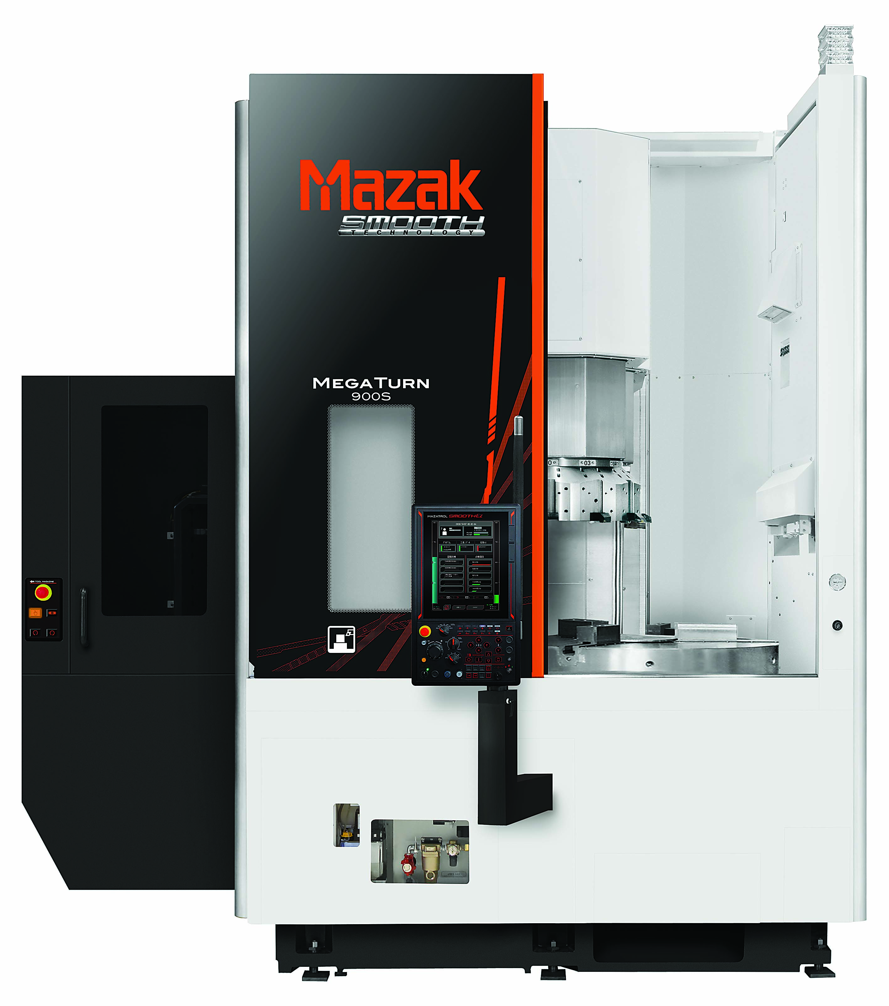

Courtesy of Mazak
The Megaturn Nexus 900 VTL from Mazak turns large parts in a comparatively compact machine envelope.
Turning a lathe vertical can be a productivity turn for the better—for large and small parts.

Rick Ware, vice president, sales and marketing for Mazak Corp., Florence, Ky., said the market for large traditional-style vertical lathes shrank through the late 1990s and early 2000s, a trend he attributed to declining demand for very large parts. In addition, “People were beginning to do machining on multitasking-style platforms, and just didn’t buy the big machinery,” he said. However, large part making is growing again, including components for wind turbines and other energy-related applications, as well as big parts for marine, railroad, construction and agricultural equipment, he noted.
Regarding parts best suited for a vertical lathe, heavier and bulkier parts with large swing (diameter clearance) requirements are typically machined on a vertical rather than horizontal lathe. A key consideration is ease of part handling and setup.
“You don’t have to chuck a large part horizontally; you just drop it down on the table and clamp it,” Ware said. “Part loading and unloading is much easier. Loading a large part on a horizontal is a little more exciting for the operator, but not nearly as safe, and I tend to prefer safe more than exciting.”
According to Ware, machines like the Mazak Megaturn Nexus 900 are appropriate for large-part machining. The vertical lathe enables turning relatively large parts in a comparatively compact machine envelope. The Megaturn 900 features a moving, rather than fixed, column supporting the cutting head. With a fixed column machine, the head moves on a cross-rail, and the swing capacity of the machine is limited to the cross-rail’s length. Overhead interference with the cross-rail also limits the height of parts being machined.
To maximize the part size a Megaturn machine can handle, the turret head is mounted on a column, instead of a cross-rail, that moves left and right in the X-axis. That enables the machine to handle larger-diameter and taller parts by avoiding turret interference that would occur with a fixed column/cross-rail in a comparably sized machine. Mazak says the machine is appropriate for parts up to 920mm in diameter and as tall as 800mm.
