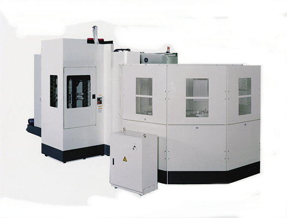

Courtesy of Kitamura Machiney of USA
Kitamura’s HX400i FTGA 8APC system is an HMC with an eight-pallet system.

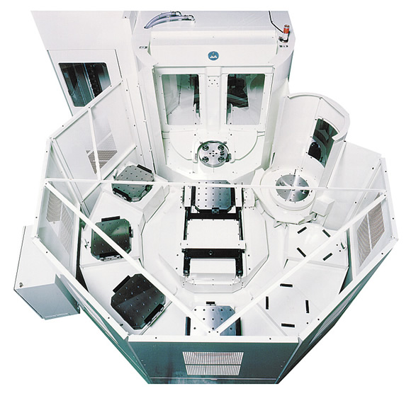

Generally, a standard HMC has two pallets, which the operator sets up manually. The most common size in the U.S. is the 500mm (20 “) square, followed by 400mm and 630mm square machines. The majority of automated pallet systems are used in conjunction with HMCs with 3-, 4- or 5-axis motion.

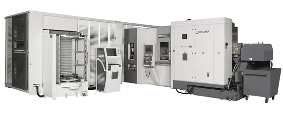

Courtesy of Okuma America
Okuma’s MB-5000H HMC with a base Palletace C1000 10-pallet system. It is expandable to three MB-5000H machines and two additional C1000 extensions for a 30-pallet system.

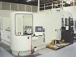

One smaller shop that is utilizing pallet automation for unattended machining is West Valley Precision Inc., San Jose, Calif. The 35-man shop produces Invar, stainless steel, aluminum and plastic parts for medical instruments.
WVPI has about 20 machine tools, including a Kitamura HX500i horizontal machining center with 150-tool capacity and eight pallets, which it has had for about 3 years, and a Kitamura SuperCell 400mm 5-axis HMC with 190-tool capacity and 40 pallets, which it has had for about 2 years.
“The automated system has a huge tool library on it, so all of the tools you need to machine a setup pallet are on that machine,” said Dane Madsen, WVPI president. “Being able to use the same tool on many different jobs is a function of your tool library. Every time that job comes up, you just pull that program and it will grab that pallet with the material on it just like it was the next part on the machine, even a couple of months later.”
As for unattended machining, the shop’s longest production time is on the HX500, running eight pallets and having the machine busy for 56 hours.

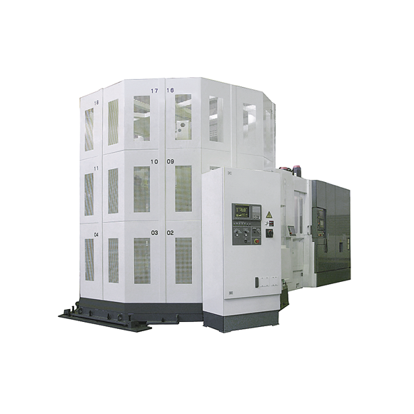

Kitamura’s HX400iFTGA with a 21-pallet system stacks upward, which is effective for smaller shops because it takes up less floor space.

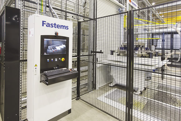

Courtesy of Fastems
Fastems’ MMS5 Data Manager automation software presents tools for production management. It creates job lists for load stations and machines, and decides which tools and materials will be needed during the schedule.
