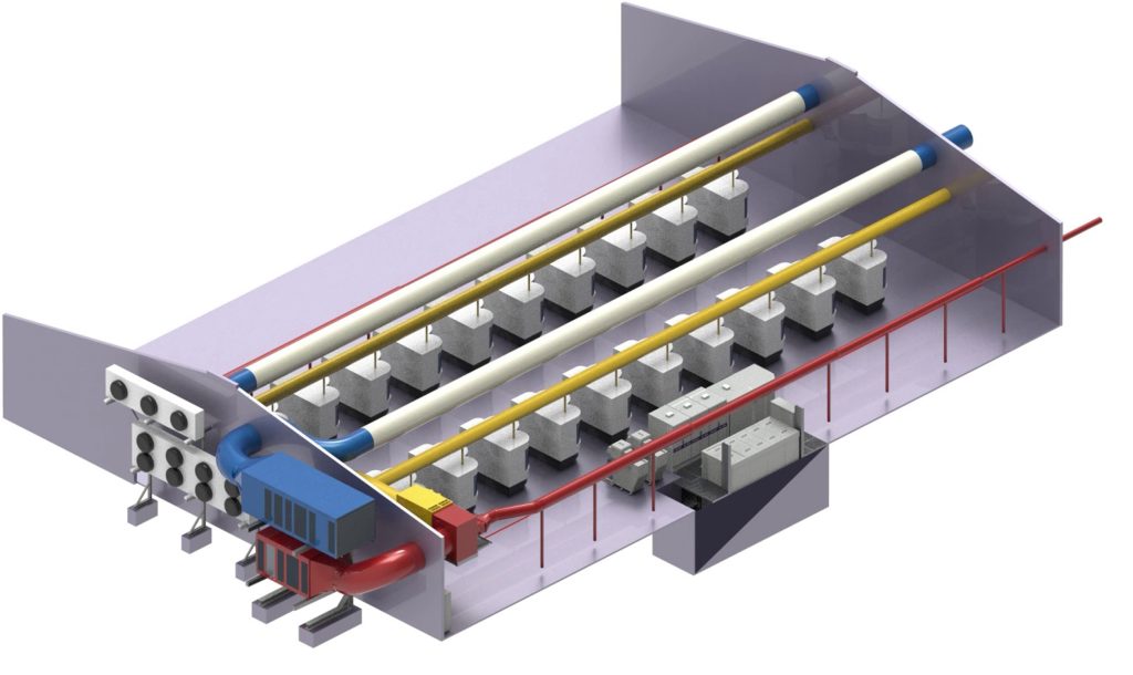

As displayed at the AMB show in Stuttgart, Germany, the Vomat air handling unit LBG guarantees 100 percent air exchange, and uses excess residual energy from production and peripheral systems to heat a production facility efficiently in winter or cool it in summer.
Lubricant expertise leads to energy production
Fully automatic mixing and dosing system (MDS).
Air conditioning technology is a special topic in connection with cooling of cooling lubricants. Based on this expertise, Vomat developed a new air conditioning unit that converts excess energy from production and peripheral machines, such as grinding machines, oil extraction systems, machine pumps, and can then use it to heat or cool, the production hall via the air conditioning shafts with an accuracy of ±1 degree Celsius.
Steffen Strobel, technical sales manager at Vomat said “Our new full air conditioning system consists of a central exhaust air extraction system and a fresh air supply unit. On the one hand, this ensures 100 percent air exchange with optimum air distribution in the production area without recirculation.
“On the other hand, the system is designed in such a way that exhaust air heat, for example, as well as existing residual energy in heat pump operation can be used for both heating and cooling – and this up to 60 percent more energy-efficient than conventional air conditioning systems.” In addition, there is the option of regulating humidity or dehumidifying the air in the rooms to be air-conditioned. Vomat manufactures customized solutions ranging from standard solutions to special complete solutions.

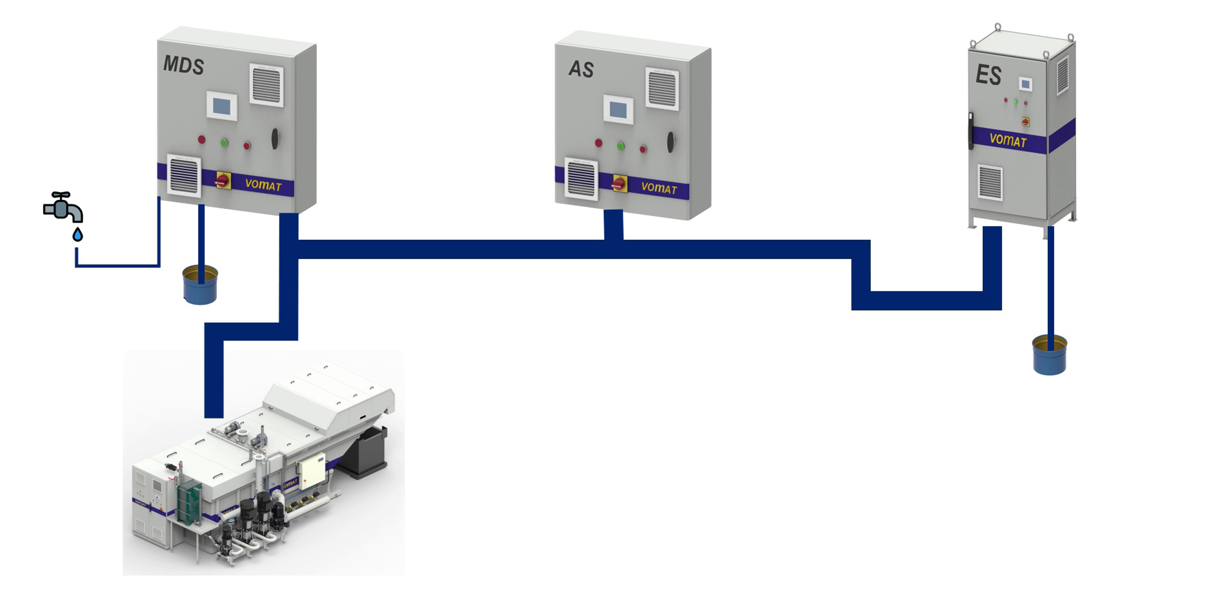

Water-miscible coolants
The systems for maintaining water-miscible cooling lubricants are also new: For example, the fully automatic mixing and dosing system (MDS), which regulates the defined ratio of water quantity and cooling lubricant concentrate with high precision. In addition, an analysis tool (AS) determines the content of process-destabilizing contaminants during the filtration process, which are then removed via a special extrusion system (ES).
Steffen Strobel, said “Our new dosing system is modular, energy-efficient and compact. The modules can be connected to all common filtration systems on the market and help to significantly increase the service life of cooling lubricant.”
