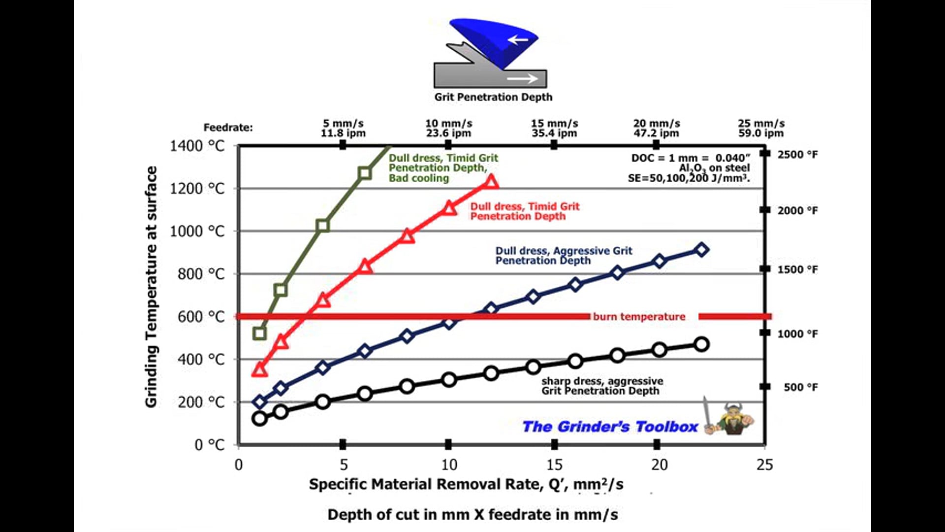

A shop seeks relief from the burn experienced during its creep-feed grinding operations. Given that slowing down the feed rate only helped a little, and only for a short time, the shop for an alternative solution from Dr. Jeffrey Badger, our Ask the Grinding Doc columnist.
December 16, 2016
A shop seeks relief from the burn experienced during its creep-feed grinding operations. Given that slowing down the feed rate only helped a little, and only for a short time, the shop for an alternative solution from Dr. Jeffrey Badger, our Ask the Grinding Doc columnist. Visit The Grinding Doc website for more advice from Dr. Jeffrey Badger at
