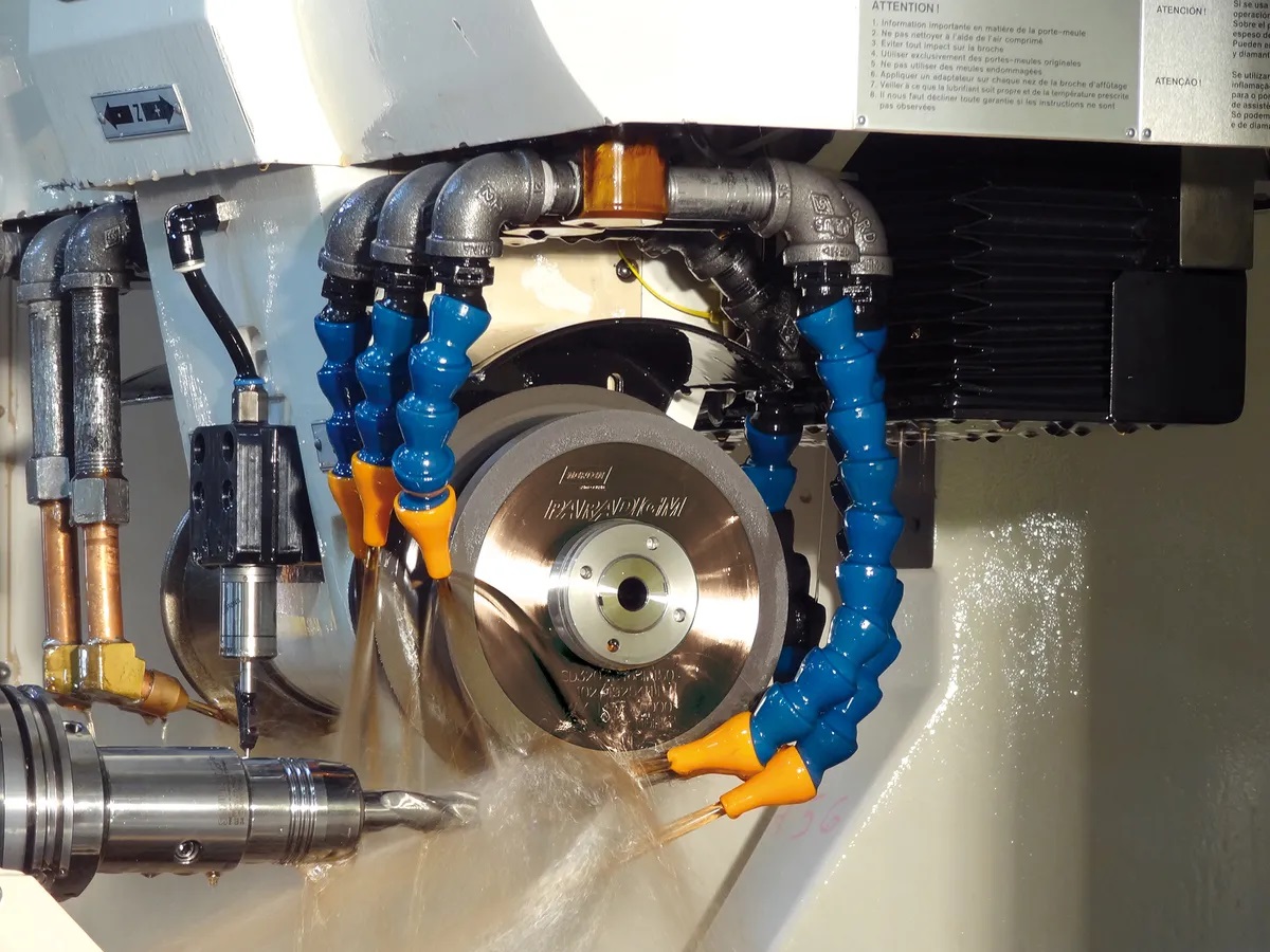

At the recent IMTS 2024 show, Norton Abrasive, a brand of Saint Gobain, showcased its Paradigm Plus diamond grinding and GForce Plus wheels that featured new premium grain technology that Alfredo Barragan, senior application engineer at Norton, said results in a significant upgrade in performance on carbide round tools for fluting and gashing applications, and periphery grinding on carbide, cermet and ceramic inserts grinding.
The new grain technology, together with a new advanced lightweight core, produces lower specific cutting energy with a 25% to 50% higher material removal rate (MRR), and provides significantly improved wheel life when compared with previous generation wheels.
Norton Paradign PlusParadigm Plus Diamond Grinding Wheels feature a new premium grain technology.“>
“You can achieve higher material removal rates,” he said. “It reduces specific grinding forces, huge gains in productivity, and you can reduce cycle time with the same or better [grinding wheel] life.”
The wheels’ new grain technology results in lower normal forces and higher performance, which is complemented by an improved hybrid bond technology providing significant improvement ranging from a 25% to 50% increased MRR, and longer wheel life when compared with current G-Force wheels, said Barragan.
New G-Force Plus Wheels offer higher feed rates and reduced cycle times, resulting in more parts per dress and reduced process costs. Improved edge holding, better part quality and surface finish are all key benefits of the new wheels. G-Force Plus Wheels provide cooler cutting when grinding a range of heat- and wear-resistant materials.
One reason that it achieves these improved is the lightweight core that is “no longer made of steel,” said Barragan. “Before that, [the core] was made with steel that was really heavy and it tended to put a huge stress on the machine spindle. Usually, it’s 50 % or lower [in weight] compared to steel. By going lighter, you definitely have better surface finish, and more vibration dampening, so it’s another win-win for the wheel, for the machine.
