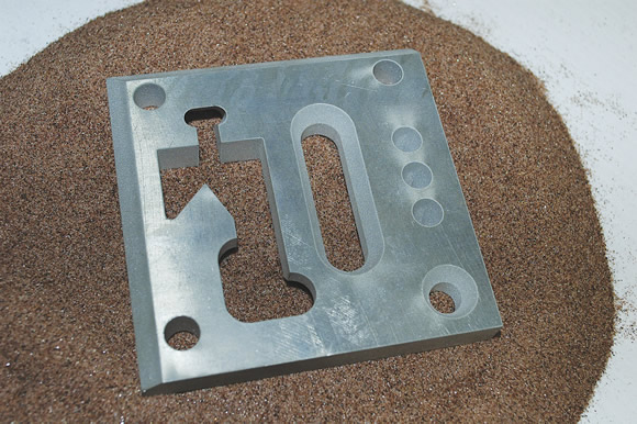

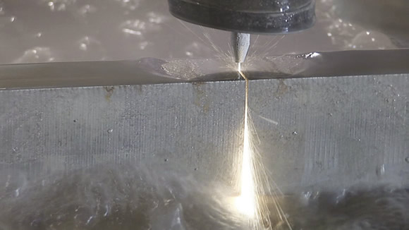

Waterjetting can cut a broad range of materials, including aluminum, brass, copper, stainless steel, nickel alloys, titanium and composites, and thicknesses. Typically, an abrasive waterjet cuts any material up to 6 ” thick, but cutting thicker materials is possible. “We’ve cut 16 ” of Inconel,” said Ben Callahan, regional sales manager for Jet Edge Inc., St. Michael, Minn., a waterjet systems manufacturer. “It is slow, but it can be done.” He noted Inconel is difficult to cut with conventional machine tools because it workhardens rapidly and either the workpiece or cutting tool can plastically deform.
A big advantage of waterjet machining is it doesn’t create a heat-affected zone (HAZ) and it doesn’t change the molecular structure of the material it is cutting. “Because waterjet cutting is a cold cutting process, it does not interfere with the intrinsic properties of the material,” said Chip Burnham, vice president of marketing for Flow International Corp., Kent, Wash., a waterjet machine builder. “No HAZ or mechanical stresses are left on a waterjet-cut surface.”
Another advantage is there is no, or minimal, burr creation. Thin materials cut via waterjet can sometimes have a burr unless very fine abrasive is used, noted Jeff Day, sales manager for WARDJet Inc., Tallmadge, Ohio, a waterjet machine builder.
Although waterjet machines are not as accurate as conventional machine tools, such as mills and lathes, they can potentially achieve ±0.003 ” tolerances or tighter. If the job requires tighter tolerances than a waterjet can provide, waterjetting is also good for producing semifinished or near-net-shape parts suitable for finishing with conventional machining.

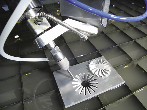

Abrasive waterjet systems can cut a broad range of materials, such as this thick titanium workpiece.
Courtesy of WARDJet
WARDJet’s Psy-Winder 5-axis cutting head was used to cut this fan blade from ½ “-thick aluminum.

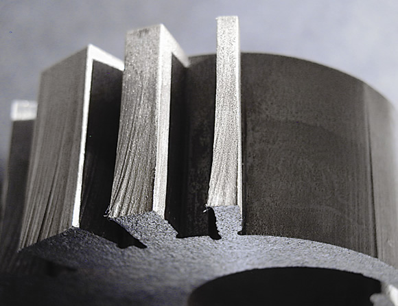

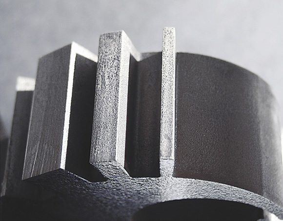

Another big problem was the natural bend of the abrasive waterjet stream. “Because the jet bends as it is cutting forward, it tended to undercut in corners and swing wide around bends,” Parry said. “The only way to compensate for this was to slow the cutting speed. Programming the machines so you could make an accurate part was a real bear. It took a lot of programming and operator experience and a lot of trial and error.”
Eventually, researchers developed a computer model that could predict how the jet was going to bend. “This meant I could write a program to allow me to automatically compensate for the bend,” Parry noted.

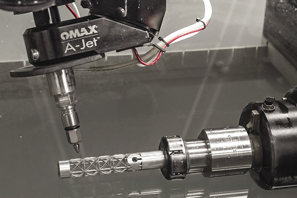

Today, waterjet control systems have expanded to accommodate articulated cutting heads that can make angled cuts, moving from 2-D to 3-D capability.
Courtesy of OMAX
The OMAX A-Jet cutting head used with a rotary axis allows for 6-axis cutting.
“Two-dimensional taper-eliminating systems are designed only to compensate for the inherent inaccuracies in the waterjet process and this provides an accurate 2-D part,” Flow’s Burnham said. “Three-dimensional systems use this same logic, but allow the operator to add bevels, countersinks and other 5-axis profiles, so the part off the table will be 3-D.”
Another trend is using a computer-controlled rotary axis that allows cutting cylindrical parts. “A rotary axis provides the ability to do cylindrical parts and make special cuts in tubing,” OMAX’s Parry said. “Combine the articulating head with the rotary axis and you can make all sorts of wild bevels and intersections on pipes and tubing.”
