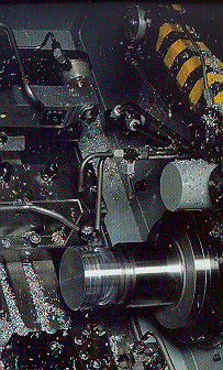

Turning, Milling. Roughing cuts made in high-silicon aluminum with PCD tools should be done at the maximum practical feed rate and DOC.
Abrasive Personality
When machining high-silicon aluminum, it’s important that the machine tool used be equipped with high-quality spindles and axes drives, and that the tools are mounted in rigid toolholders.
If surface finish is not a consideration, good starting points for turning are a 1,700-sfm cutting speed and a 0.015-ipr feed at a 0.060″ DOC. For milling with a 4″-dia., 5-tooth, 45° lead-angle facemill, for example, start at 1,700 sfm (1,600 rpm), a 0.075-ipr feed, which calculates out as a 0.015-ipt chip load, and a 0.060″ DOC.
The total DOC should not exceed 60 percent of the tool tip’s length, as measured from the nose back. Exceeding 60 percent of the length can cause catastrophic failure of the brazing that secures the tip to the carbide insert.
As the DOC is increased, the cutting speed should decrease. For example, the draft angles of a casting increase during the cut, so periodic speed adjustments need to be made. An alternative is to simply preset the surface-speed adjustment to the largest DOC. Be careful, though, if you try to use a constant surface footage to make a facing cut. Material that is removed along the draft angle of the casting will often build up as you approach the workpiece’s centerline.

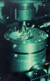

Drilling, Reaming, Tapping. Until a few years ago, the technology did not exist to economically drill or tap with a diamond tool. Today, PCD diamond-tipped drills, step drills, reamers and rotary form tools are available from several prominent suppliers. Tapping, however, still relies largely on carbide technology.
Drilling hypereutectic aluminum with a standard HSS twist drill is an exercise in futility. Sometimes, carbide drills used to produce shallow holes (0.250″ and smaller) will provide adequate results. But a PCD-tipped drill should be employed whenever possible.
The abrasive nature of high-silicon aluminum is the chief nemesis of drill wear life. This is primarily the result of two factors: chip packing and dwell time inside the hole. Optimum flute and drill-point designs, in conjunction with proper coolant technique, are imperative to success. Flutes with high-helix angles are more effective at chip removal than standard drills with lower helix angles. When combined with a coolant-fed body, high-helix drills can handle most deep-drilling tasks.
The value of high-pressure coolant systems for hole work cannot be overemphasized. High-helix flutes and a high-pressure through-coolant tool can extend drill life dramatically. The extent of the improvement is application-specific.
To give you an idea of the production gains possible, I once used a standard 0.250″-dia., PCD-tipped drill to produce a 0.550″-deep hole in high-silicon aluminum. With flood coolant, I drilled 30,000 pieces. After switching to a high-helix, PCD-tipped drill with high-pressure coolant, the part count climbed to over 100,000 pieces.
