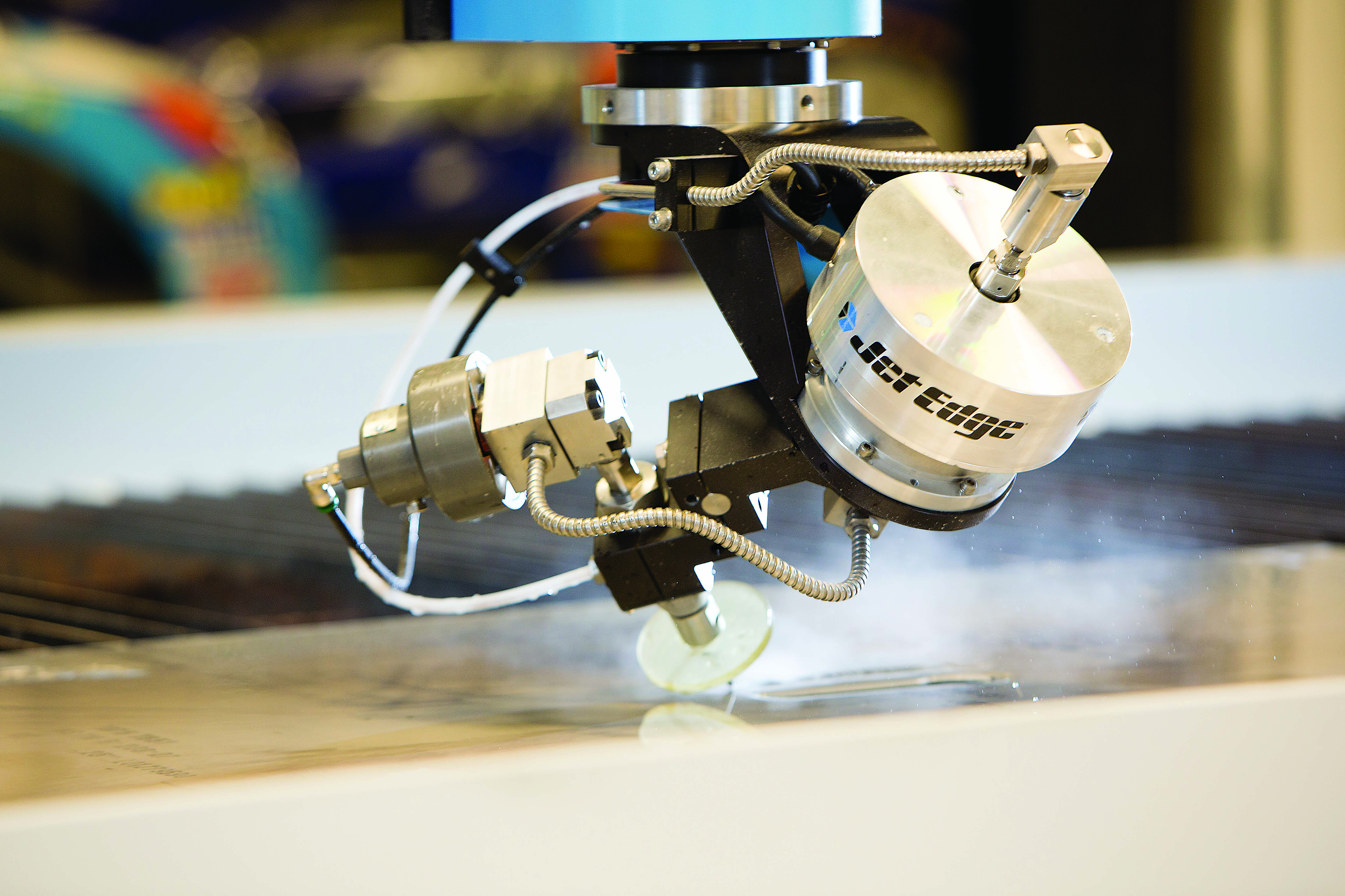

Advancements in controls and software were key in the development of 3D cutting at Jet Edge Inc., St. Michael, Minn., according to Engineering Manager Michael Wheeler. The more axes that need to be coordinated to achieve a cut, the more complex the system becomes, he said. In a 1D cut—typically slitting applications—only one motor is
controlled. In a 2D system, two or three motors, depending on system configuration, need to be coordinated. “However, 5-axis cutting requires coordinating six motors. Our AquaVision Di motion controller has continuously evolved to meet the demands of adding additional axes of motion.”

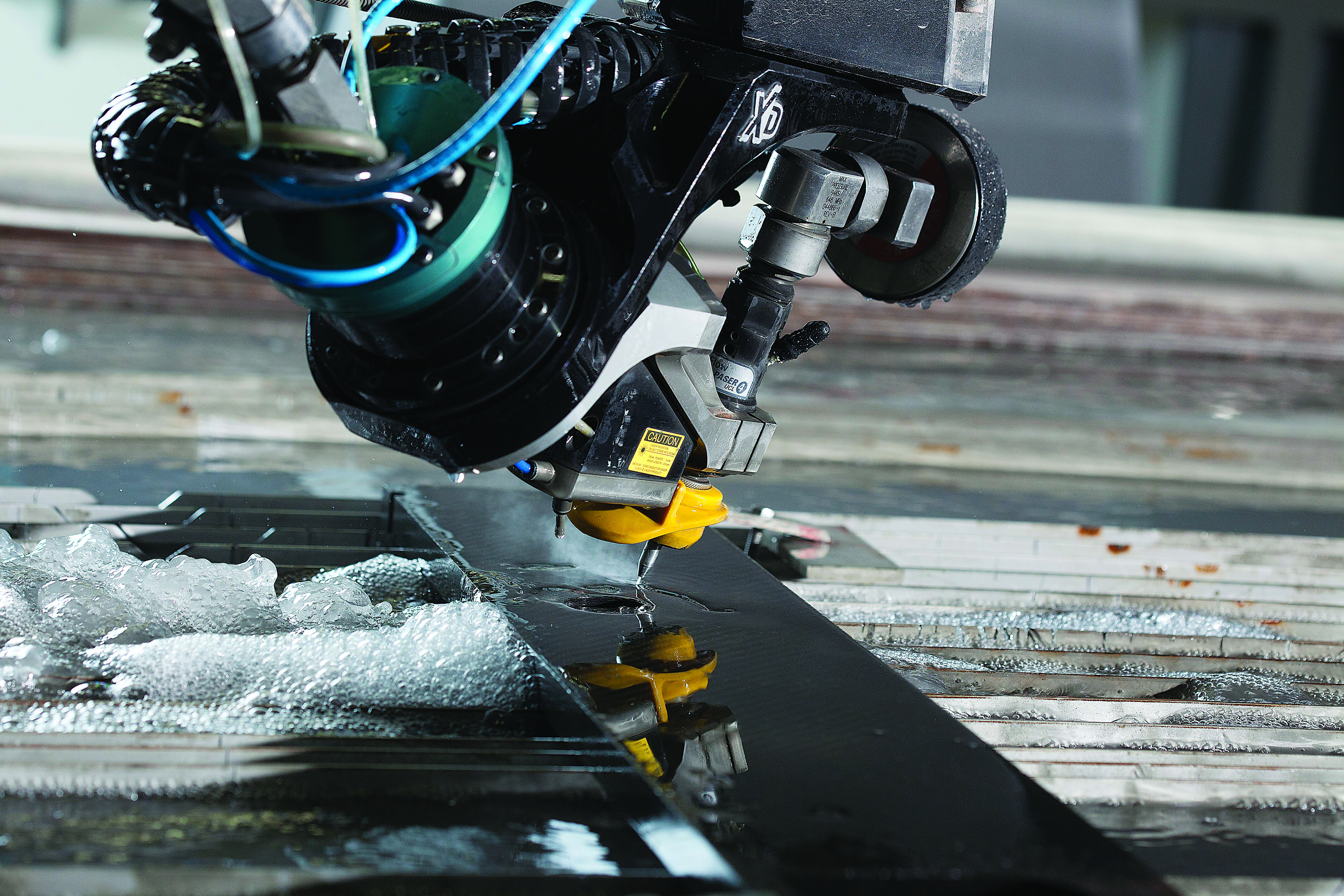

Another advancement was making a cutting head that could compensate for taper in the cut, said Brian Sherick, vice president of sales at Flow International Corp., Kent, Wash. As the waterjet cuts, its energy is dissipated, he explained. “It imparts a V-shape to the cut—the top of the cut is thicker than the bottom. The faster one moves the jet, the less time the stream has to remove material.”
About 12 years ago, Flow patented its Dynamic Waterjet XD system, wherein the head compensates for taper by adjusting the angle “in such a way that all of the taper is on the scrap side. The side of the part, the side that matters, has a consistent, clean cut.” The company’s Dynamic Waterjet XD is the 5-axis version of this taper-compensation technology.

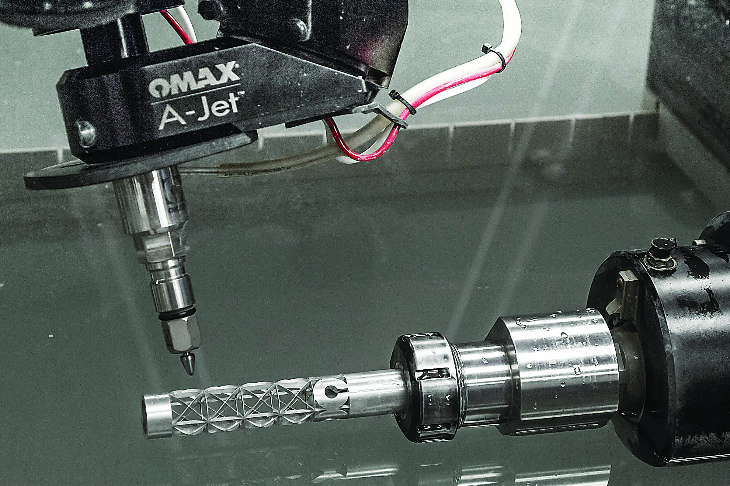

The OMAX A-Jet is completely programmable and automatic. Image courtesy of OMAX.
In 2014, OMAX introduced IntelliCAM software. Among other functions, it allows users to create 3D paths from CAM drawings, Bruner said. “It becomes the software’s task to figure out the best way to cut the part.”
