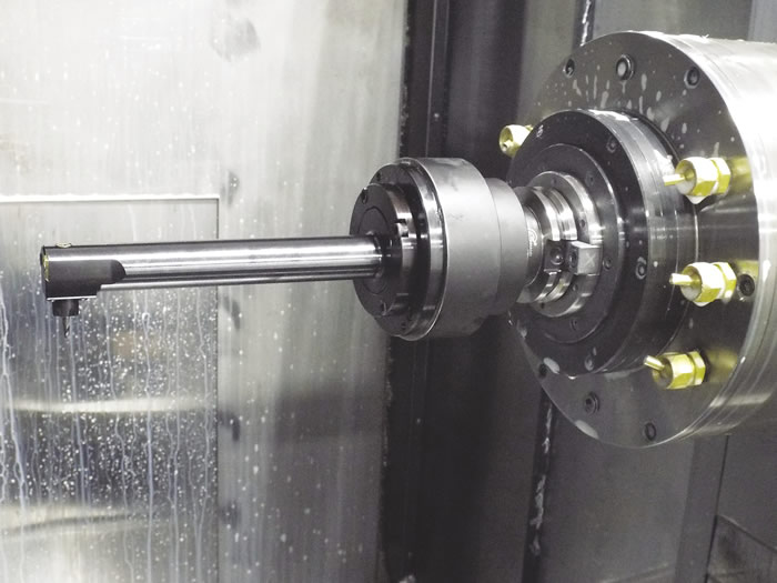

Antron Engineering and Machine applied a Titespot angle head from Eltool to mill an interrupted slot in a small-diameter bore.
Antron Engineering and Machine applied a Titespot angle head from Eltool to mill an interrupted slot in a small-diameter bore. Image courtesy Antron Engineering and Machine.

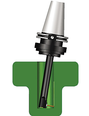

However, Denietolis said he had seen information online about Titespot angle heads from Eltool Corp., Cincinnati, which rely on high-pressure coolant to drive an integral, positive-displacement ball piston motor. The motor powers a drive shaft, which, in turn, drives the head’s spindle, while exhausted coolant is directed at and through the cutting tool. Eltool stated that because the angle head has its own power (the coolant), a machine’s spindle can function as an indexer, allowing multiple-position machining with one head and setup.

A model of Eltool's angle head shows the head being tilted to position the cutting tool near the bottom of a bore.
A model of Eltool’s angle head shows the head being
of a bore. Image courtesy Eltool.

A call to Eltool President John Young confirmed the salesman’s claim, Denietolis said, as Young was able to provide an off-the-shelf solution. “That tool is like an extension of the machine now,” Denietolis said, “and every single part is good.”
Denietolis said the head was applied at a 30° angle, and it was never removed from the spindle for the prototype job. (Antron expects to go into production in mid-summer.) The angle head produced the part features in 8 to 10 minutes, about 20 percent of the time that the planing method would have consumed, he estimated. This generated a 60 to 65 percent cost savings—a return on investment after one job. In addition, the angle head provided process security, “instead of 100 percent of the time not knowing if the part was going to be good or bad after you’re done machining,” Denietolis said.
