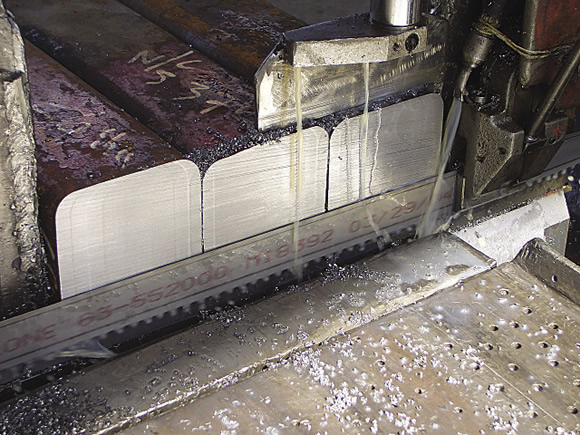

Simonds%20CIMG3216.tif
Courtesy of Simonds International
Simonds’ SiClone bimetal bandsaw blade is made for cutting materials prone to workhardening, such as stainless steel.

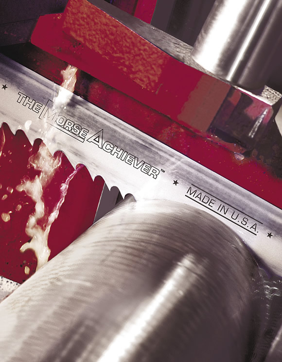

Morse%20Achiever%20App.tif
Courtesy of M. K. Morse
The Morse Achiever bimetal bandsaw is for cutting a range of solids, from carbon steel to stainless steel (shown).

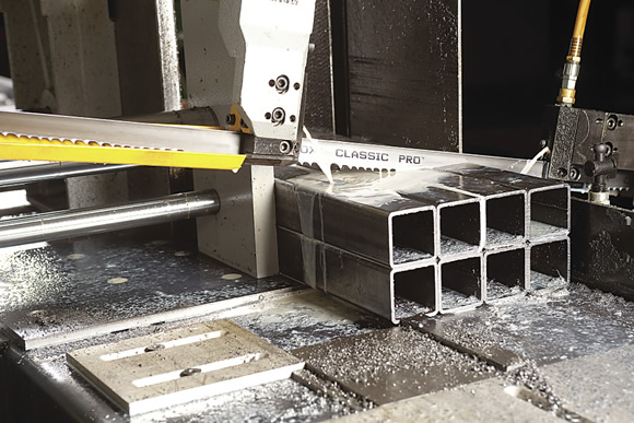

Lenox%20Classic%20PRO%20structurals.tif
Courtesy of Lenox
Lenox’s Classic Pro bimetal bandsaw blades can cut a range of solids and structurals, from carbon steel to higher strength alloys.

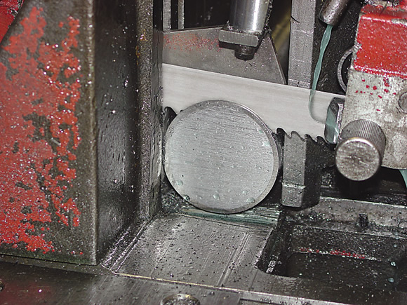

Starrett%20Advanz%20CS_app2.tif
Courtesy of L.S. Starrett
L.S. Starrett says its AdvanzCS carbide-tipped bandsaw blades allow for fast cutting, impart a fine surface finish and cut hard materials, such as metals casehardened to 65 HRC.

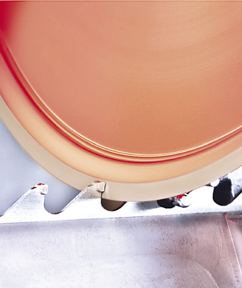

Vollmer%20Bandsaw_CB200_Pic_Detail_02_-.tif
Courtesy of Vollmer of America
Face grinding a carbide-tipped bandsaw blade using a diamond grinding wheel on the Vollmer CB200.
