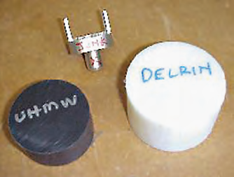

Labeling material scraps and drops early saves time later.

Also, mark your material drops and scraps early. If something is worth saving, you had best know what it is.
