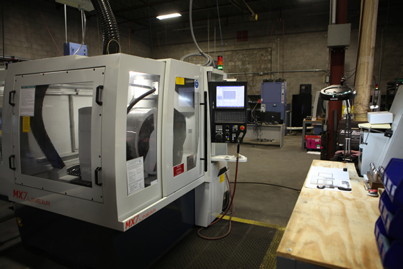

The ANCA MX7 Linear CNC tool and cutter grinder improved flute surface finish from 0.8 Ra to 0.2 Ra. Images courtesy ANCA.

“We were looking for capacity and an ability to produce a polished finish on the flutes of one of our aluminium tools,” Joe said. “The MX7 Linear CNC grinder was delivered a few months ago and has been producing tools of exceptional quality to tight dimensional tolerances without any problems since its first day of operation. Normally, I prefer not to buy first-generation machines, but after talking to ANCA and seeing the machine in operation, I was confident it would grind to the finishes I was looking for.”
Asked about any differences he has noted between the MX7 ballscrew and linear motor machine, Joe commented, “When using the same grinding wheels, tool file, feeds and speeds, the surface finish is better on a tool ground on the MX7 Linear when compared to the tools ground on an MX7 ballscrew machine.”
Joe believes the MX7 Linear machine is superior to a machine driven by a ballscrew, “because you do not have to deal with wear, backlash and the transition is smoother. Ball screw wear is a big factor to us because we run a 24/7 operation. We cannot have any failures or unacceptable parts.”
The flute face from a tool ground on the MX7 ballscrew machine can be as low as 0.8 Ra (roughness average), but the flute face measured on a tool ground on the MX7 Linear measures even lower at 0.2 Ra.
“We are seeing much better finishes with the linear motor machine than we could achieve with the ball screw machines, especially for our aluminium tools,” Joe said. The product is an end mill range with variable helix and variable index, two- and three-flute. Joe added a secondary fluting operation to polish the flutes for improved chip flow using an 800-grit wheel.

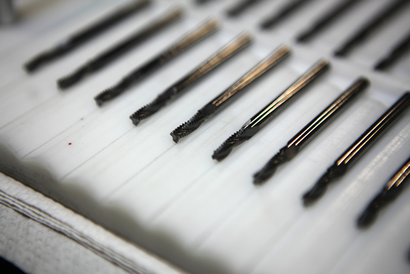

Range of carbide tools by Myles Tool.

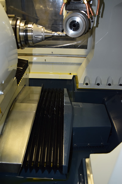

The linear motor is very compact under the way cover and avoids ball screw stick-slip and wear issues while providing 10 percent faster cycle times.

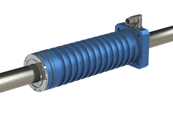

The key is the LinX cylindrical design.
The LinX® Linear Motor consists of a shaft containing magnets and a forcer containing wound copper coils. The symmetric design results in zero attractive forces between the forcer and shaft, greatly reducing the loading requirement on support bearings. The thermal barrier design separates and removes heat from the motor, eradicating thermal growth for the machine. So ANCA Linear machines don’t require a dedicated chiller, reducing power and floor space requirements. The traditional flatbed linear motor typically requires a separate chiller for thermal stability.
The MX7 Linear at Myles Tool uses the same coolant system and chiller as the MX7 ballscrew machines. No special modifications were needed to the coolant system or the chiller unit to accommodate the MX7 Linear machine, Joe said. “We have had no thermal concerns with the MX7 Linear. And the polymer concrete base on ANCA machines contributes significantly to the thermal stability of the machine.”
With LinX®‘s simple construction, non-critical air gap and no physical contact between shaft and forcer, machine manufacturers can greatly simplify installation, reduce maintenance and extend machine life. The LinX®‘s design allows it to easily replace ball screws in existing machines.

Rendering of the ANCA Motion linear motor, an energy- and space-efficient innovation in drives well-suited to precision machining applications.
