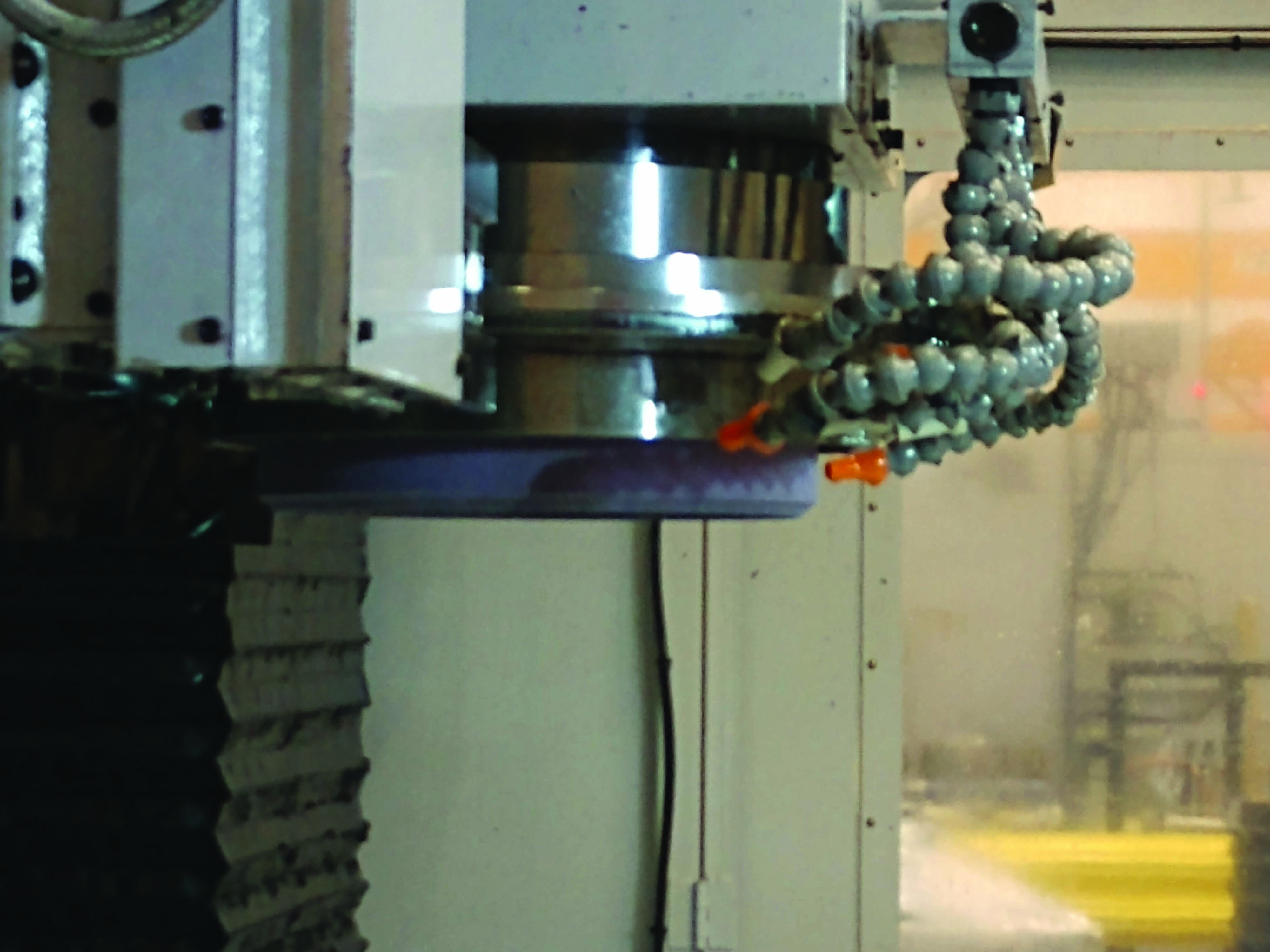

Curvic grinding is performed with a vitrified wheel not much different from the wheel found on a bench grinder. Imagge courtesy of C. Tate
