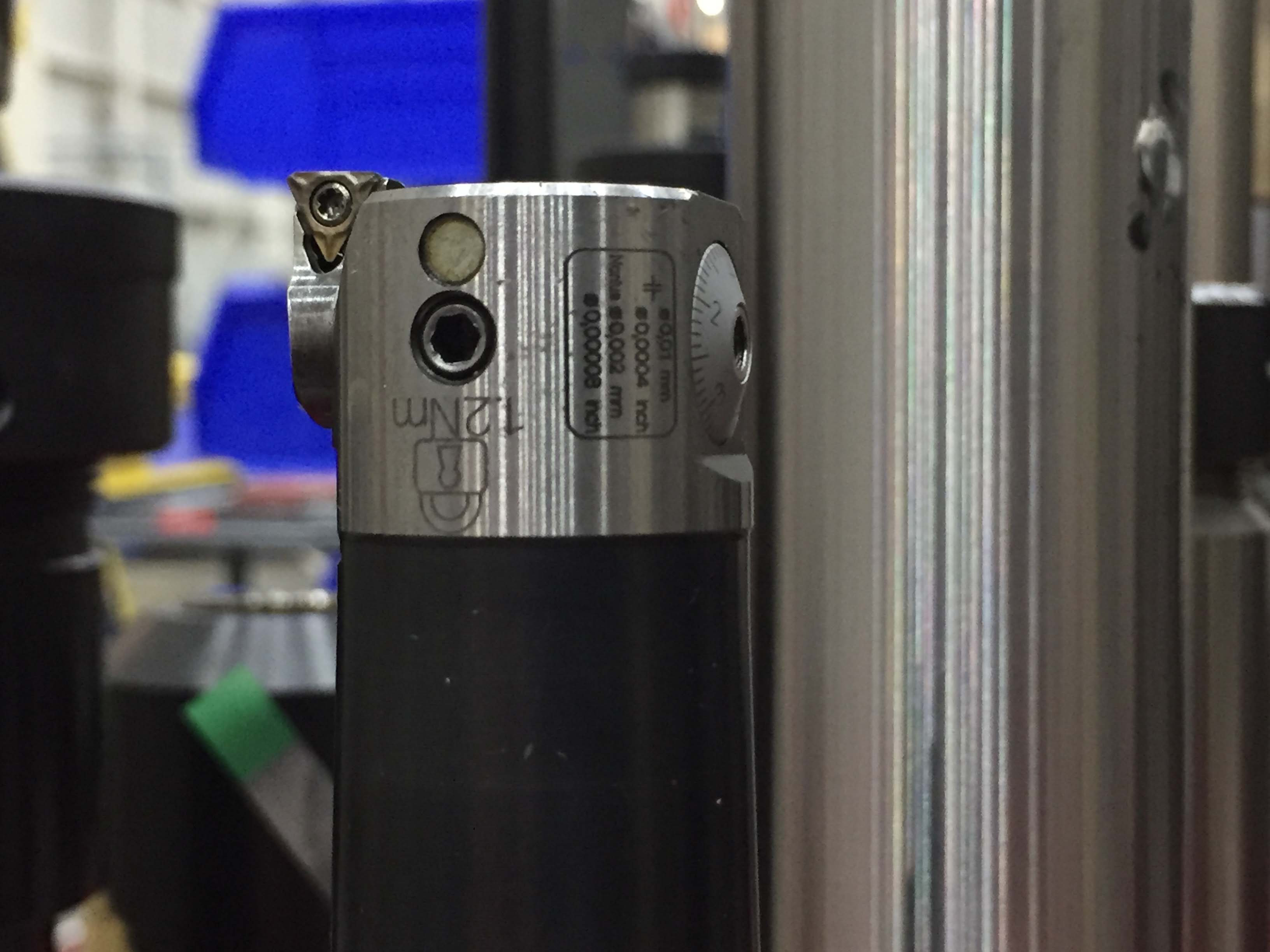

A fine boring head used for finishing close-tolerance bores. Photo credit: Christopher Tate.
A fine boring head used for finishing close-tolerance bores. Heads like this one can be adjusted in 0.0004″ increments. All images courtesy of Christopher Tate.

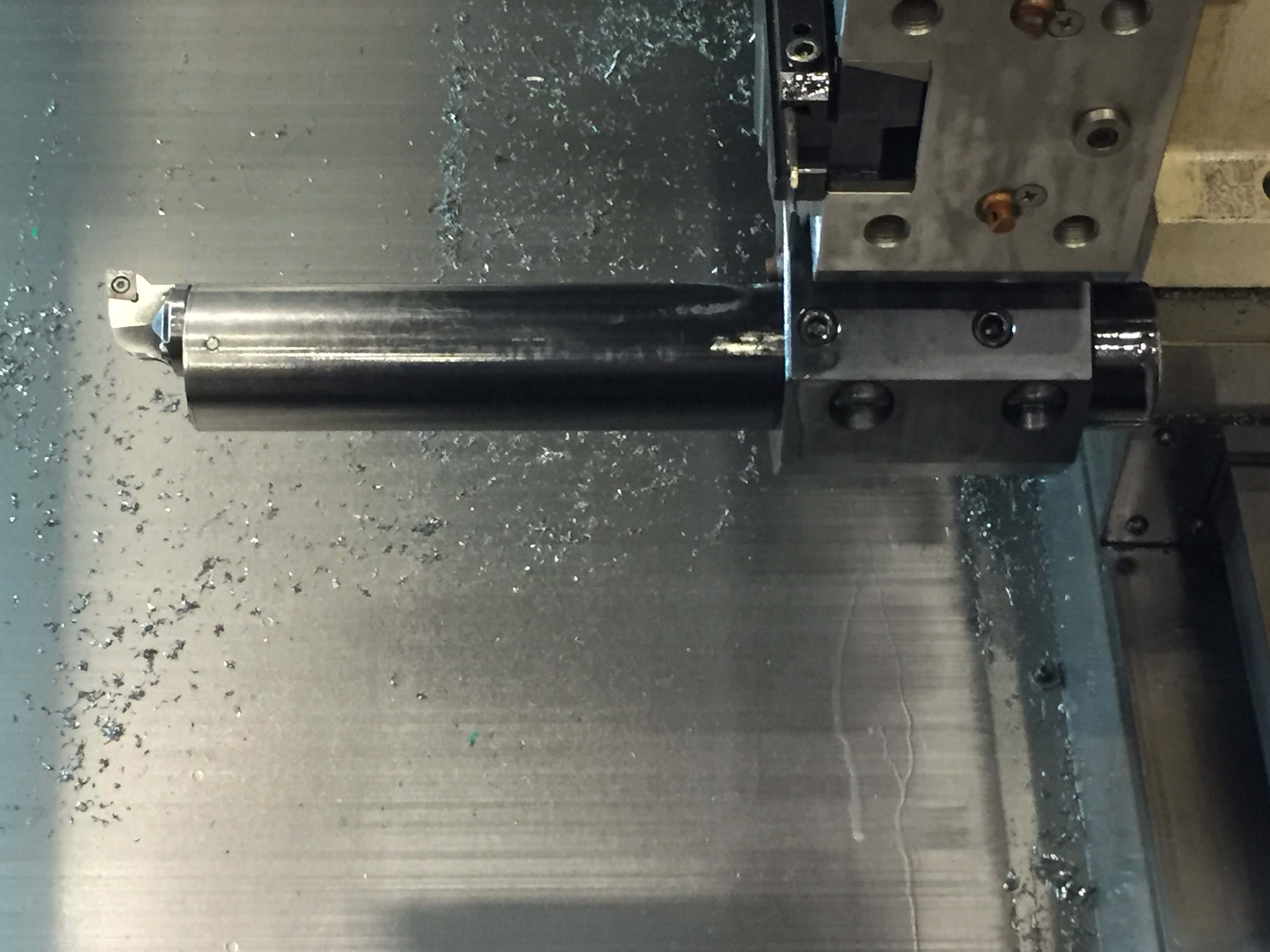

Unlike drills or reamers, single-edge boring bars have a single point of contact with the workpiece. As a result, the bar is unsupported, which sometimes leads to vibration, or chatter. Problems with chatter are the only significant drawback to these cutting tools.
Steel bars tend to chatter once the axial DOC exceeds 4 diameters deep. So, an end user would likely experience chatter on a 1″-dia. (25.4mm) bar if it protrudes from the turret by more than 4″ (101.6mm). A machinist would say it has too much “stick-out.”
Chatter Away
Chatter during boring operations on a lathe can be overcome. The easiest way is to apply a larger-diameter boring bar. However, a larger bar is not always an option and other means would be necessary.
Sometimes the solution is as simple as working with cutting speeds and chip loads to alter the cutting pressure on the tool. It is possible to increase tool pressure by increasing the feed rate, decreasing the cutting speed or doing both at the same time. Changing the radial DOC will also put more pressure on the tool. Sometimes users must adjust all of these variables to achieve success.

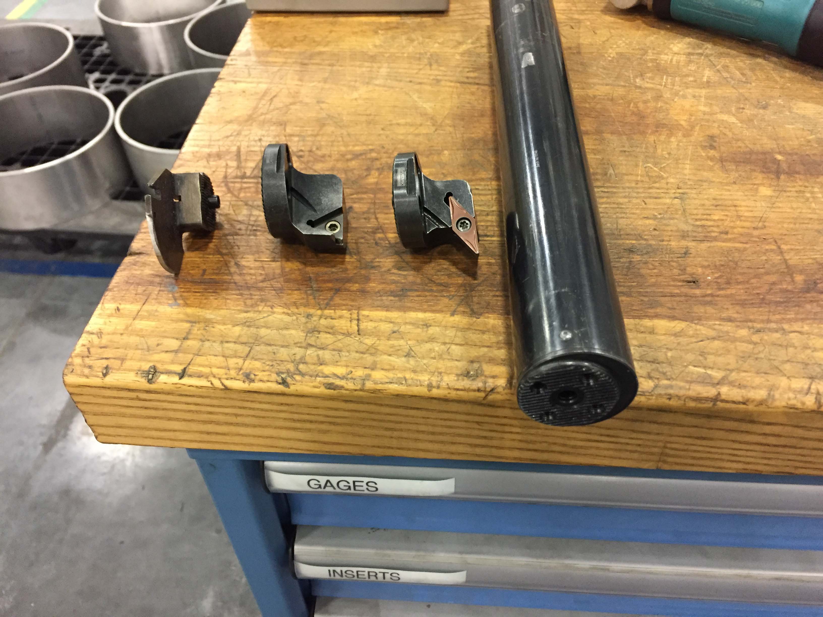

Because of their lower cost, steel boring bars are the most common, but other materials are also available. For example, cutting tool manufacturers have developed heavy-metal and carbide bars to fight chatter. Heavy-metal bars are made from tungsten alloys, which are denser than steel. These alloys work to damp vibration. Although heavy-metal bars are more expensive than steel ones, they can be applied at higher length-to-diameter ratios. Whereas steel allows a 4:1 ratio, heavy-metal bars can boost the ratio into the 6:1 or higher range with some speed-and-feed tuning.
Tungsten-carbide bars provide even higher depth-to-diameter ratios. Carbide bars are made by brazing a steel head that is machined to accept an insert onto a carbide bar. Carbide is extremely dense. It provides superior damping, allowing length-to-diameter ratios in the 8:1 or higher range.
Vibration-damping bars have internal mechanisms that eliminate chatter. Photo credit: Christopher Tate
Vibration-damping bars have internal mechanisms that eliminate chatter. Because these bars can be expensive, buy them with interchangeable heads that accept different inserts.
Carbide bars above 1″ in diameter are not practical because of the expense. In situations where carbide would be cost-prohibitive, a tunable bar may be warranted. As the name implies, these bars have an adjustment feature that enables a user to tune the bar to a specific application. An internal mechanism alters the natural frequency of the bar, preventing chatter and allowing very large length-to-diameter ratios. Some tool manufacturers have reported the ability to make cuts at 20:1.

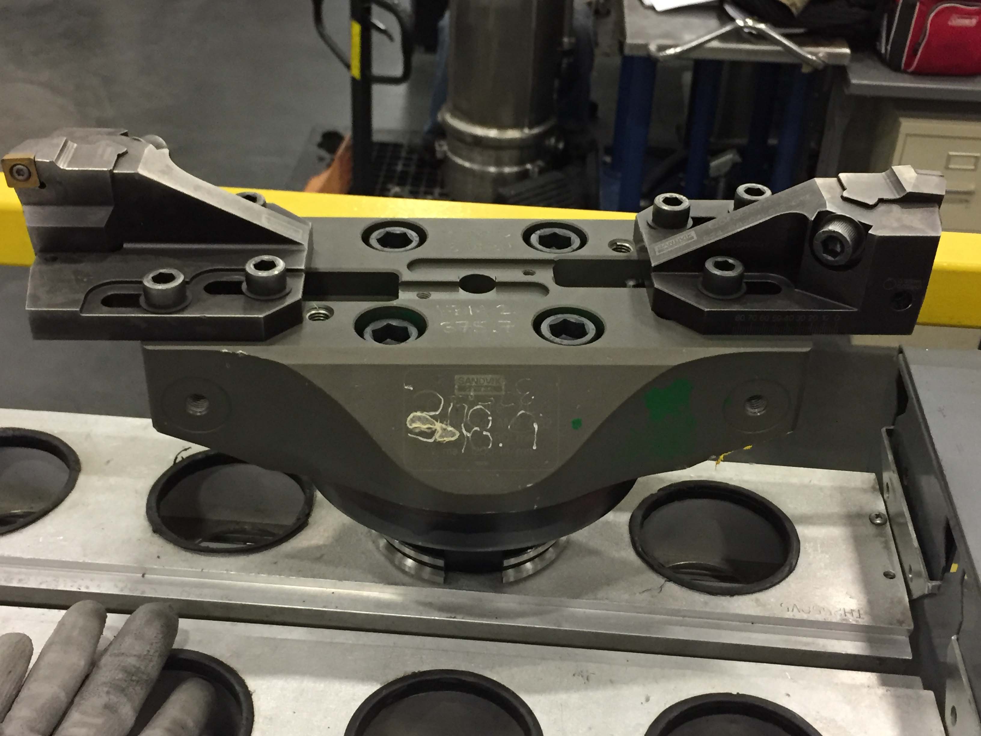

This twin-head boring bar can rough large bores on a horizontal boring mill. Image courtesy of Christopher Tate.
You can engage more than one cutting edge when boring on a mill, unlike a lathe. Some boring heads are used frequently in high-production environments. Twin boring heads are set up one of two ways. In the first way, each cutting edge is set to the same diameter, allowing a fast feed rate. With the second method, the cutting edges are set on two different diameters, thereby removing more material per pass.

Finishing tight-tolerance holes often requires special boring tools that can be accurately adjusted in small increments. These boring heads are often referred to as fine boring heads—some can be accurately adjusted in increments as small as 0.0001″ (0.0025mm). Fine boring heads come in several styles. Some utilize basic round boring bars and others utilize special insert holders. They are expensive and are typically reserved for boring holes with diametric tolerances less than 0.001″ (0.025mm).
