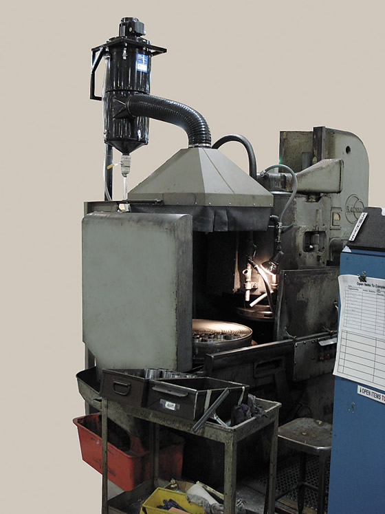

Filtermist_App_01_Grind.tif
Courtesy of Royal Products
When a machine isn’t enclosed, such as this Blanchard grinder, a Royal Products Filtermist can be configured with a hood to capture oil mist.
Sheridan explained that, as a rule of thumb, Royal Products sizes a Filtermist throughput in cubic feet per minute to be five times the internal enclosure volume of a machine tool. For example, if a CNC lathe has a work envelope of 4 ‘×3 ‘×4 ‘, or 48 cu. ft., it requires an oil mist collector that provides 240 cfm. “That will more or less guarantee the air inside the machine tool enclosure is changed five times a minute, or once every 12 seconds,” he said.
However, with better-sealed machine tools, the unit size must be scaled down so it only pulls in the mist and not the coolant. For example, a bar-fed machine with an automatic parts catcher will need a unit with a smaller cfm than a machine with the same work envelope where the operator is opening the door every 35 seconds to change a part.
When a machine isn’t enclosed, Environmental Clean Air’s Cherry recommends first identifying where the oil mist is coming from and then minimizing the area to be treated with hoods and other types of enclosures to more effectively contain the mist.

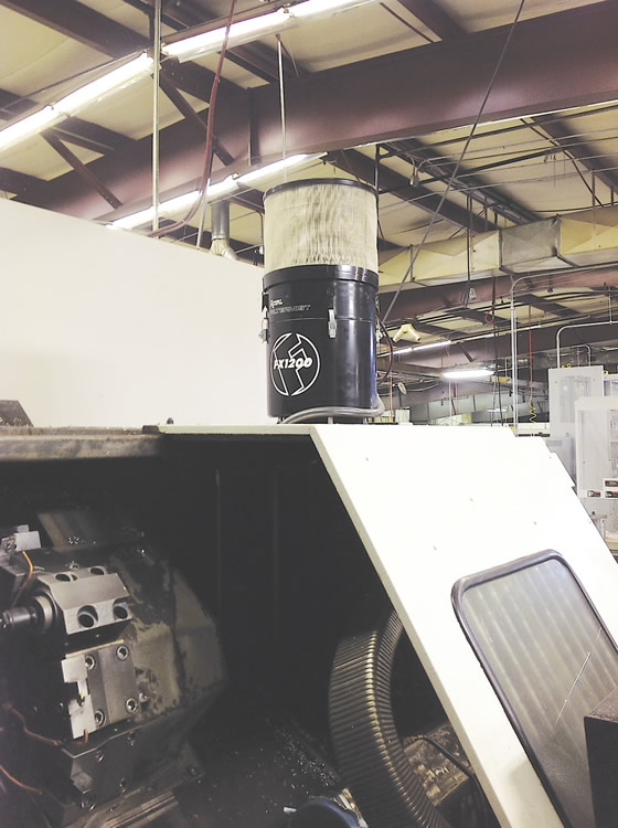

FX1200_w_afterfilter_OkumaLC30.tif
Courtesy of Hurst Jaws of Life
Mounted on an Okuma LC30 CNC lathe, this FX1200 Model Filtermist oil mist filtration unit at Hurst Jaws of Life has an after-filter on top to remove oily submicron-size smoke particles.
Operators would often stand back after opening a machine door to let a mist cloud dissipate or blow the mist away with an air hose before gaging or changing a part, thereby reducing efficiency, he added. “If it was up to the operators, they probably would have slowed the speeds and feeds to cut down on the oil mist, but that wasn’t an option because the programming/manufacturing engineering department controls those.”
Based on its research and budget, Hurst selected a Filtermist system from Royal Products to filter oil mist from one of its eight CNC machine tools. “It worked really well, so we went ahead and purchased units for the rest of the machines,” Mosteller said.
He pointed out that Gene McDonald, regional business manager for Royal Products, measured the internal dimensions of the machines to size the filtration systems and recommended mounting procedures, brackets and attachments. Hurst installed the filtration systems, and the units mount directly to the machines except for a Mazak lathe, which required a unit suspended from the ceiling because the machine configuration prevented it from being directly mounted.
In addition, an Okuma LC30 lathe generates a significant amount of heat when turning steel piston rods and, therefore, produces oily smoke as well as oil mist, Mosteller noted. As a result, Hurst outfitted the filtration system with an after-filter to capture submicron particles.
Although the operators greeted the mist collectors with curiosity and even some skepticism, according to Mosteller, they quickly realized the benefits. “With the Filtermist units running, when the operators open the machine door, they are no longer hit in the face with a cloud of mist and smoke, but with a nice breeze pulling air into the machine,” he said.
