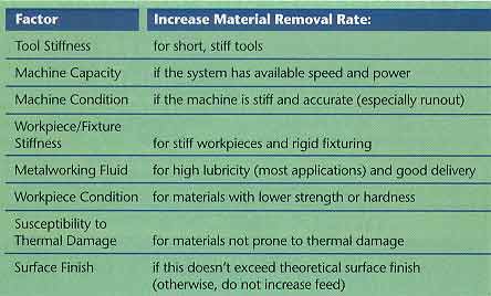

Because most machining data are not generated for a specific application, a recommendation should serve as a starting point. Users should modify these parameters during runoff to optimize the application. (The exception to this is where quality-driven process-control standards are in place that prohibit increasing the mmr beyond a specified range.) For most operations based on generic data, the user can increase the mrr over the recommended parameters. See Table 2 for the key factors that will determine if the mrr can be increased.
In some cases, however, the user may want to use a lower mrr than the recommended rate. Key factors that might lead a user to decrease the recommended mrr are the precision or value of the workpiece or the risk to the operation that a catastrophic tool failure might pose. For high-precision components, it may be necessary for the user to reduce cutting forces by reducing the feed per tooth or DOC to produce the necessary surface finish or reduce the parameters to allow a single tool to make the entire cut and thereby avoid stoppages that might mar the finish. Users also may choose to machine high-value components less aggressively to avoid the high cost of scrapping or reworking the part. Similarly, a user may run an operation conservatively to extend tool life, thereby reducing the number of tool changes when tool replacements are difficult or time-consuming.

Table 2: Factors that may allow users to machine with more aggressive parameters than the recommended parameters.
