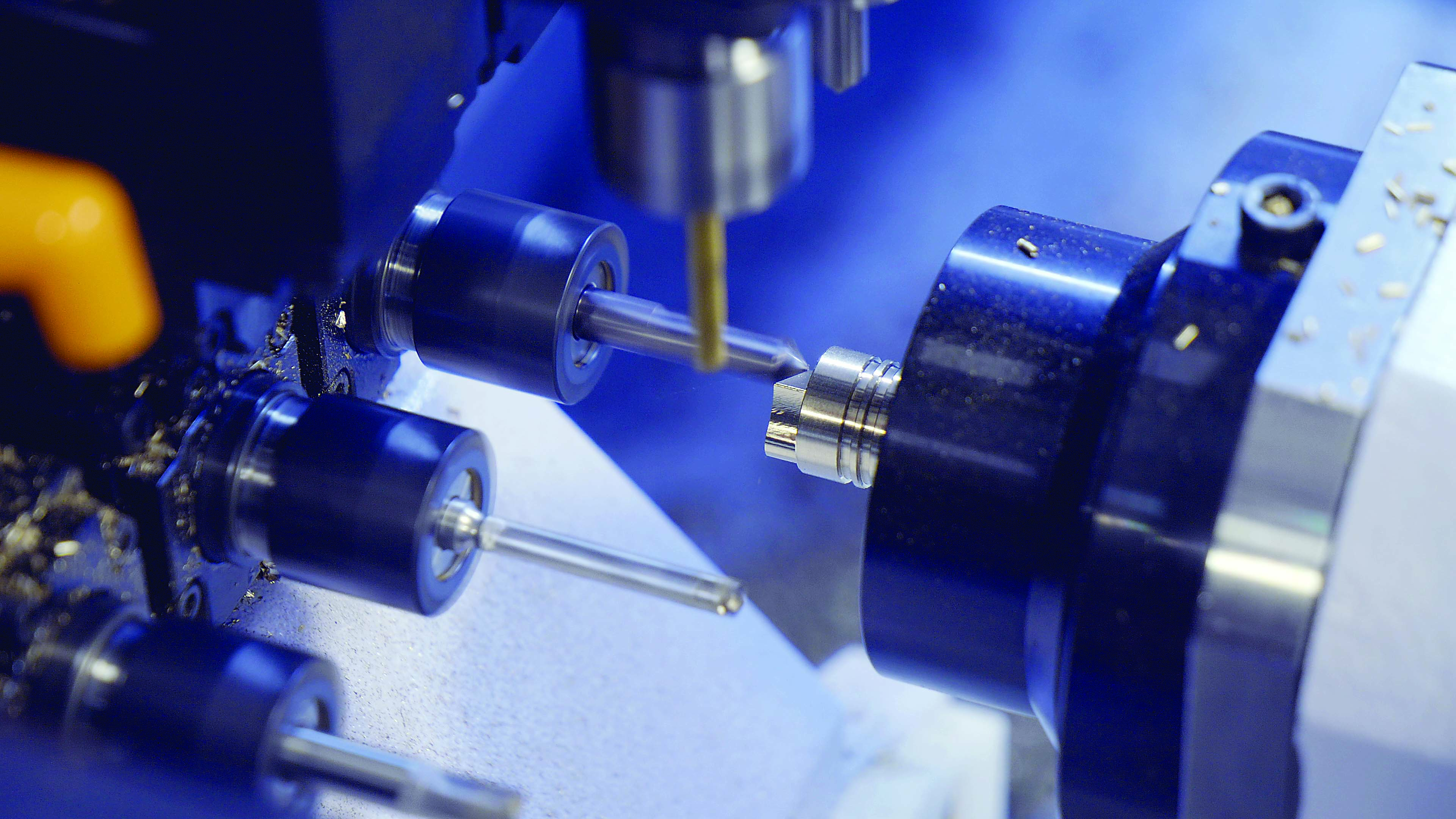

Swiss machines can accommodate live tooling. Image courtesy of CNC Software

In addition to small parts, today’s Swiss machines can tackle complex components.
Some Swiss machines are “now equipped with machining heads for five-axis work to do things that would typically require either a mill-turn machine or a multi-operational process,” said Swiss Product Specialist Chris Leclerc of Tolland, Connecticut-based CNC Software Inc., a CAM software developer.

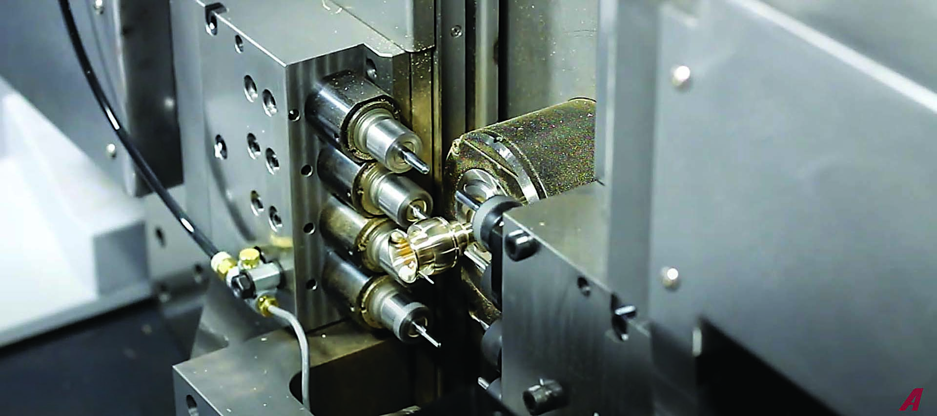

“The first one I ran did not have a live tool on it,” he said. “It had one eight-station turret and didn’t even have a pickoff spindle. Now there are machines with three turrets, two spindles and power tools everywhere, as well as five-axis (capability). As Swiss machines keep evolving into more powerful machines that can complete a part without multiple operations and do it in faster cycle times, people start realizing they need to own a Swiss.”
Leclerc said the speed of Swiss machining is due in part to the fact that the workpiece, guide bushing and tools are contained in a small space, which speeds up tool indexing. Another important factor is that machining can be done by both the main spindle and the subspindle. In many cases, he said, parts first machined by a conventional lathe must be transferred to a milling machine for a second operation. If a Swiss machine is used for the same parts, however, the two spindles perform both operations, finishing parts in less time and freeing up the milling machine for other work.

The Nexturn XIII Swiss-type lathe has 11 axes. Image courtesy of Absolute Machine Tools
