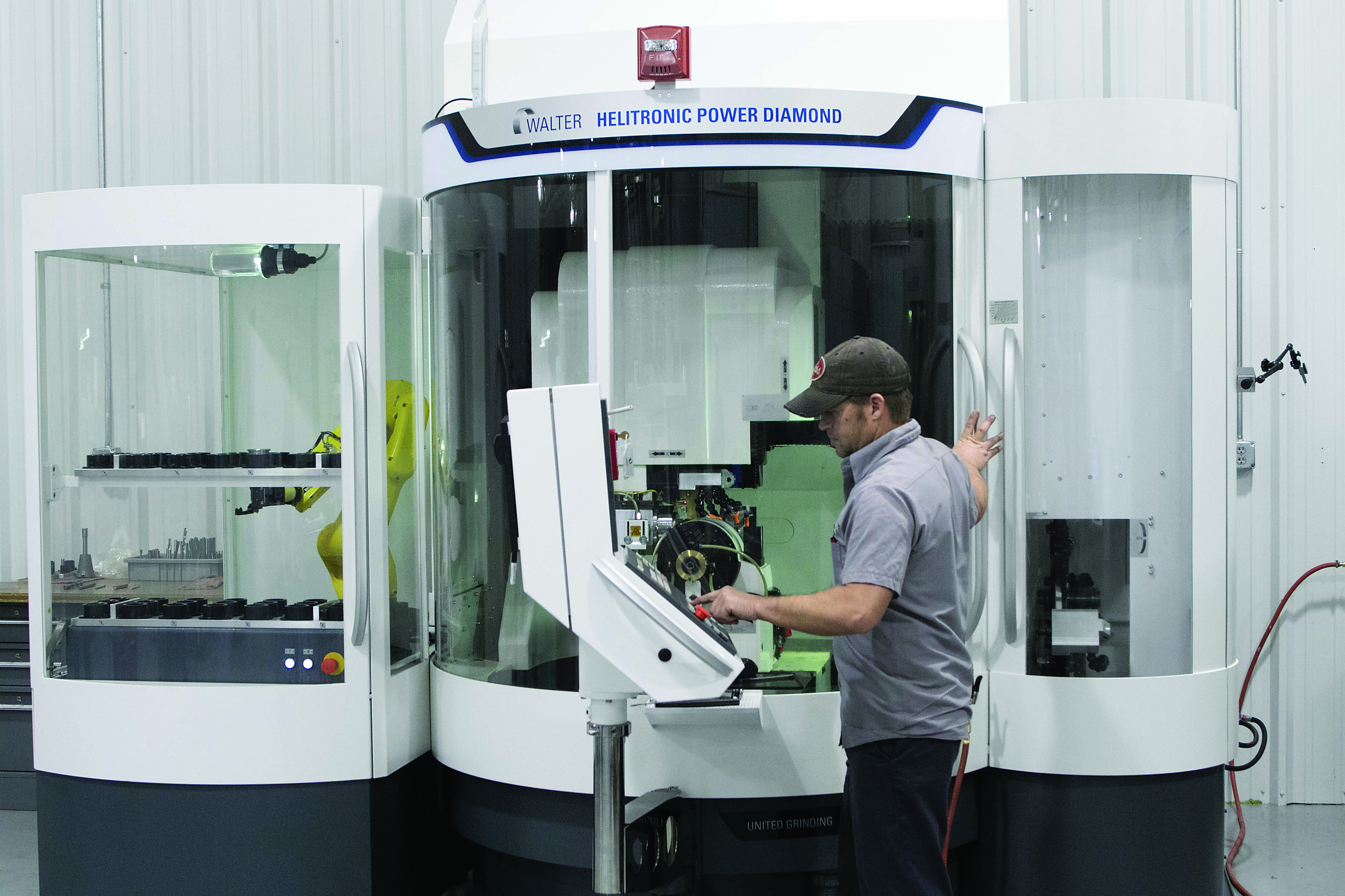

West Ohio Tool produces EdgeX4 cross-center PCD-tipped drills on a Walter Helitronic Power Diamond 600 grinder. Image courtesy of United Grinding
The additional machine is a Walter Helitronic Power Diamond 600, which provides both grinding and EDMing capabilities. Using copper electrode wheels, the machine rotary-erodes the PCD portions of tools and then conventionally grinds the carbide areas. According to United Grinding, the machine changes from grinding to eroding — or vice versa — on the fly and automatically to provide complete machining in a single clamping cycle. The single-spindle grinder has a robot loader and automatic wheel changer.
