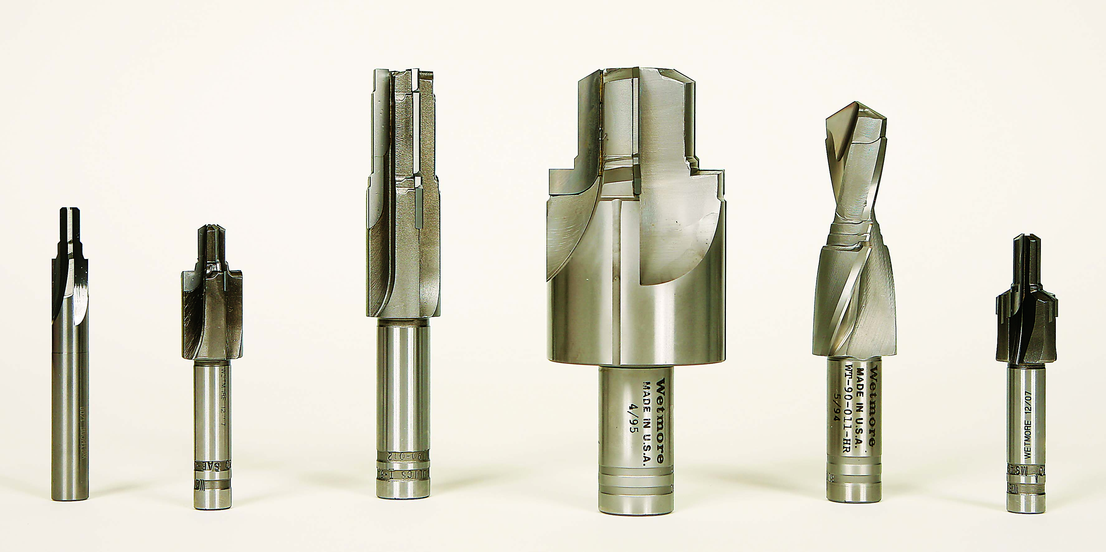

Some fluid connectors come with O-rings, others with metal-on-metal seals, but all rely on a complex shape that is usually machined with a port tool.
Dry, tight fluid connectors require the right tool
Port tools can be resharpened many times and, according to Wetmore Tool, may last decades. Photo courtesy of Wetmore Tool and Engineering.

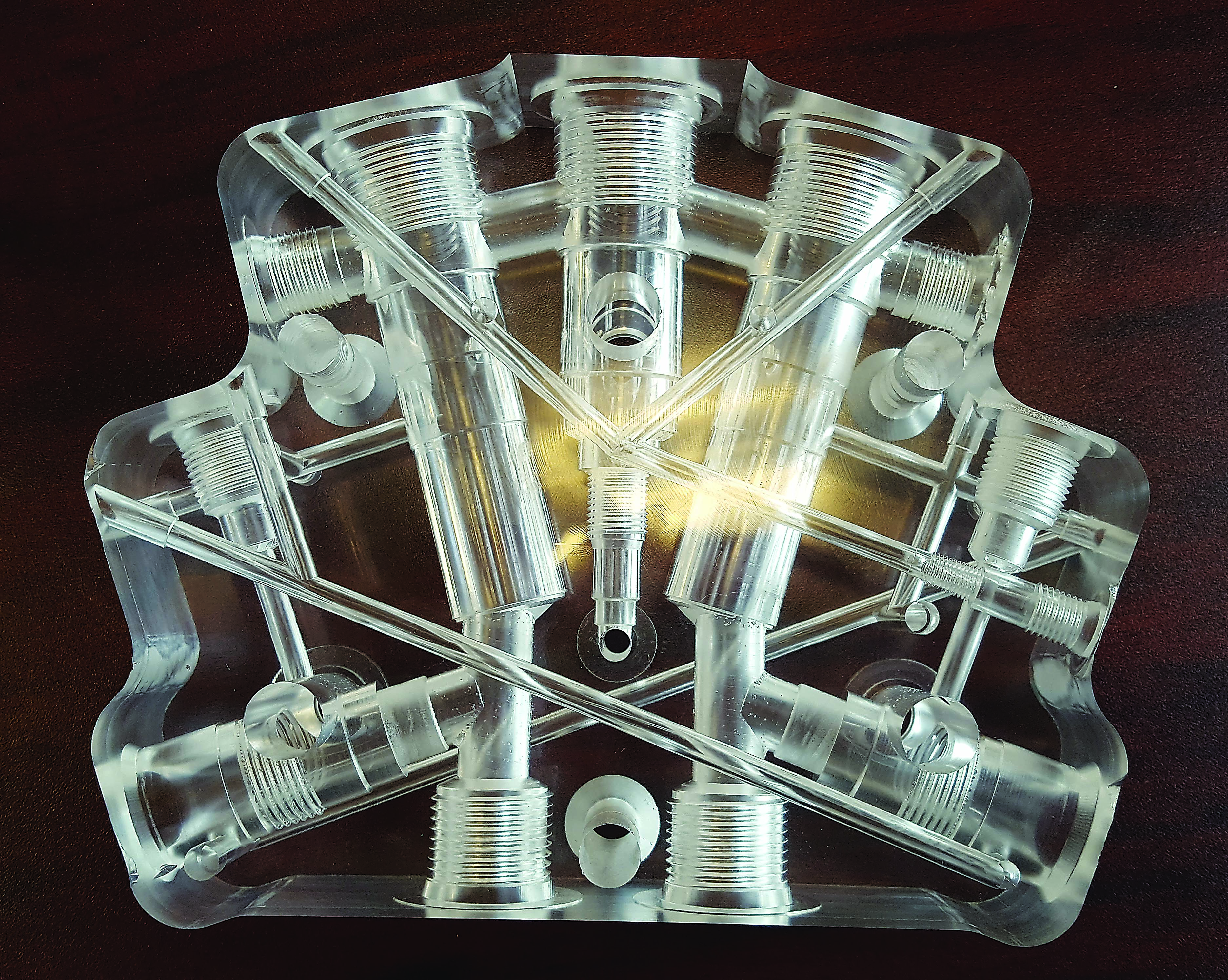

A mock-up of a ported agricultural valve body for a trade show presentation. Image courtesy of New Dimensions Precision Machining.

Another porting success story comes from Union, Ill. Brian Halwix Sr., director of manufacturing engineering at New Dimensions Precision Machining Inc., said the company produces a variety of aluminum and cast iron hydraulic manifolds for the agriculture and construction industries on its three Makino flexible-manufacturing systems, which utilize 19 horizontal machining centers. For Halwix, the biggest challenge with port machining is breaking into cross-holes.

“Porting is pretty straightforward otherwise,” he said. “But when the tool breaks through into a neighboring hole, it tends to lose stability, causing problems with straightness and position.” Halwix added that roundness is also a concern, especially when maintaining a 0.33 Cpk allowance of ± 0.0013″ (0.03mm). “The hole can easily end up egg-shaped if you don’t control the cutting forces.”
Halwix said there are two ways to avoid this problem. The first is proper part processing, particularly machining ports in the right order to avoid cross-holes in the first place. The next course of action is tweaking the tool design by adjusting flute margins and using other tricks of the porting trade. “It’s all about cutter technology,” he said. “That’s why probably 30 percent of our tools are custom, which we designed in-house based on our own education and experience.”

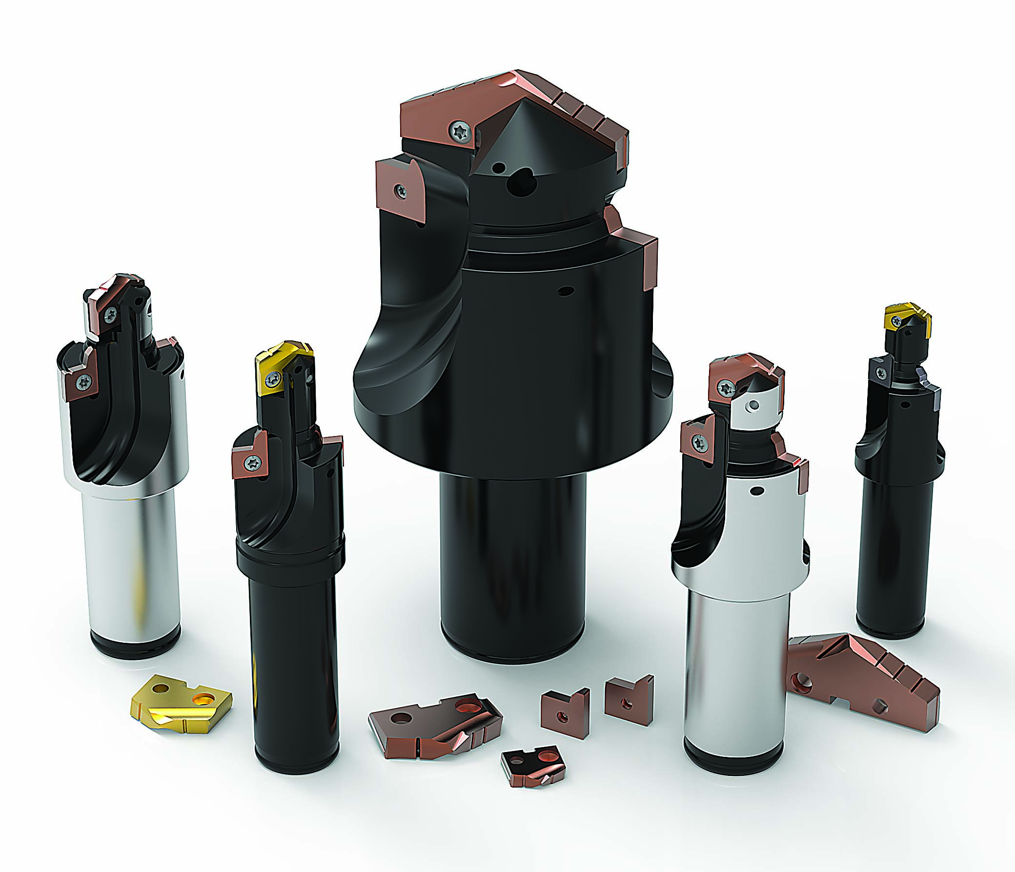

As with any indexable cutting tool, these port tools increase uptime. Just change the insert and go back to work. Image courtesy of Allied Machine and Engineering.
Polizzi said most of his clients want through-coolant tools, something he heartily endorses. He recommends 1,000 psi, whenever possible, and the use of a high-quality toolholder, preferably a hydraulic chuck rather than an endmill holder. “Drill the port, dwell for a second or two at the bottom of the hole and you’ll be in good shape.”
The Indexable Story
What about port tools with indexable carbide inserts? Solid-carbide and brazed tool aficionados might disagree, but for many applications, indexable tools are suitable. “Aside from the threads, our tool cuts the entire port in one operation,” said Rob Brown, product manager at Allied Machine and Engineering Corp., Dover, Ohio. “When it gets dull, you just change out the insert and go back to work. You don’t have to worry about regrinding or knocking out the old carbide and brazing in new pieces.”
Brown said indexable cutters are also more cost effective. Each insert costs around $35 to $70, and a dual-insert cutter body runs roughly $600, depending on the size. This is about twice the cost of a comparable brazed tool, but Brown said users of traditional port tools need to have multiple cutters: one in the machine, a spare in the toolcrib and one out for regrinding.
“With indexable cutters, you need a couple of spare inserts and screws,” he said. “And there’s no need to spot-drill, drill and rough the port form as there is with traditional port tools. You just come in and drill, and the port’s ready to go. Because you’re not worried as much about tool life, you can be a bit more aggressive on feeds and speeds. The end result is a lower cost per part.”
