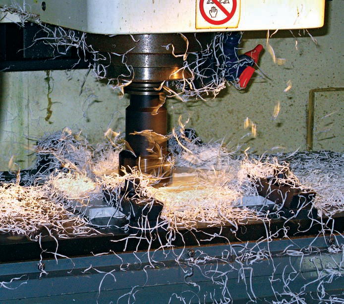

A 3 "-dia. cutter, tooled with six inserts and running at 2,500-rpm and a 10-ipm feed rate, mills a sheet of Quadrant Ertalyte TX PET-P.

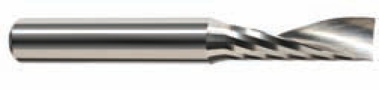

The extreme flute depth of Harvey Tools' single-spiral "O" flute tool provides maximum room for a large plastic chip to flow cleanly from the cut and carry away heat with it.
As an example, Davis cited Harvey Tools' plastic-focused single-spiral "0" flute tool, which "almost looks like a corkscrew." Depending on the individual tool, the flute depth extends to the center or past the tool's core, eliminating the core diameter typical of a metalcutting tool. "The flute depth is gigantic, so there is plenty of room for the chip to exit," Davis said.
The configuration is weaker than a tool with a large core diameter, but a tool for milling plastic generally isn't subjected to the power and torque experienced by a metalcutting tool. When machining plastic, "The cutter can be more sleek and dynamic. It doesn't have to be beefed up with corner radii, edge prep and special coatings."
Harvey also polishes the tool's large flute valley "to give the chip very little to stick to. We don't want to have any texture or hangups that might keep the chip from being thrown," Davis said. "If you can cut [the workpiece] solidly and cleanly [to create a big chip] you get the finish you are looking for and any incidental heat ends up in the chip."

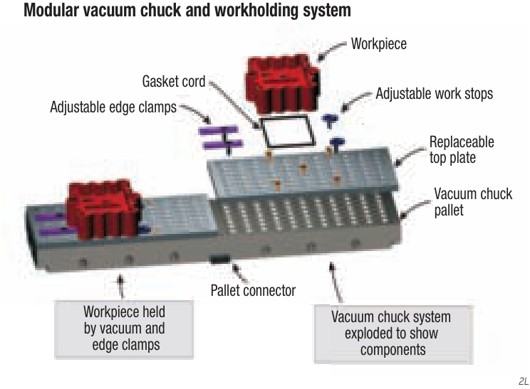

One solution is vacuum workholding. Nelson of 2L said the vacuum workholding equipment his company offers is an outgrowth of the company's original business of providing solid-carbide and spring-loaded engraving tools. When end users sought ways to hold unevenly shaped items for engraving, 2L developed vacuum workholding systems as a way to immobilize a workpiece without clamps.
The systems are based on plates with horizontally gundrilled passages connected to the plate surface via holes blocked by removable screws. A vacuum pump is attached to the passages, and taking out a screw creates a vacuum at the plate surface.
The strength of the suction on a part is directly proportional to its surface area, so "if you have small parts, you are not going to be able to use a 3 "-dia. facemill and take a ¼ " DOC; the part will just slide," Nelson said. As a result, the plate surfaces feature rows of threaded and tapped holes that enable users to bolt work stops or adjustable edge clamps to grip the side of a part.
Vacuum systems provide strong grip on nonporous plastics, but because their effectiveness is based on surface area of the part, machining small parts requires other methods, such as using vacuum to hold a single large sheet of plastic, then applying gang or nesting machining techniques to cut a large number of parts in the sheet. "So the parts don't go flinging around inside the machining center when they are making them, a shop will often cut three sides of the part and on the fourth side leave a very small web of material," Nelson said. "When machining is completed, the sheet is taken off the chuck and the parts snapped off of it like you do on a kid's model set."

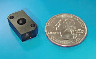

Rather than mold a part, Padgett Machine milled this 5⁄8 "-long × ½ "-wide × ¼ "-thick high-grade Delrin-polymer aerospace electronics insulator because its ±0.002 " tolerance and squareness requirements didn't allow for the taper that would be required to remove the part from a mold.
Mill or mold?
Ed Padgett, co-owner with his brother, Randy, of Padgett Machine Inc., mills parts from plastics because "sometimes plastic injection is not the answer. Sometimes a part has to be machined." He cited a 5⁄8 "-long × ½ "-wide × ¼ "-thick high-grade Delrin polymer insulator for aircraft electronics equipment. The part was not a candidate for injection molding because a molded part "has to have a taper on so it can be pulled out of the die; this part had a ±0.002 " tolerance that didn't allow for taper on the edges."
And even if the part's features were compatible with the injection molding process, it wouldn't have been cost-effective to mold. "The application, just 6,000 parts over 3 years, didn't warrant building an injection die. Normally, if you're going to build an injection die, you'd be running 40,000 to 50,000 parts."
