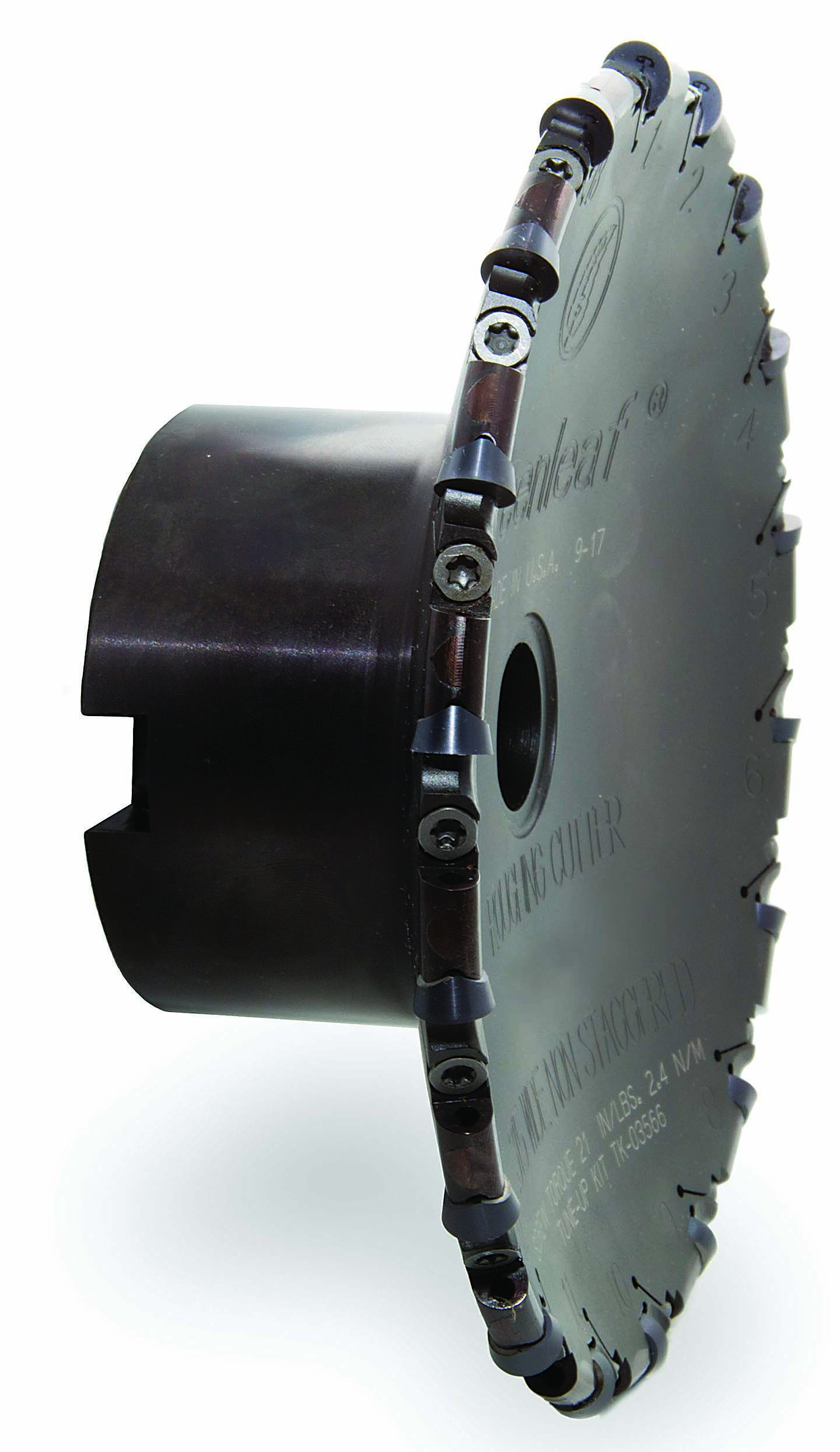

Indexable-insert wheel cutters with internal coolant, such as the CoroMill QD tool, are effective for groove milling. Image courtesy Sandvik Coromant
Tucker said that about a year ago Sandvik Coromant introduced Inveio coating technology, which further improves the ability to prevent cracks from forming on the edge line.
“It has a columnar structure,” he said. “The better those columnar structures are aligned, the better the ability to stop crack propagation in the milling process.”

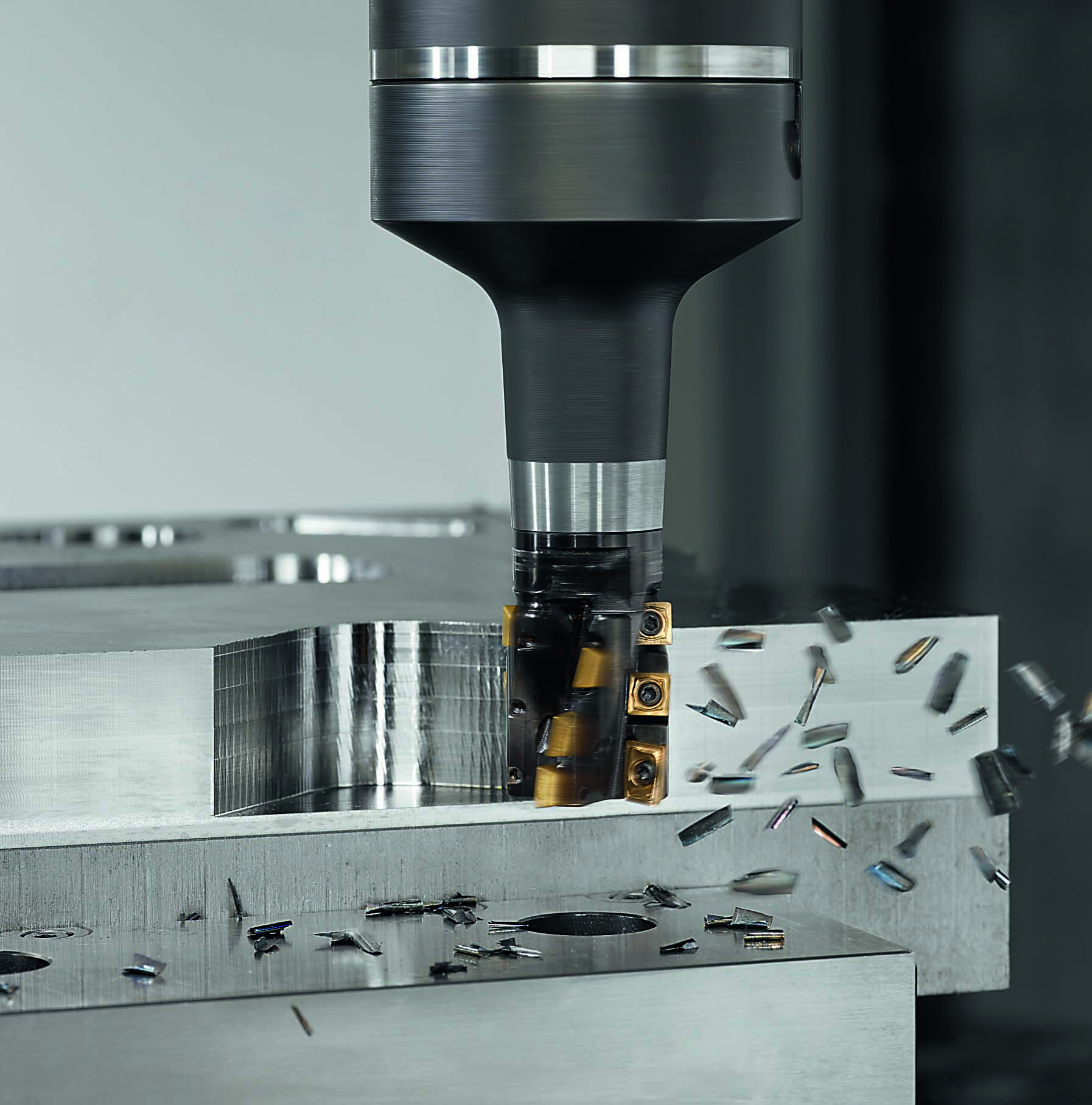

There are three basic slot milling techniques: conventional, plunge and trochoidal, or dynamic.
With conventional slot milling, Pollock said the tool runs straight through in an x-to-y move and takes a full WOC.
Embracing slot diversity
An example of a slotting cutter is shown. Image courtesy of Greenleaf
“You are a little bit limited in the number of teeth you can use because you need more flute space,” he said, “so the material that you are removing has to fit into that flute space and be evacuated.”
Pollock said another limitation is the feed per tooth and cutting speed that the tool can run at based on the rigidity of the machine and how much force the tool can withstand before fracturing.
Plunge milling is a problem-solver in vibration-sensitive applications, such as those with long tool overhangs, when deep slotting and when a weak setup can’t be overcome, Sandvik Coromant reports. However, plunging provides a low level of productivity under stable conditions and requires a rest milling or finishing operation, and the selection of suitable tools is limited.
Pollock said when dynamic slot milling, the cutter takes smaller, lighter and faster cuts than when conventional slotting and usually is performed on highly agile machines with smaller spindle connections than are found on the massive machines used for conventional approaches.
