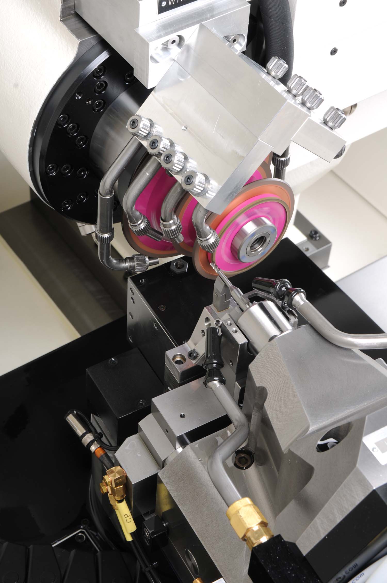

Microscale tool grinding requires extreme patience, attention to detail and a high level of skill. Image courtesy of Mikron Corp. Monroe.
"This is where you separate the men from the boys in terms of manufacturing technology," Negron said. "If you are unable to tightly control runout during machining, the tool will fail right out of the box. And without proper blank preparation when grinding—which means starting with a perfectly round, straight piece of carbide—manufacturing yields fall dramatically, which, in turn, drives up costs and makes tool longevity questionable. Compared to larger tools, where 0.0005" runout isn't going to hurt, you have to control it within millionths for microtools."
The communications coordinator at Rollomatic Inc., Mundelein, Ill., Bjorn Schwarzenbach, agreed that minimizing runout and blank preparation are critical to microtool grinding. He added that controlling deflection is also important.
"When you consider that you're usually starting with a 3mm-dia., or 1⁄8", blank, a relatively large amount of material is removed compared to the finished tool diameter. Therefore, deflection of the wheel and the tool can be pretty severe if left unmanaged," Schwarzenbach said. "In Rollomatic's case, we manage wheel stability with our PerfectArbor system, which compresses the arbor as a means of centering it on the wheel and provides a very rigid connection. For the tool, there's the Nanoset steady rest and U-block workholding system, which work together with the wheel arbor to minimize deflection."

The PerfectArbor system compresses the arbor as a means of centering it on the wheel and provides a very rigid connection. Image courtesy of Rollomatic.
The irony of microtool grinding, Stolmar said, is that small tools take as long to grind as large ones. "You have to go very easy, otherwise you push the little workpiece away. This increases cycle time. The smaller the piece gets, the more complicated life becomes. Any sort of problem with the grinding wheel or tool runout is magnified exponentially."
