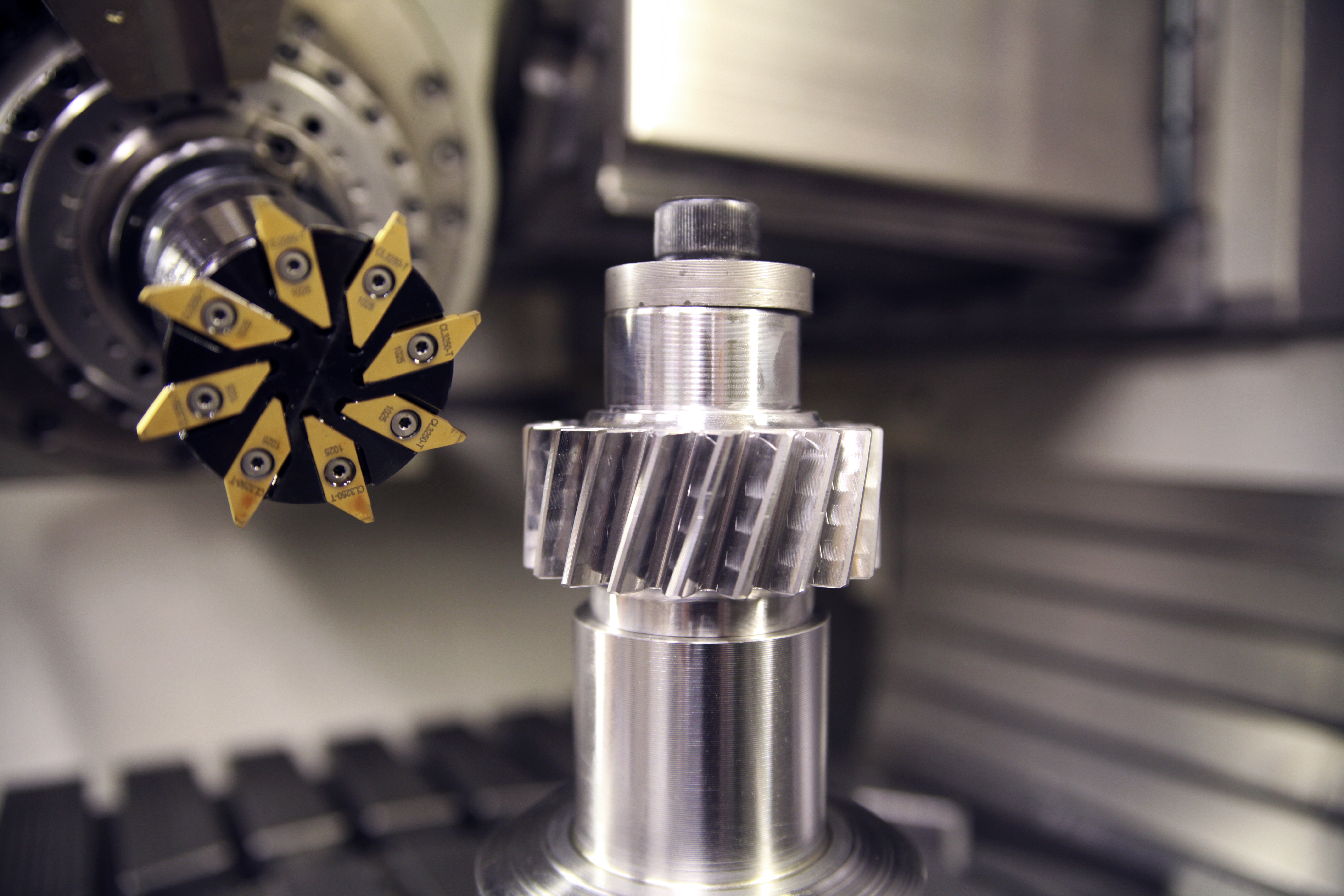

A helical gear machined using InvoMilling. Image courtesy of Sandvik Coromant

SwePart Transmission has significantly shortened lead times for gear wheel prototypes by using InvoMilling, a flexible method for machining external gears and splines on universal 5-axis machines. The method is attractive for small-batch production and when short lead times are crucial. InvoMilling benefits from a machine’s 5-axis capability to produce many different gear profiles with the same set of tools by changing the CNC program using the sophisticated software InvoMilling 1.0.
“With InvoMilling,” Svensson said, “we are able to deliver a prototype to customers in 4 to 5 weeks. Since lead times are often a deciding factor, this is, of course, a competitive advantage.”
InvoMilling was developed by Sandvik Coromant Co. The InvoMilling 1.0 software changes the CNC program to produce different gears with a limited range of standard cutting tools. This capability eliminates the need for a specific tool for each gear profile, enabling machining without having to order a special and wait for it to be delivered. For prototyping, a finished prototype is available in a couple of days or even hours under the right
circumstances.
“When changing to a new gear profile,” Svensson said, “our production engineers change the CNC program, then we can start machining with the standard tools we have. The software is very easy to use. After the short initial training, we can now run it by ourselves.”
